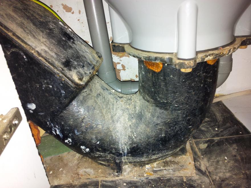

ever seen one of these

It has no brand name on it, no electrical power supply, no blades inside, it doesnt drain untill you pull the tube up as in the last picture
and its massive, that waste pipe underneath is about 110 cast iron, the bulb part takes up a whole cupboard, the plug hole is the majority of the bottom of the sink and its all in a tiny ex local high rise
aint no Waste Disposal Unit i've ever seen
Its not perhaps some kind of centrally powered vacuum waste disposal? Is there any contact number for building maintenance or a facility's manager that might shed some light on it?
Ohh this is a good one we all can have a guess - never seen one BUT
I think its some type of domestic interceptor. Like congealed fat etc
preventing the muck going further down the line and blocking the pipes
Come on dont be shy when you have all finished Subday shopping with ur MRs
have a go Centralheatking
First guess; Dyson's early attempt at a self cleaning vortec sink waste, before he moved on to Vacuums.
Second guess; that's got to be an old commercial unit, acquired for free and fitted in a house.
I'll guess that's the waste section of a waste disposer.
The blade section probably slots in the top of it and plugs into a socket for power or it was totally water powered.
These are called Garchey units I believe. Gone bust now a company called Linbrooks I believe bought up all the remaining stock and the patent so I'm told. There's a few of these about in enfield.
The WINNER;
[DLMURL="http://www.barbicanliving.co.uk/Barbican_estate_design/d11b.html"]Barbican Estate, City of London, for flats and apartments.[/DLMURL]
thats the one, and its just round the corner in Clerkenwell
customer wants it removed because it stinks, but it looks like you cant just cap them
thanks guys, your help is appreciated
You can ambrosia, I've not done this bit spoke to someone that has and apparently you need to get a steel plate to cap the outlet. Then the new sink waste connects to the old Garchey overflow. Can't say that this is 100% but gives you something to look into. It must be capped obviously due to smells and prone to back surges.
Something like a blanking plate used to cap off valves with a rubber gasket? Just need to measure the hole distances,
doesnt capping cause blockage in other parts of the system
what type of cap did he use
No, if you read the estates management info linked to in post 6 (thanks snowhead)
It says you cant cap it as it will cause blow backs in other flats. Give it a read it details the basics of what can be done but it also states you are not getting rid of the smell.
You can cap it off you just can't totally seal it incase of blowback. You cap the main drainage connection leaving an inch tail at other side of trap. Ridiculous set up if you ask me. Would've been great in old days running in cast drainage everywhere. Not
