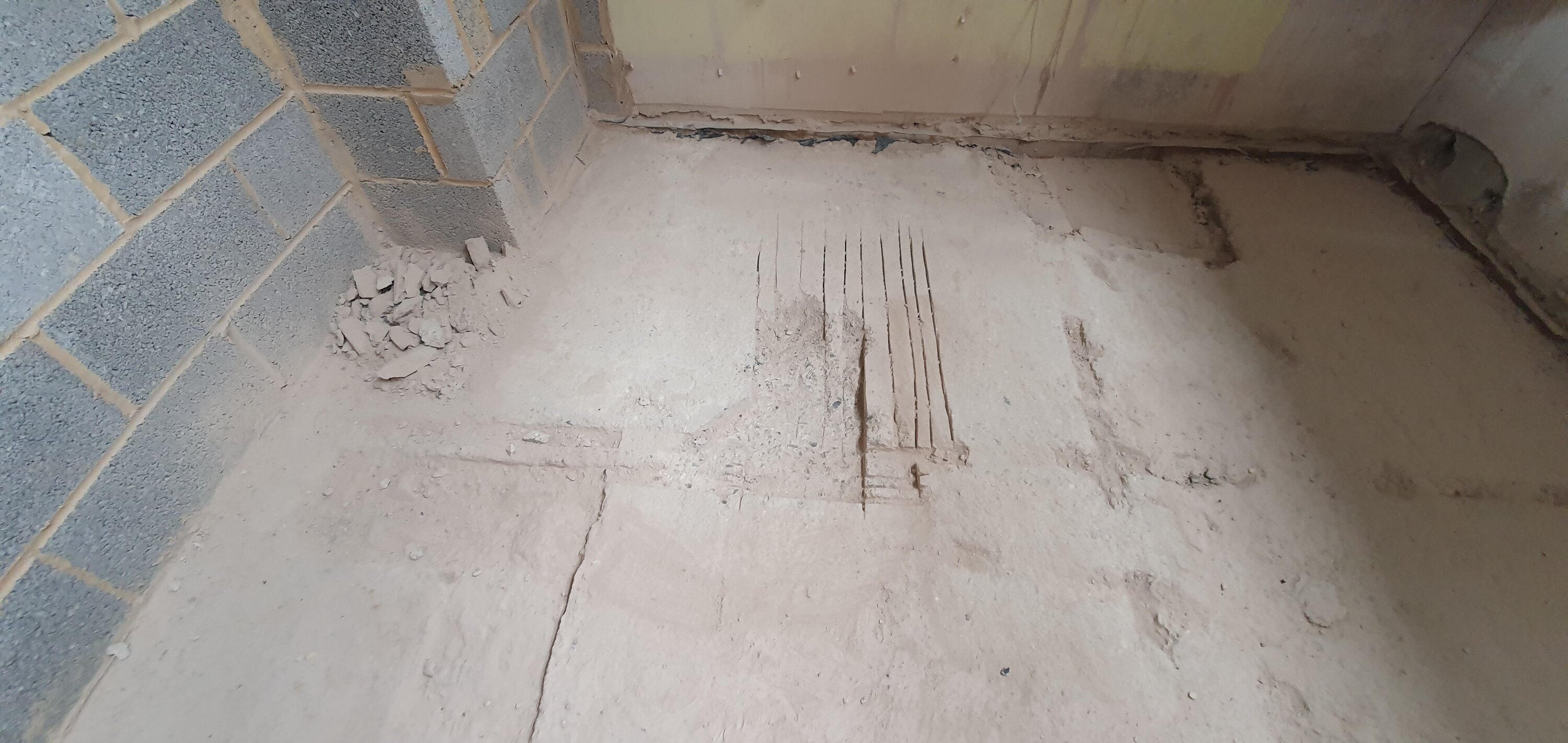

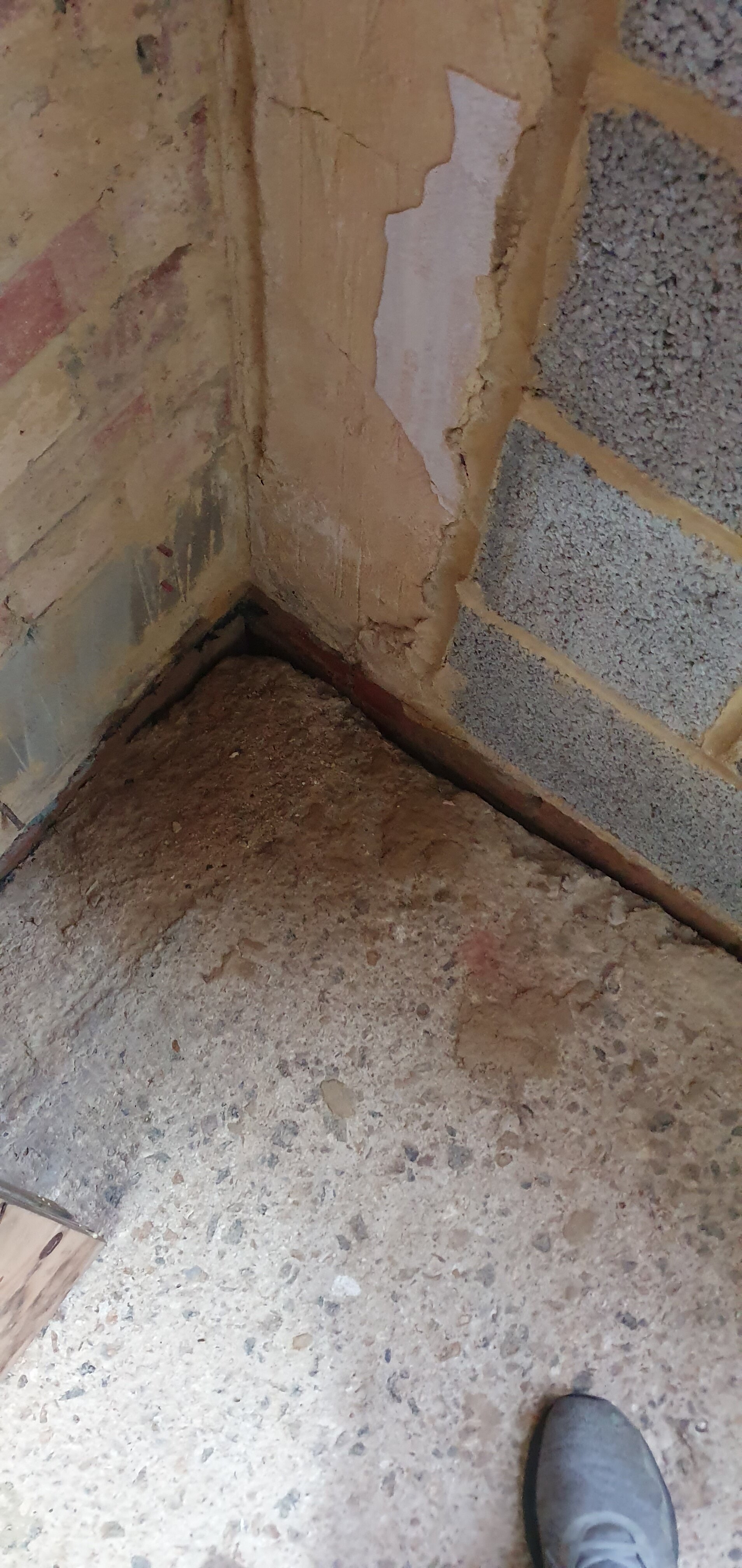

When I took the internal walls down it became apparent that the floor levels throughout the house all differed, and the sand cement screed was laid after the block work walls went up, so I broke up and lifted all the screed to gain 60 mm of depth, the slab had been poured in sections and too was all different heights too, the 2 front rooms had humps in the centre of their slabs.
So i had to decide, bring everything else up to the height of the humps, or knock the humps down to the lower levels, swell it ended up a combination of the 2, Grinding down the 60 yr old concrete as far as I could, and then raising the rest of the floor to give a level smooth sub base

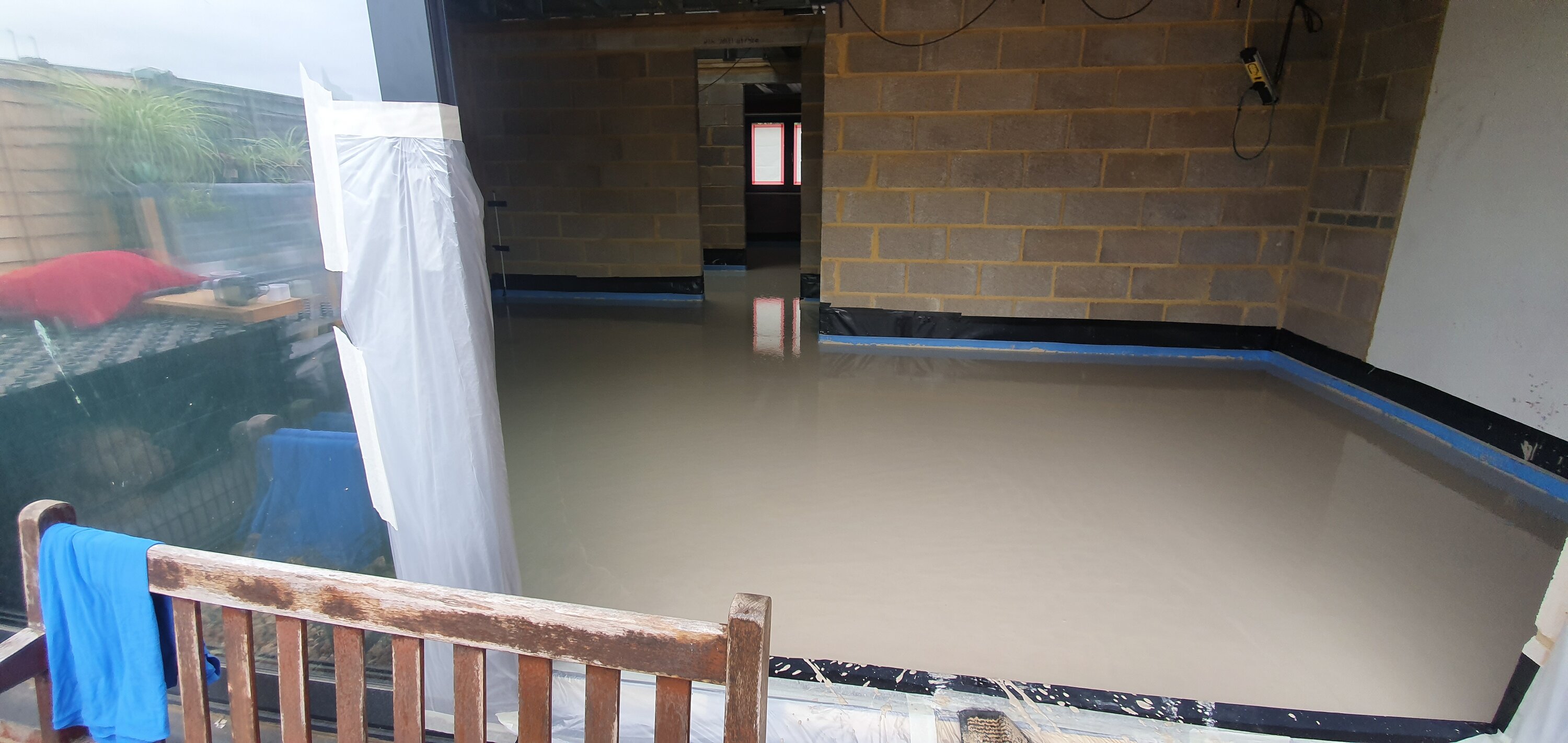

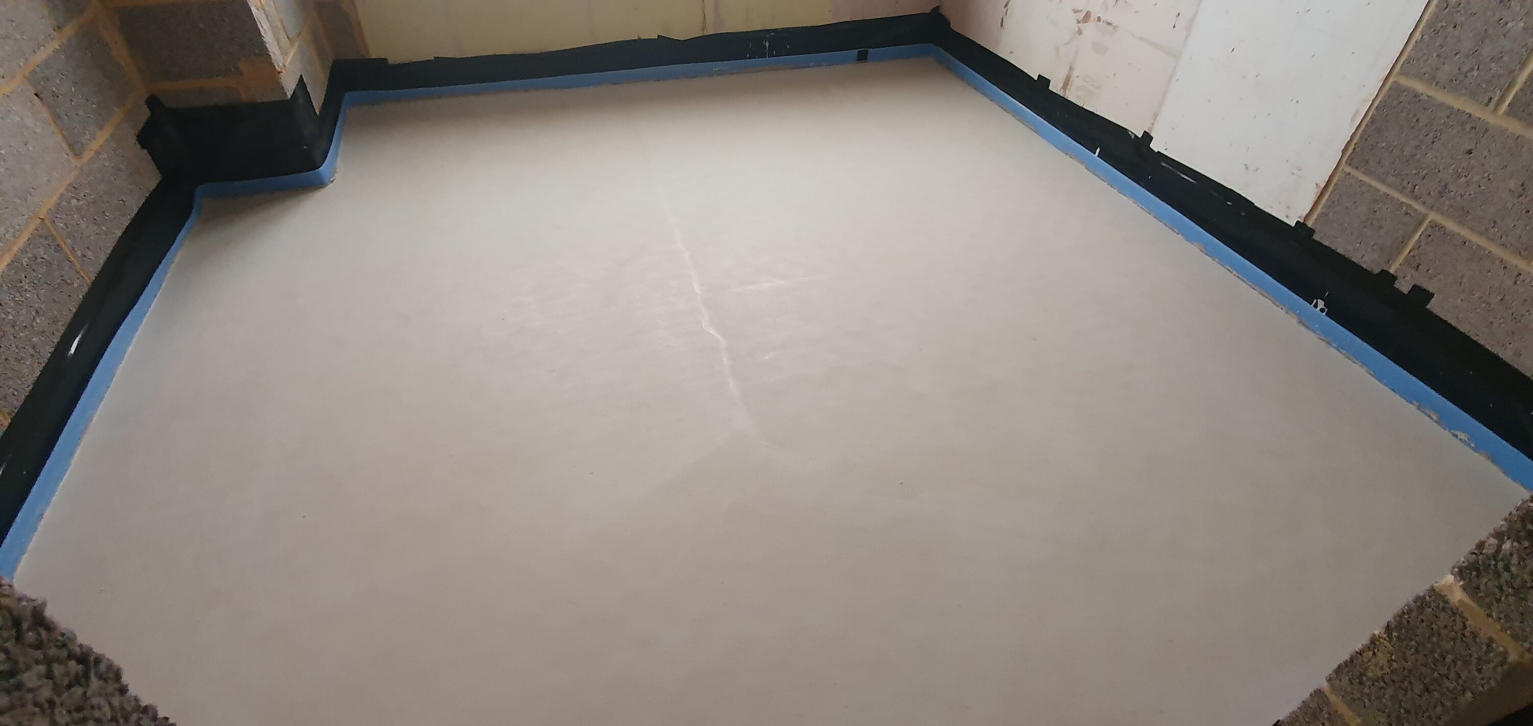

I calculated it needing 80 bags (not all shown on the pallet of screed to bring the level up to a level datum, it got poured in sections, 80 bags in one go with 2 people was too ambitious! I asked advice a from the big screed manufacturers, if there was a way to slow the pot-life of the screed, they all just came back with no. But Larsen actually gave me a call and 40 minutes of their time from a really knowledgeable and helpful technical manager, without this help i would have ended up in a right mess.
here is where I learned that the slab needed to be primed too!

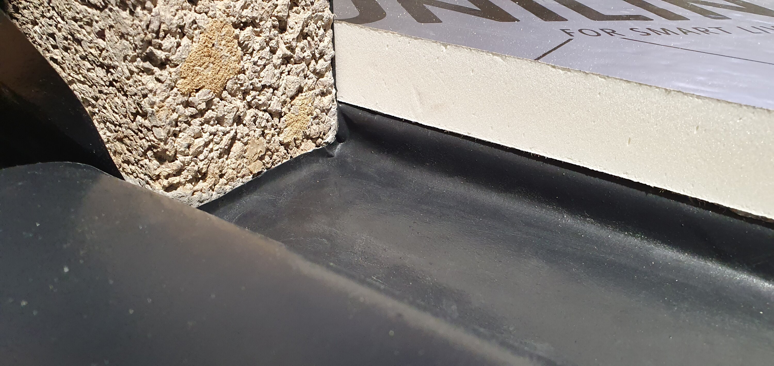

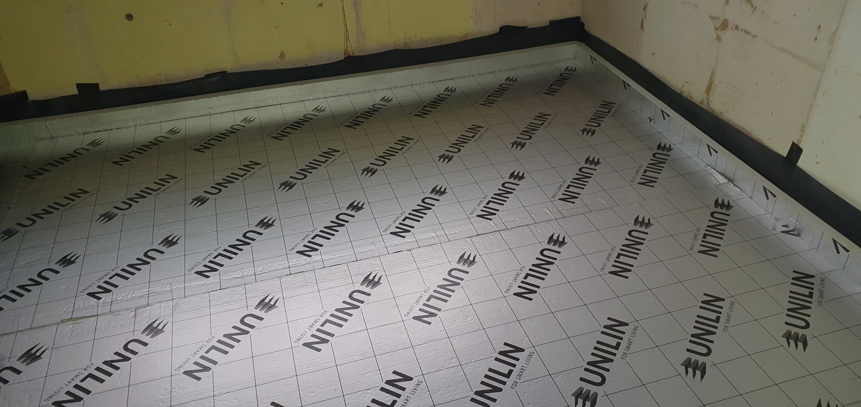

once I had a single level throughout the ground floor I added DPM to tank the floor, once you get the corner folds sorted its pretty easy, and The DPM tape is really sticky and dresses the corners nicely
and laid insulation - its worth noting that PIR from different manufacturers have different compressive strengths (probably all suitable for floors but I found Unilin was the strongest in compression - I only had enough ceiling height (despite raising the ceilings) to fit 60mm PIR - though having calculated the U value this still met Building regs (its not one size fits all and depends on lots of things the project size, percentage of floor affected, P/A ratio and other things
I saw some shocking installs when researching so aimed to do things right. so the boards were fitted with a Board and Club hammer - they are a tight fit, No Gaps whatsoever, and the board joints then overtaped with foil tape.

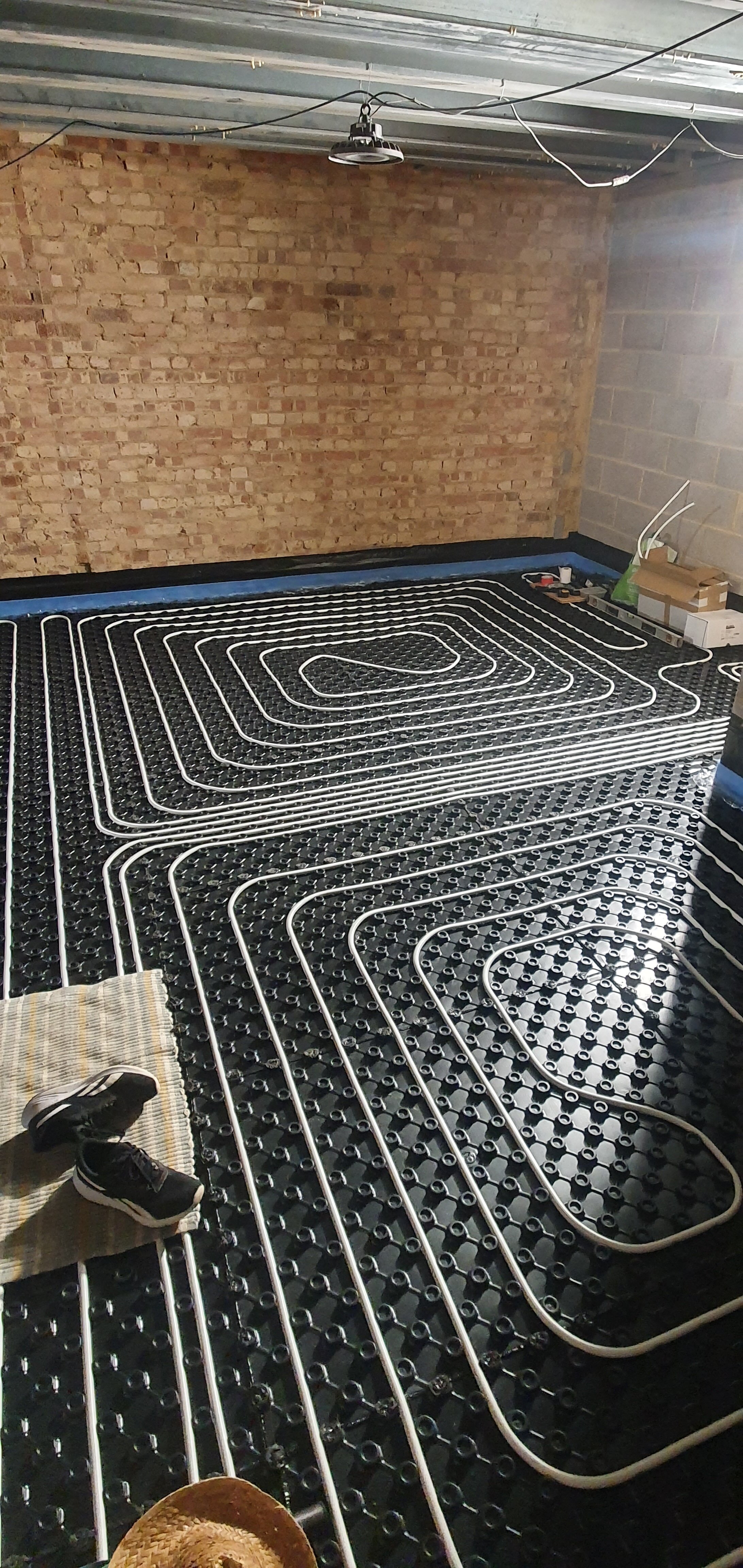

I designed the loops using loopcad. Intially I opted for serpentine pattern, but didn't get on with the 150mm spacing u turns at the end of each run, using pex al pex, I struggled to get that tight of a 180 degree turn on the ends, so quickly redesigned using a concentric pattern (Im actually happier with this having a feed running parallel to a return, to harmonise the floor temperature)
Fitting the castellated panels was a pig, i tried overlapping them by 2 turrets but they needed smashing together with a hammer and split, I spent ages trying to get them to tesselate, (by this stage I had been working til 4am for a few weeks so wasn't thinking at my best and in the end could only do so by overlapping the half turret on the edge, but this left the edges pretty unsealed. I had read that the screed would react with the foil face of the PIR and float the panels up if it got underneath, so tried taping all the joints but this was unsuccessful, eventually sealing all the joints with a hybrid sealer / adhesive. This is a job i do not recommmend tracing the profile of the panels along up the turret into the dip of the turret, down the other side and on to the next turret, Thousand of times. It genuinely took 20hrs +. it has since occurred to me (and i checked it on a spare panel) that if i has staggered the panels a few castellations they would have pushed together tightly and could have sealed enough! I dont have too many pictures of the panels going down.... i call it the dark times! 🙄
Eventually it all came together and the manifold connected up, and with a cheap pressure pump the system went under test at 6 bar, and all was good, be aware that when you put the system on test at 1am, by midday the next day the pressure will be off the clock it raised something like 1 bar with every 5 degrees of ambient temperature
I opted to get a screeder in for the final pour it wasn't practical to try and pour this myself. i opted for A gypsum Anhydrous screed budget and drying times great product and service, though the laitence needed sanding but the screeders sorted that, though i wasn't aware that this then needed a primer to be able to use a cementitious adhesive to lay ditra mat before Laying tiles, so some extra work and cost there!
It looked great once screeded and it was good to have a floor back!
