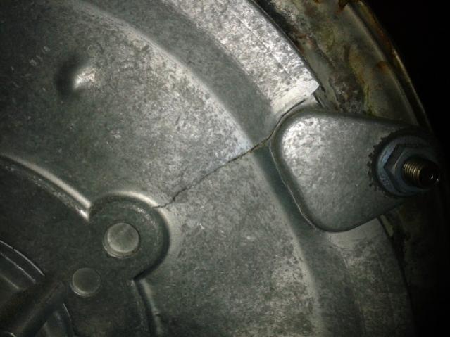

You mean like this burner i went to today hope the pics come on first time with pics
You mean like this burner i went to today hope the pics come on first time with pics[/QUOTE
exactly what I was thinking when I wrote it. Had 3 gworms do that now. Worst one was the customer kept resetting it for months so by the time I got there everything had melted. New wiring harness combustion chamber, the lot.
Everything melted inside cracked and distorted burner insulation melted cables all melted how farb do you go
