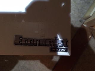

From your description you have a system boiler, Boiler over pressurising would not be due to pump, does pump feel very hot ?? or is it spinning and nothing moving, if the latter then impeller is not spinning, and you have a faulty pump out of interest what make/model boiler do you have ? do you have a hot water tank ? what other controls on system ? Photos if possible.
Jts - I'll take some photos this evening. The pump is very warm to the touch. I have a hot water tank.
