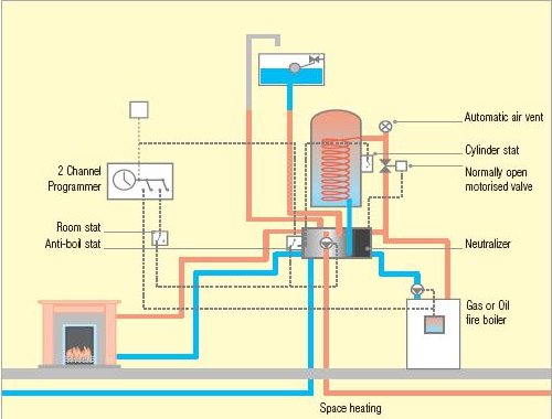

I'm renovating an old house, it had a back boiler heating a DHW tank in the loft, direct. I replaced it with an (uncontrolled) stove and a proper lagged indirect coil tank, with a seperate feed and expansion tank.
Now I've also put in a pumped radiator circuit and planned to connect this to the existing gravity circuit using one of those "dunsley neutraliser" header boxes. With a thermostat so that the return to the stove has to be hot before the radiators start, simple stuff.
OK so far?
Then I discovered I actually have mains gas (doh!) so now want to put in a boiler. I picked up a second hand glow-worm 18 HX (for vented systems) on ebay.
I think I can connect this to the dunsley header with its own pump, partial injection to the tank coil, to get heating and hot water from either source.
And I want the boiler to go in the loft, ideally.
But I'm having a bit of a crisis of confidence. Can anyone tell me if what I'm wanting to do sounds reasonable, and legal!? I'm aware it's perhaps not ideal but I need to work with what I've got now.
As I will be needing the boiler connected and commissioned I'll be paying a plumber to do that anyway but am a bit afraid they won't like the water side of it and say it all needs ripping out and doing another way.
Are there any regulations I need to be looking at for all this too?

Thanks for the advice, could you explain what's wrong with it though? It would be identical to various schematics I've seen and even an installed system, apart from the boiler in the loft bit.

We have had a number of threads recently, relating to linking solid fuel to other heat sources. This is a complex task and requires much technical knowledge and expertises to get safe and right. Solid fuel appliances are a relatively uncontrolable heat source (onces lit, you can only damp down, it won't turn off) Therefore you are required to seperate your heat sources through something like a thermal store. I would not advice anyone to do this work unless they are fully up to date in training and qualifications. There are a number of HETAS approved courses runing at this time, which cover what you are proposing.
Reg, you're right, and I'm aware there are hazards. I am an engineer.
That's one of the reasons I wanted to keep it a simple open-vent system, which I know and understand!
My idea for expanding it actually came from this diagram:
(taken from solidfuel.co.uk)
And I can't see what's all that wrong with it. You get "s-plan" style control using the motorised valve and the CH pump, and the solid fuel appliance will gravity feed to the cylinder just as it does now (whether there is power or not), but with the added safety feature of an anti-boil stat turning on the CH pump if it gets too hot.
I know the devil is in the details but the comments so far have been "you can't do it like that!". I just want to get some sensible advice and facts before I involve a local plumber.
Anyway, thanks, I hope I'm not p*ssing everyone off bringing this up..
