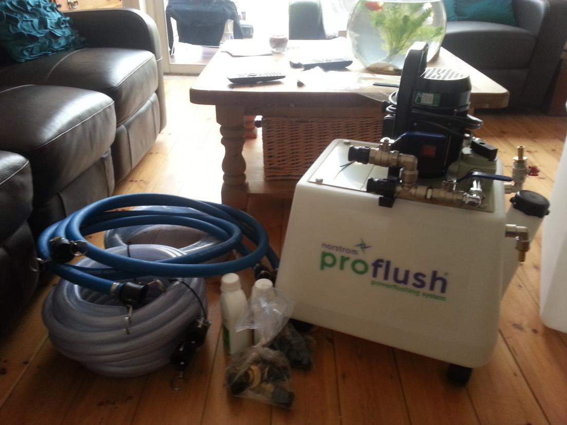

wow that is a result, it wasn't long ago that you were trying to sell that flusher machine. you must be chuffed
