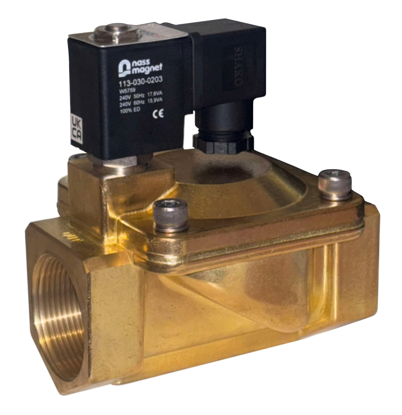

another option is to buy the body eg 1” solenoid
and buy a 24vac head with the correct shaft dia
