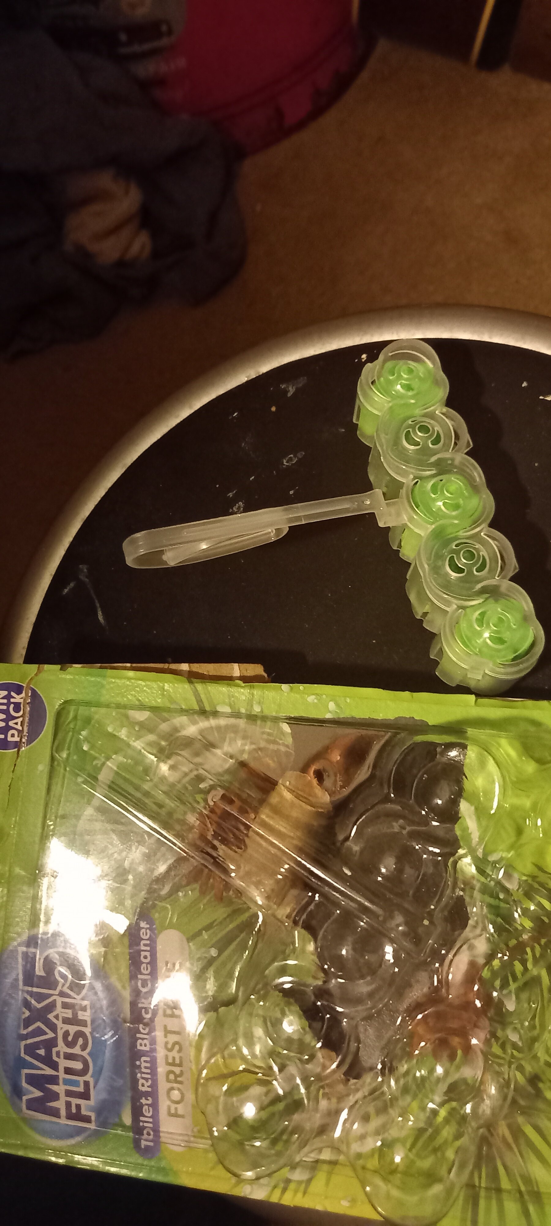

View the thread, titled "I have a toilet rim plastic disinfectant holder stuck in the u bend ..should i buy a toilet plunger or a toilet snake auger ...?" which is posted in UK Plumbers Forums on UK Plumbers Forums.
Don't plunge it, it needs to be pulled back out the bend, otherwise you'll have a blockage further down.
And throw the rest of those away.
If you have wire coat hanger or other similar piece of wire, make a hook on the end and try and hook and pull the block back.
Thanks for your reply ..looking for a wire coat hanger out of 50 and not one!! they are all plastic now ..i am wondering whether to buy a roll of this for £3 ...its plastic coated but it depends if i can make some sort of a hook ....if that fails then i will try this £24 from amazon ,note it has a claw like grip fitment on the end that you operate with the gun trigger ...failing that then ill have to call out a plumber ...
