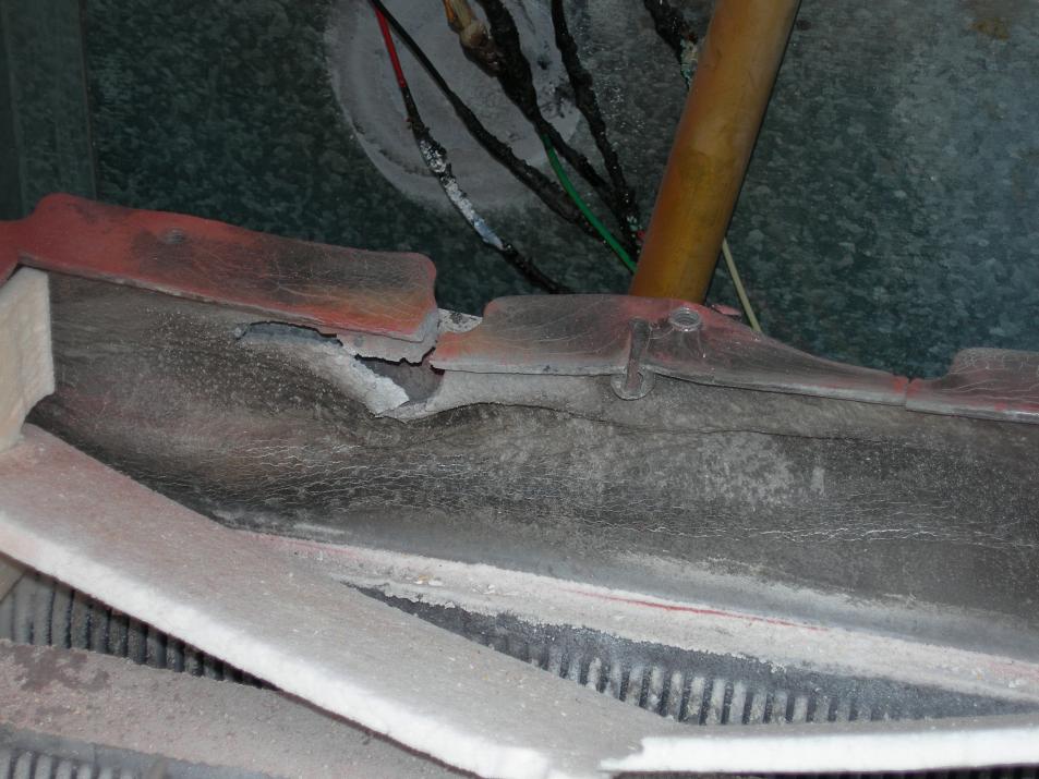

Got called out to an ideal Icos yesterday. The couple had only moved in a week or so ago and they said the boiler was making a loud poping noise. So I opened it up to have a look inside & I found a right old mess. Still get to install a new boiler.
insulation panels fallen on the burner its held in by the ionization probes which have failed,and diverted the flame trough the back wall of the boiler

I am afraid to say its not down to a boiler fault, this boiler has not been serviced inline with manufacturers instructions. The Icos should be serviced every 12 months and the burner earth pins sould be checked to make sure they can make it through until the next service. If they can't they should be changed.
This boiler has simply not had the burner head removed and these items checked or replaced, as has been said the insulation panels collapse and the hex ends up being burnt through. Easy enough fix 3hrs and a new hex and serviced correctly in future rather than a quick £40 telegan check in 15 mins. As a former Ideal engineer I am speaking from experience look out for the m-series Isar and Isar in general. Make sure you catch your telegan early other wise on a hex like in the picture you will kill it quickly if you leave it in the flue outside while inside with the boiler. The Isar is without doubt a boiler that needs specific attention but the Icos is a good boiler as the pcb does not have the demands upon it like the isar combi does. Also factor in the fact the icos in generally generating less kw heat so its under less stress I.E 18kw Icos vs 35kw Isar.
A lot of all boiler releated issues could be avoided by flueing the boiler correctly as instructed, make sure the condensate gets away quickly, making sure the pre-electrical checks are correct and the boiler has the correct gas supply. In this case poor servicing by an engineer/engineers not to manufacturers specs resulted in the boiler failure, not a low quality boiler

ideal =nightmare =axe end off argument,but i do agree if its serviced properly then this fault should not happen,on the other hand ideal posted this issue up as a tb in the old corgi mag,its a weak design,and alot of the parts on the icos/isar are IMHO
