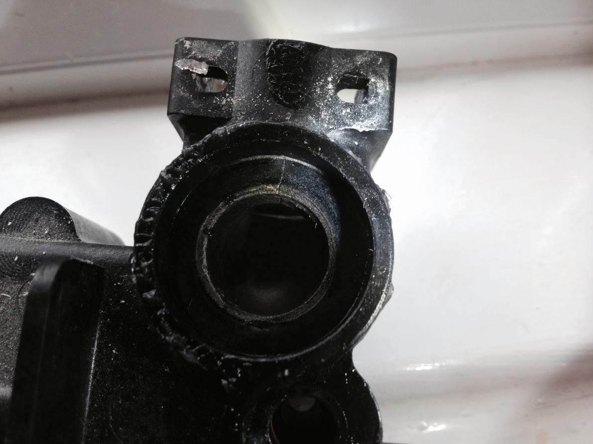

Was out to an isar he24 a couple of days ago after it leaked (lots) from what I thought was the plate lip seals.
Went back yesterday with a washer kit and replaced all 4 lip seals and then noticed the hot pipe O ring was weeping so changed that as well. All was good or so I thought.
Just got a call tonight to say it is leaking out of the same part again. Can't quite explain it, only thing I can think of is replacing the copper hot pipe which comes out the block and onto the jig or worst case scenario the block itself.
Anyone had this problem before?

Just seem strange, replaced the o ring and all looked good, nothing forced. I always take my time to clean up the fittings, grease and refit carefully.
Can only think there is a score mark on the copper or something?
What's the mains pressure like had a raven heat push it's o rings out last month after being in 3 years with no problems. 6 bar mains warped the plate just enough to let the oring slip
Scuffed copper or scale pushing seal out of shape. When I go look a subby repairs it's dry, o ring chafed and leaking. It's usually wb DHW turbine !

I've replaced a couple of the flow manifolds because of similar issues. had one would only leak when the outlet water was cold! Found hairline split in the plastic!
There not to bad to replace as long as the screws underneath haven't rusted up!! 🙂
Cheers diamond, was hoping it wouldn't come to that but sounds the likely answer.
If you're going to pull it all to bits again you might as well change the manifold Nostrum. I remember another one was spraying a fine jet against the back wall! It'd worn quite a hole in the plasterboard before the custard noticed their kitchen bench swelling up! 🙂
Top marks to Diamond Gas cheers mate.
Picked up the hydro block today and when I found out it was £80 + vat for a block of retarded plastic, I added a tube of LSX to my ticket as well.
Got there and the leak was very small but coming out of the O ring to hot outlet copper pipe at the back.
Chanced my luck with some LSX and PTFE etc but it carried on leaking. Anyway bit the bullet and whipped out the block which wasn't to much of a headache and low and behold a hairline crack. It runs between the hex lip seal and the o ring opening on the back. Funnily enough replacing the lip seals last time seemed to have stemmed the leak.

Cheers again Diamond, starting this thread saved me another 1hr round trip by going prepared.
the beauty of this website is that we can share our own experiences as an when! I'm glad that what I've experienced and shared here has proven fruitful for yourself Nostrum.
Fixed exact same fault today ending up changing hydro block, be carefull there are two o rings that fit its the smaller one as I found out today.
