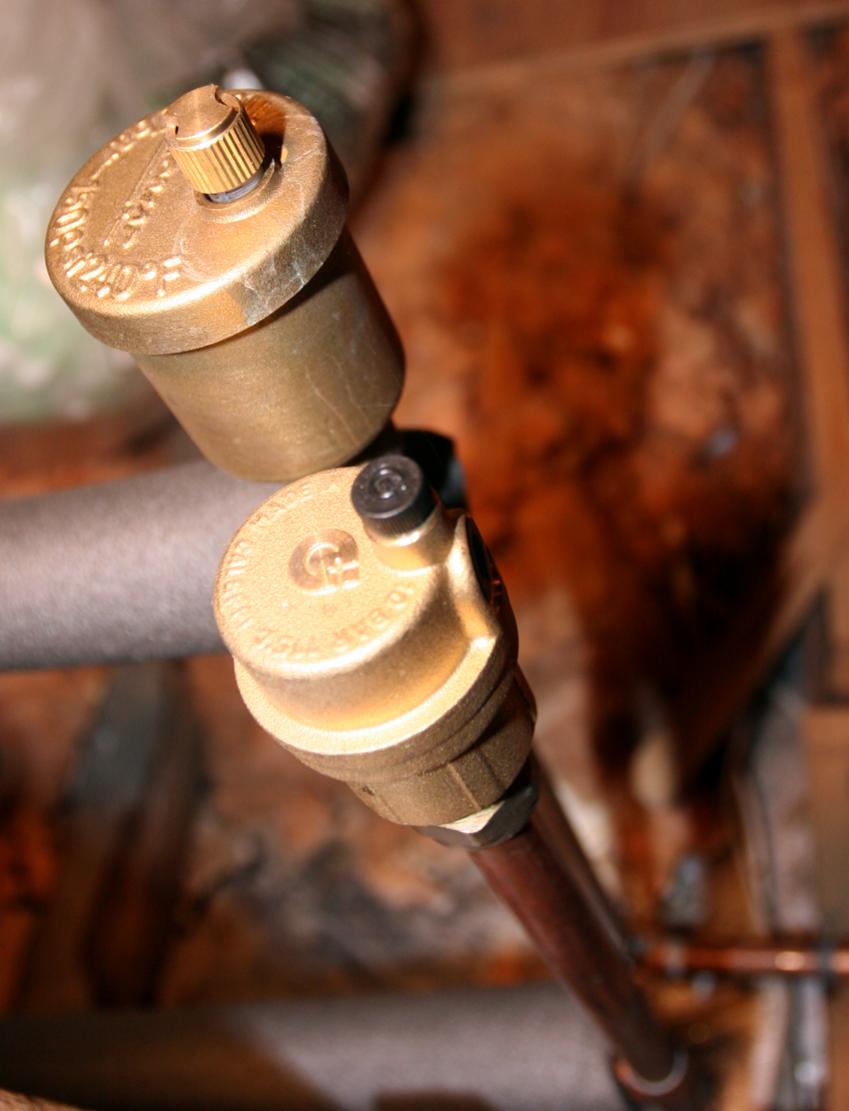

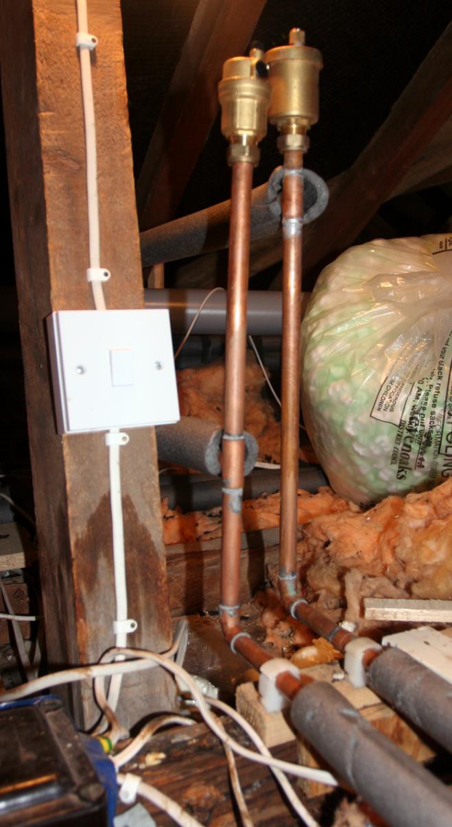

take a picture of the suspected suspects and we can confirm to you if they are AAVs or not.

Hello, Going to try to add a couple of photos to this. It's all a bit new to me, so hope it works. One is a close up (although I couldn't get the markings to come out clearly without standing at such a dangerous angle that falling through the roof hatch was an option!), the other is showing the vertical pipes. I hope they are good enough to confirm that they are indeed AAVs! Will keep a leak sealer in mind too. Thanks for keeping in touch.
Sorry, no good I am afraid. I was stuck with a URL link and hadn't a clue what to do! I have the photos in Photoshop, but am stuck from there on...... Really sorry I haven't tried to upload a photo before. I will do some research and see if I can get more succcess.
Having another go with the pics! Hope this works.

Hello, yes those are AAVs. You could try closing the vent guards (by turning the small screws on the top clockwise) as this may slow or stop the water escaping. It will also stop the vents working, so you'll still need to get the system attended to for a permanent fix.
Hello, if I close the vents as you suggest, won't that be the same as having manual vents put in? Are you saying that there is likely to be another underlying problem with the system which is causing the air and water to escape? If that is the case, putting in manual vents won't solve the problem, but I will be back to square one, not knowing how to get the system checked out for faults. I can get the boiler looked at by any number of people and I can get plumbers to come out and fix things that have gone wrong, but no one seems interested in 'checking the system' to find a fault. Who should I be asking for? A plumber, a heating engineer......

there wont be anything wrong with your boiler, it is only a pressure loss problem, the boiler needs pressure in it to operate. Is there water coming from the AAVs ? are you sure it is them that are leaking ? if its them thats leaking then that is your problem.
I have seen the occasional bead of water sitting beside one of the AAVs and the timbers in the roof which are getting wet are directly underneath these AAVs. I have checked all the pipes around them and can't see a leak anywhere else. Would it make sense to loosely wrap some kitchen roll round the valves and tie a poly bag round the outside (with some perforations for air to escape) and then check every few hours to see if the paper is getting wet?

If the plumber you got didn't check to see where the water was coming from he a joke don't get him back the pics show the water been leaking for a while wood soaked
