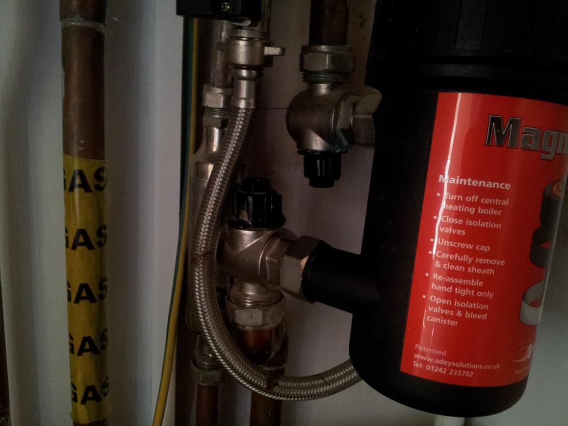

Attached above is a picture of my magnatec installation. Yesterday, my plumber popped over to do the service on the boiler he fitted two years ago complete with this unit and all pipework. After the boiler was service I asked if he had cleaned the Magnaclean. He said no because when he tightened the isolating valves and opened the unit, water started gushing. He said the isolating valves had essentially broken down and needed replacing, and that would only happen when the system was drained. I asked him why something should break down in two years and he replied that due to heat expansion and contraction things with plastic essentially wear down and seals get broken. (He seemed to be saying that quite a bit including for plastic push fit fittings and flow connector pipes inside boilers but thats another post). I asked him if the isolating valves were of inferior quality and he said no, these are the best you get and if they were replaced then the new set would / could also break down in two years. His philosophy is nothing lasts forever.
Now, for my point of view that's a great business to be in if whatever you install will break through no fault of your own but is he saying as it is? Surely there is an opportunity therefore for a isolating valve manufacturer to make something that lasts for more then two years?
Cheers all
Hiro
His philosophy is right,but i would expect more than 2 years life from isolation valves

Have you asked him to put things right?
If it was supplied by him as part of the installation, then it should be covered by the Sale of Goods Act 1979 - his personal philosophy is another matter.
The valves should obviously last longer than two years, it's ridiculous to suggest otherwise.
If it was me, I would get rid of the piece of junk, and get a Tf1 fitted.
Unscrew the plastic cover from the isolating valves and use a small adjustable spanner to isolate the valves.

Balls! The idiot didn't close valves properly and they were weeping slightly.
Turn them off then open vent with a rad bleed key. Move the vale 0plus or minus 5% until water stops. Had stupid complaints like this before! Get there and manage to isolate And clean unit in a few seconds. Dimwits just cannot be bothered and simply blame the filter. The new pro 2 are better but if your are actually having an issue contact adey - they orobs send you a replacement FOC .

As Ermintrude said, it sounds like he did not turn the valves off correctly! I have yet to have the black valves not shut off, the main fault with the magnacleans were the poor red iso valves that leaked if you turned them and the faulty leaking lids (they surplied kits to BG as a rework). The only problem with the black iso valves is you can get a leak from the joint into the valve on the peice that connects to the filter, when you tighten that joint it can loosen the manufacture made joint inside the valve!

Your entitled to your opinion. I prefer the magnacleans my self and have not normaly had any trouble with the issolater valves. Im inclined to agree with ermi and the other posters that suggested the plumber may not have completely closed the valves or didnt try to close them.
