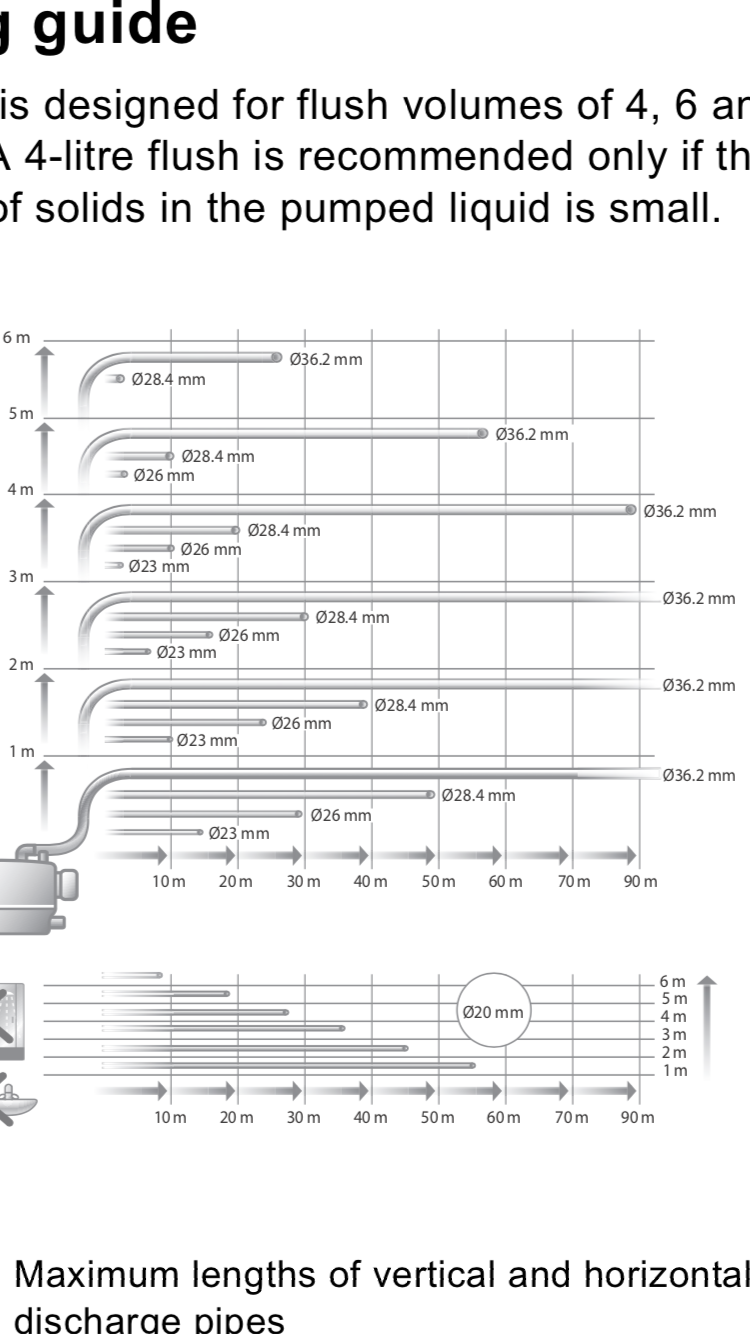

They can pump vertically and horizontal for a fair distance, but they are designed for straight runs , with minimum bends ( pull any bends ) etc not elbows going everywhere. If you install it use 22 mm copper not overflow pipe, I run a mile if I see plastic.

Does it not have to be 1 1/4" solvent for the discharge?

I am no sani expert but 1 1/4 to the sani , but I have always used 22mm copper from the sani to the soil pipe , would never risk plastic on that . Just use a strap on boss on to the soil pipe , biggest problem is the run to the soil pipe.

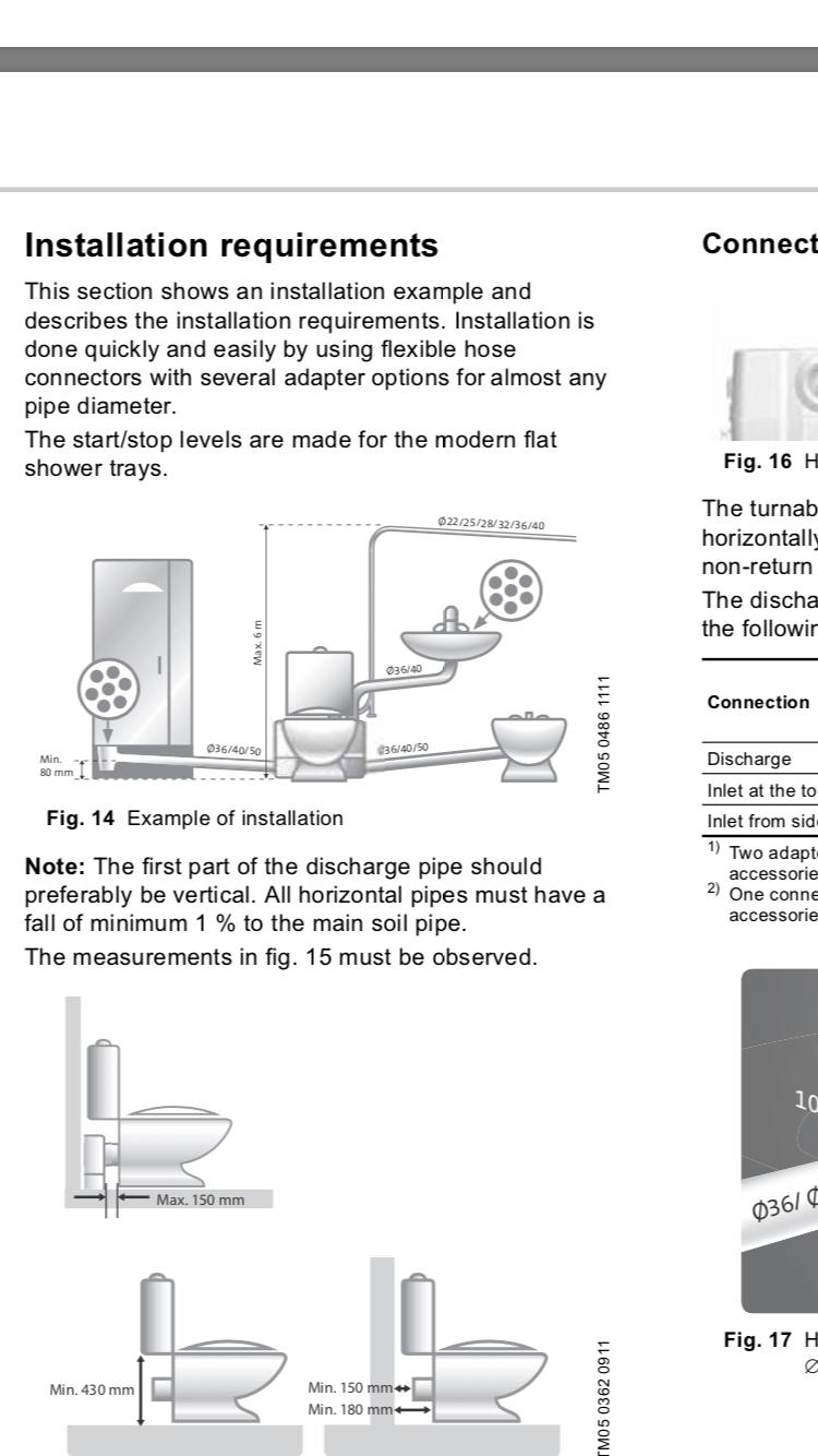

I've been looking at using the Grundfos Sololift3 and it states the horizontal pipe should fall by 1%. So over a 6metre run it only needs to fall 60mm, which doesn't seem a lot to me at all.

I was just surprised with the 1% fall. I know it's pumped but a 10mm fall for every metre seems like it just isn't enough.
The fall is fine, just follow the MI and it'll be fine. The system is pumped so between the slight fall and the pump it works well. The fall is more of just an assist to the pumping and to stop liquid from collecting at any low point.
Ok thanks. Do you know why they state that the discharge has to rise first? Is it just to assist the fall?
Please supply a link to this 1% fall.
I was told about the 1% fall by Grundfos Technical but they also emailed me an installation manual.

1% fall is the minimum not the recommended and needs enlargement after a certain distance
