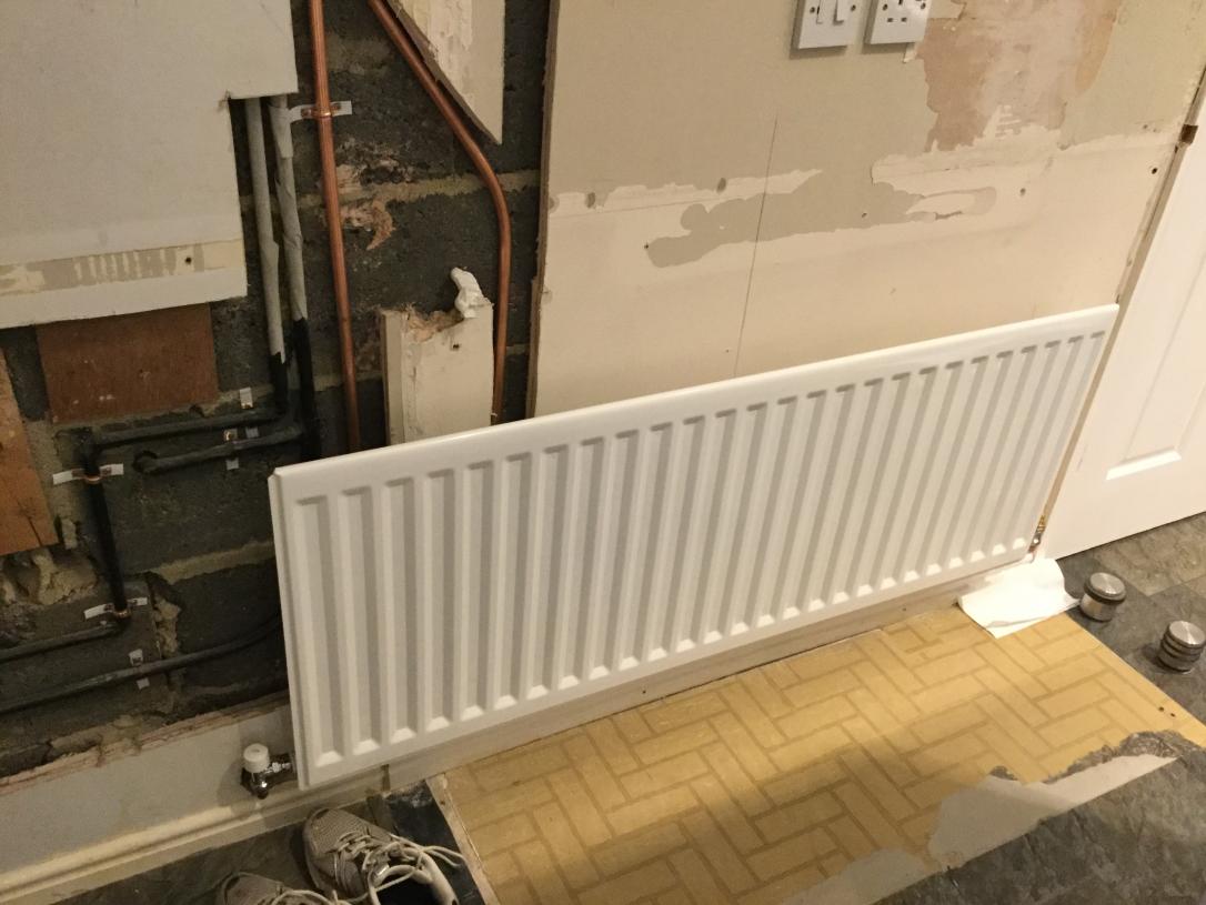

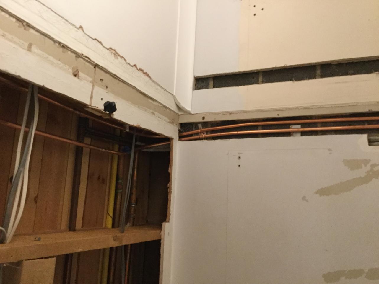

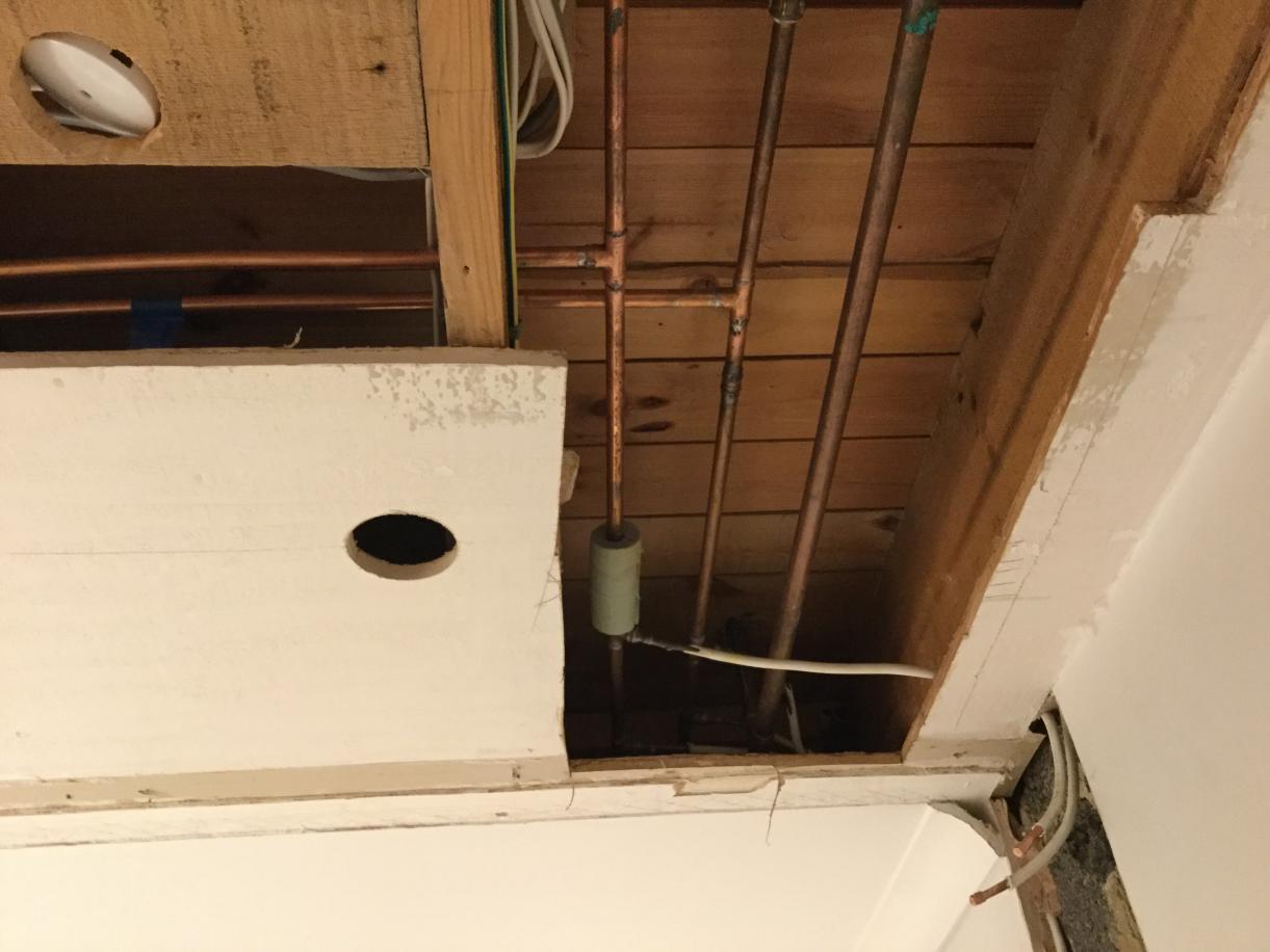

Here are some photographs of the joints
Pic 1 shows connection to the existing supply and return pipework and redundant 8mm drops
Pic 2 shows pipeworgpk through joists and the drop down the wall
Pic 3 shows the drop down to the radiator.
Pic 3 shows the drops down to the radiator left being supply and right is return.
