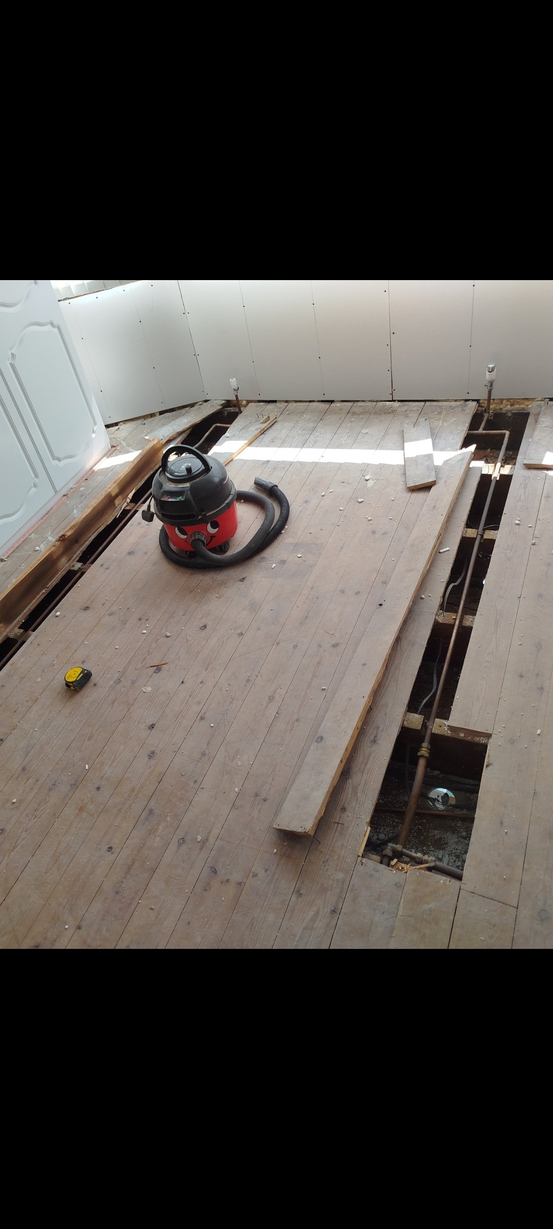

Been to look at a job, somebody has bought houses wanted a radiator capping off and a radiator moving. System is on a combi. Is an old one pipe system though. With the pipe runs etc I have advised repiping to a 2 pipe system. Pipes come in upstairs then drop down. 3 rads downstairs 4 up. Downstairs radiators pipe work in void underfloor boards. Cutting back on these tees on 22mm and converting to a 2 pipe system. Well I have advised repiping to a 2 pipe system everyone else suggest that's the right call.

Thanks it's a house someone has bought. With the stage there at now I have recommended changing/repiping to a 2 pipe system. It's on a combi a moment a 2 year old gloworm
It also looks like the pipes still go to the old back boiler. On the one pipe circuit even thought the system is on a combi.

It's like the flow and return, is a loop one pipe system is still flowing through the old not in use back boiler. The 15mm that drops down is the main loop for the one pipe circuit still
