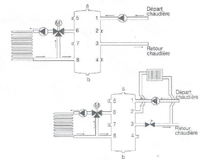

These are the diagrams supplied by Thermador with the buffer tank, as you will see my sytem diagram is very similar the only notable differences bein the location of the pump and the addition of the loading valve (themovar) which opens at 55 degC.

How would you set the two balance valves?
The factory setting is speed 3. Once the pump was unblocked there was clearly too much around the thermovar bypass. The boiler tapping is about an inch from the top and the air bleed is fitted to the tapping rather than the top of the boiler so the pump suction was causing a lot of noise in the top of the boiler. I turned the balance valve down until all went quiet. The other vlave balances the flow through the tank with the flow through the rads. . At the moment it is fully open but I'm concerned that all this flow through the tank will reduce the temperature differential across the tank. As yet I've not been able to run the system long enough for the tank to reach its full temperature. I'm inclined to back it down a bit before I start but before I do that I'll make sure that at least one of the rads remains open.
if you run the return directly from the buffer to the mixer valve then the buffer should heat up fully. your heating circuit is taking the heat out of the buffer and it cant reheat as it has to go through the radiators to create a circuit. Also i wouldnt have the expansion vessel on the flow or shunt circuit, the diaphragms are not designed to take a constant heat over 70 degrees and will fail.
