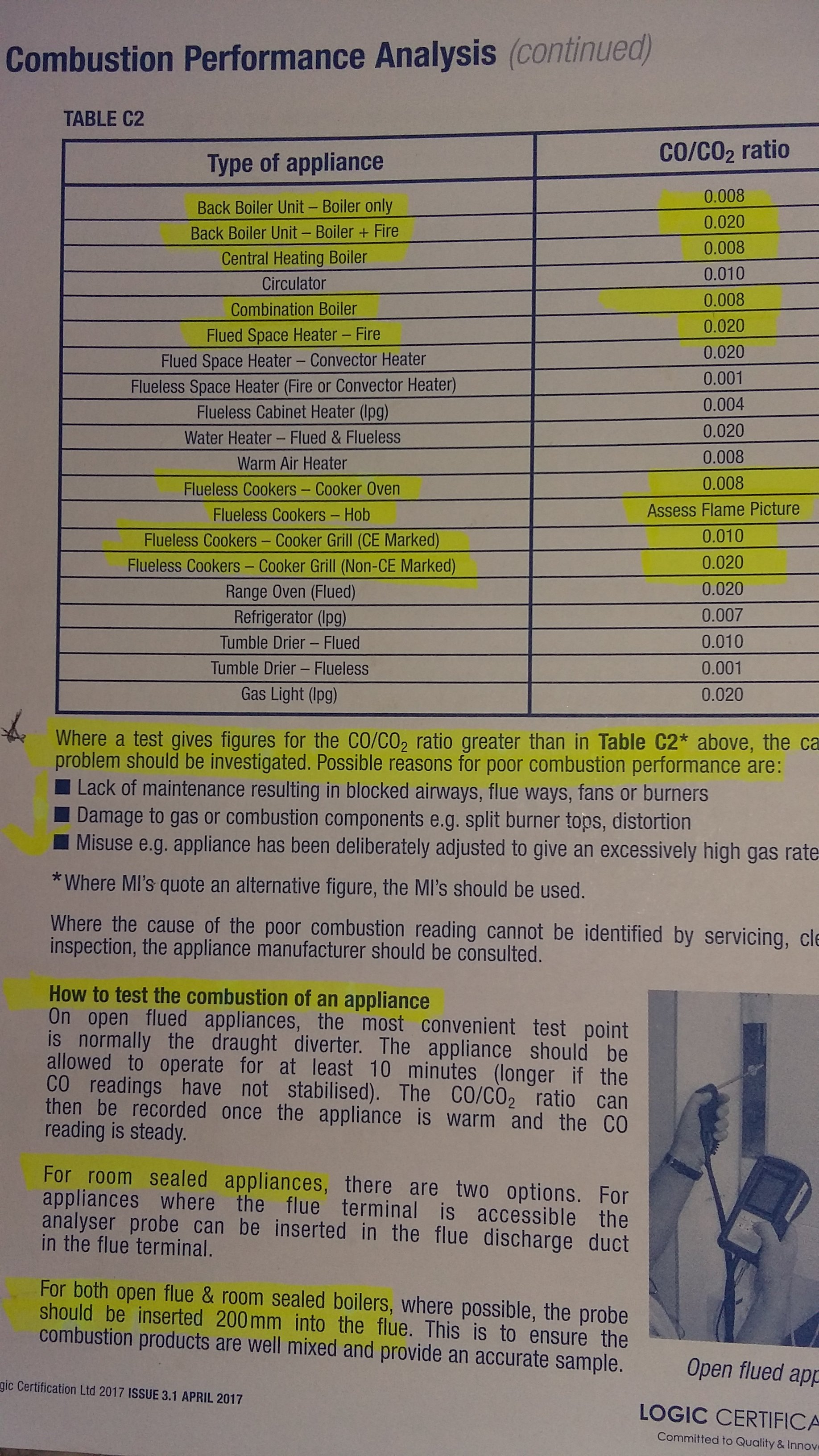

I was under the impression you could check the co2 ppm if you have a dirty flame. What good is the ratio to us on a fluless appliance.
You can test the ratio on a flueless fire. There is a tolerable level as with boilers
They have tolerances for ovens and grills as well as far as I’m aware , 0.008 for ovens and 0.010 for cooker grills providing they hold a ce mark and as Riley said flueless fires 0.001
I always take a POC Analysis Test on cookers/grills/ovens where possible. I've attached readings that are expected.
