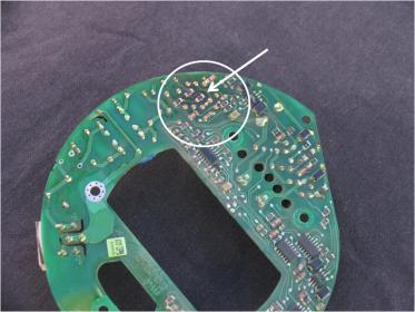

I Proceeded to dismantle the boiler to take a closer look at the fan where I consider the fault most likely to lie. One thing I noticed after removing the inner door panel on the steel base below the fan was a very small amount of a sooty black deposit as if produced by electrical over-heating in the vicinity of the fan.
I then proceeded to remove the fan and pcb to inspect this in more detail and noticed one area of the pcb that seemed to show signs of overheating. There was some blackening on both sides in the region of the rectifier, voltage regulator and the three resistors indicated on the figures below. The overheating didn’t look particularly serious, there was no damage to solder joints in the area and I realise that that regulated power supply circuits often run warm. In addition, none of the electrolytic capacitors nearby showed any signs of stress. However, this part of the circuit is obviously running pretty hot during normal use of the boiler. Over time I guess this could result in fluctuations in the regulated supply delivered to the remainder of the fan circuit and possibly long term changes in the voltage level.
I have had a bit of a hunt around for info. regarding testing of the fan pcb but could not find too much relevant material. A circuit diagram would be a big help or a few tips on basic tests. However, I am not sure this is necessarily the cause of the problem.
This is because I after reassembling the fan and boiler the E160 error seems to have disappeared, at least temporarily. This makes me think it could just have been a connection issue and simply remounting the connector blocks and fan-pcb to fan -motor connections may have solved the problem. However, any feedback from people who have noticed a similar progressive development of an E160 and the associated changes to the fan pcb would be welcome.

I've tried finding out whether these pcb's are replaceable but alas it is the whole unit John .... Let us know if you find out otherwise 🙂

Thanks for the advice. I will go ahead and replace the fan. I did notice that the part number 5121447 has superseded the original fan assembly part number 5119648. I guess they may have identified a long term performance issue with the previous component, or is 5 years the kind of lifetime one would expect for the fan?

Yep the original fans suffered from earth spikes causing them to blow, The yellow capacitor has now been changed and a earth wire was also removed from the chasis to the pcb

Just in the process of replacing the new fan (5121447) and notice that this has an additional earth connector on the metal base of the fan assembly that is not present on the old fan (5119648). I presume this should be connected to the chasis of the boiler or appropriate earth terminal. Is there a specific lead for this or am I okay to simply make one up myself?

Update --- Just spoke to heat team and turns out earth connection on new fan assembly chassis is not used in this configuration. Boiler fires up and so far no errors. Thanks for all help.
