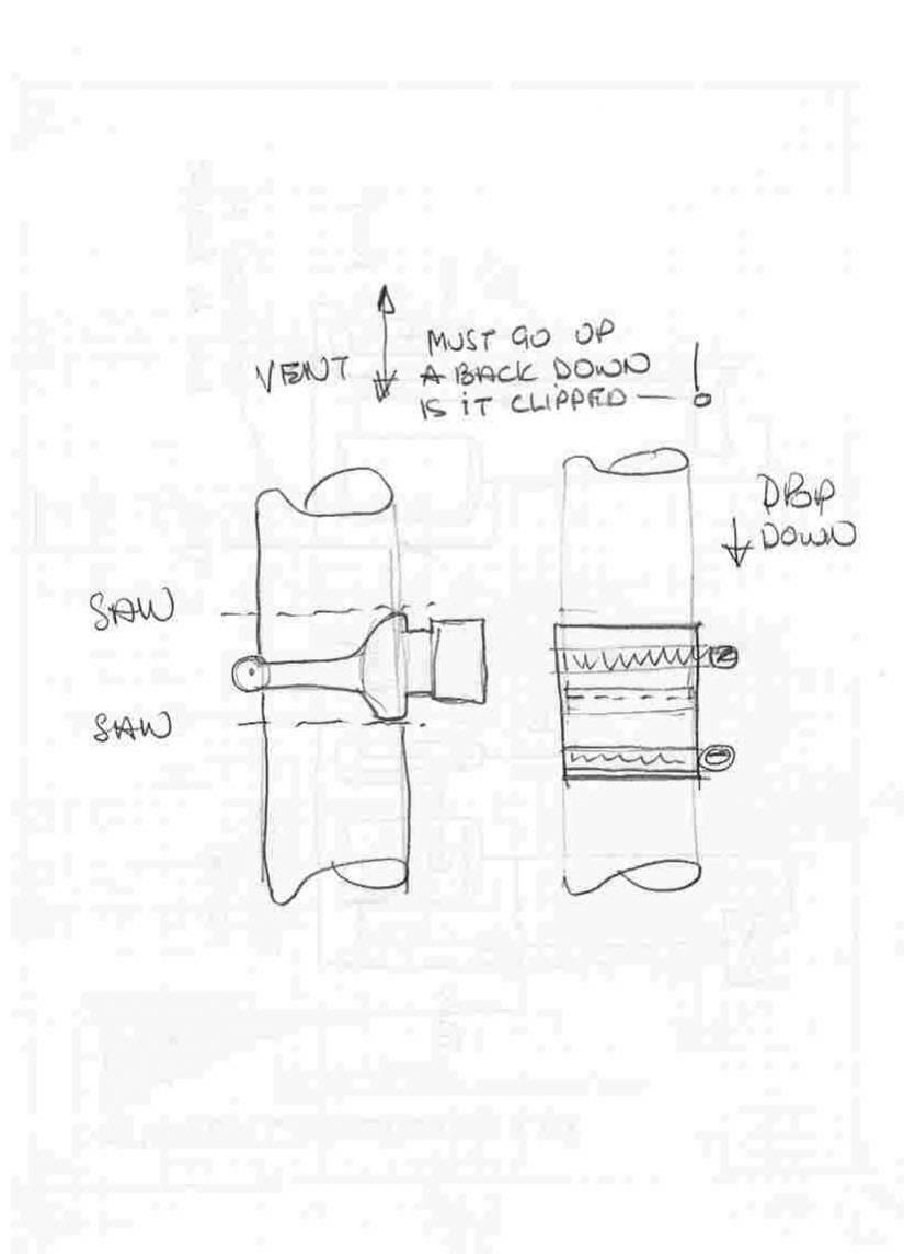

joint.png this might help, only if the pipe now becomes a vent pipe, if you need the room this will do

View attachment 13212 this might help, only if the pipe now becomes a vent pipe, if you need the room this will do
