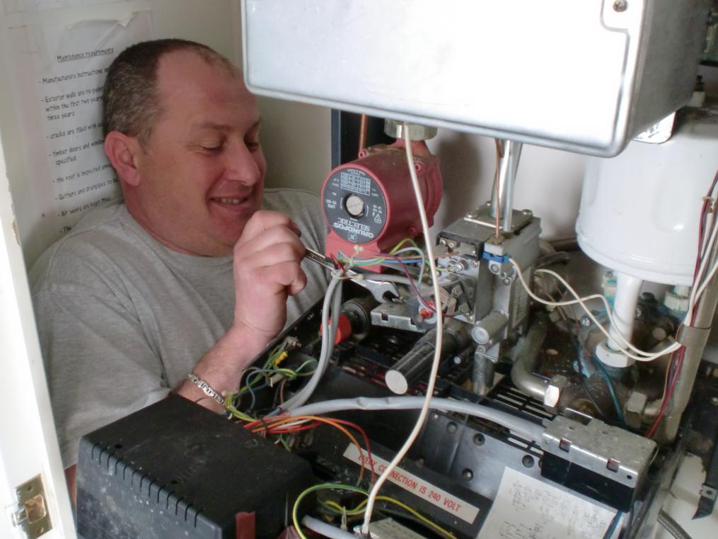

....here's a mate in what must be a 'room' then.........😀 I was able to close the door on him and leave him work in peace.......

now your being pedantic or maybe my wording didnt read right i still stand by his principle if you can go in and close the doorwhile attending the boiler its a room which ties in with the 5 m2 being spoken of else where
a small broom cupboard is a cupboard no matter how many apprentices you can squeeze in
