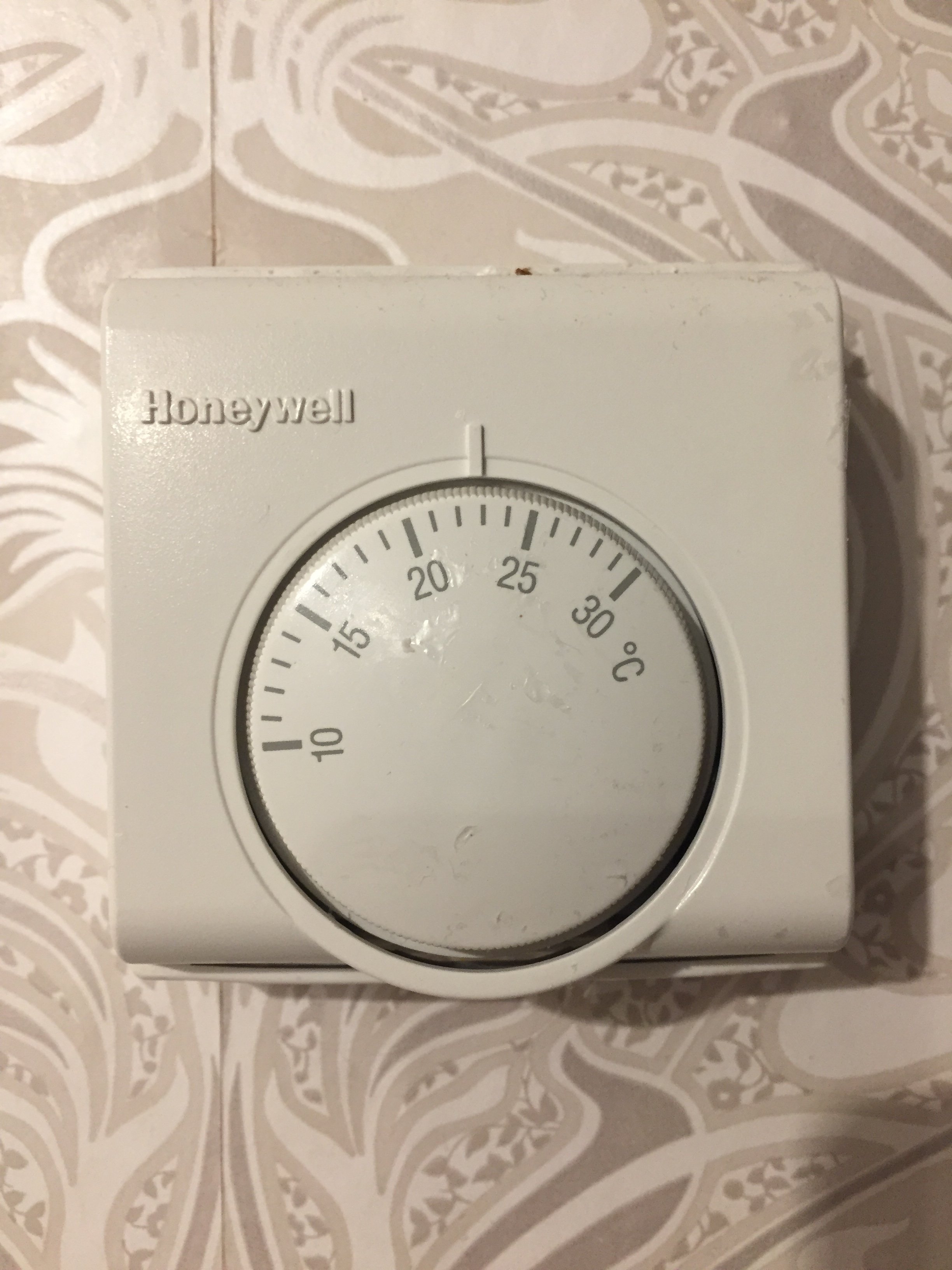

Hi all,
I’m looking to change my room thermostat - it’s currently an old type as pictured below, which is positioned in a draughty hallway which is no good what so ever. I need a thermostat in my living room instead where we spend most of our time.
Is it easy to disconnect the existing - no problems leaving it in place, and replacing it with a wireless one which I can place in the living room or whichever room i want?
If so any suggestions on a cheap option? In the next year or two I plan to move to Drayton Wiser or Evohome but for now I just want a stat that can actually measure / cut off when i reach say 20deg in the living room - the draughty hall never hits temp / never cuts off the boiler because of it’s position.
Ross

It's designed to go in the coldest spot, if you put it in your living room and shut the door the living room will be nice but the rest of the house might be cold
If it's too warm in your living room adjust the trv on the rads in there down one
I get that in some theory, but it’s completely pointless as it never ever gets to temp - above say 16degs in the passage. So never kicks off, so say i have the heating programmed for 6-10pm, it will stay on for that whole time. I want it to knock off once warm enough in the main room, then kick back in when the temp drops.
Can it be moved / disconnected and replaced with a wireless one? Or is it a big job?
How warm does your living room get? If you place a roomstat in your living room, then its more than likely that the rest of the property will remain cold.
If the passage never gets to 16 degrees then try it at 15 degrees.
Adding some draft proofing may help!
Get a programmable RF thermostat too, more accurate and you can either have it on your wall or take it from room to room with you.
I can't see any reason a wireless one wouldn't work. As others have said, the stat is in the hall for a reason, but the advantage of wireless is you can move it around until you find the location that best suits YOUR needs.

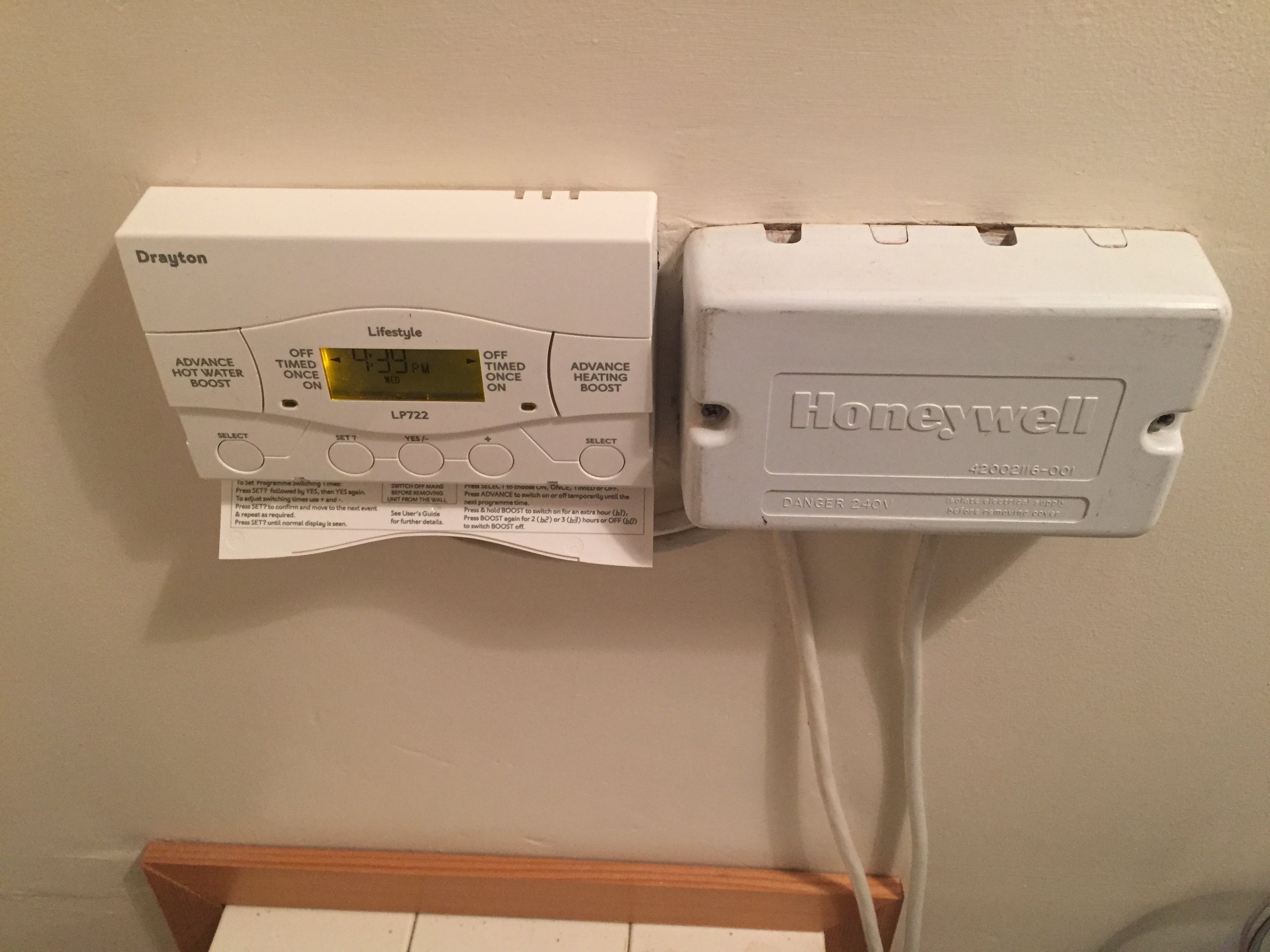

View attachment 32515 View attachment 32514 View attachment 32513
Yes you can move stat to living room have this same set up in my home Use a Danfoss Wireless Room stat .This is something you can do yourself I see by your attached Diagram you have a wireing centre and the Room stat either knocks of a MIV or Just Boiler You will need 4 core cable In the wireing centre you will see were Old stat is wired draw were these wires are so you can know were to put new wires all you need is live and netural going to RF Box plus two wires going to centre in all 4 wire to centre to RF Box Live Netural .Com . Call. So were you have the room stat Put the RF Box Wired To WCentre then install stat in living room just remove head on TRV in Living Room If you Donot do this TRV will Mess with Room Stat
