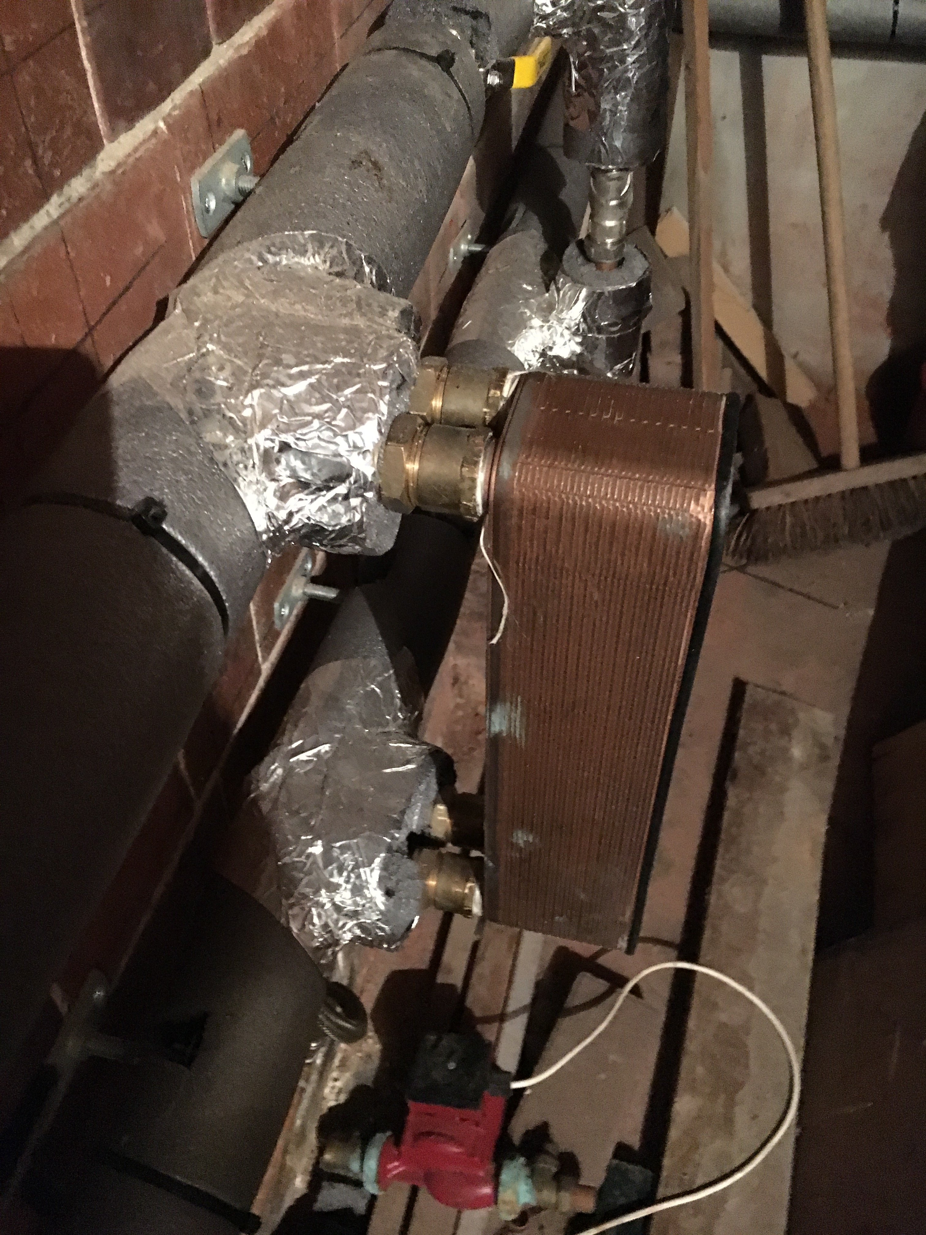

Fitting an external plate heat exchanger to the system with own pump circuit. The photo shown is on to a old one pipe cast iron system sperated by a plate to the new pressured stytem.
