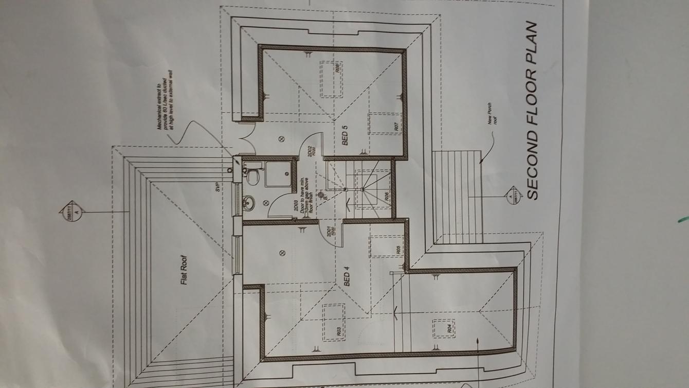

Below is an image of a soil pipe I need to run. What is the best way to run the bends at the bottom of the stack so it doesn't cause induced syphon age? I think 2 90's would be a bit tight so was thinking maybe a 45 and a 90?
Also what do people think about using a flexible waste pipe to go through joists? The joists are 250 and my run is 500mm from shower to soil pipe? Or is it best to just drop down below and box in?
Rodding eyes? Even if my pipes are in the ceiling voids or boxed in will I need to put rodding eyes on all 90's for the building inspector to be alright with the install?
Cheers chaps

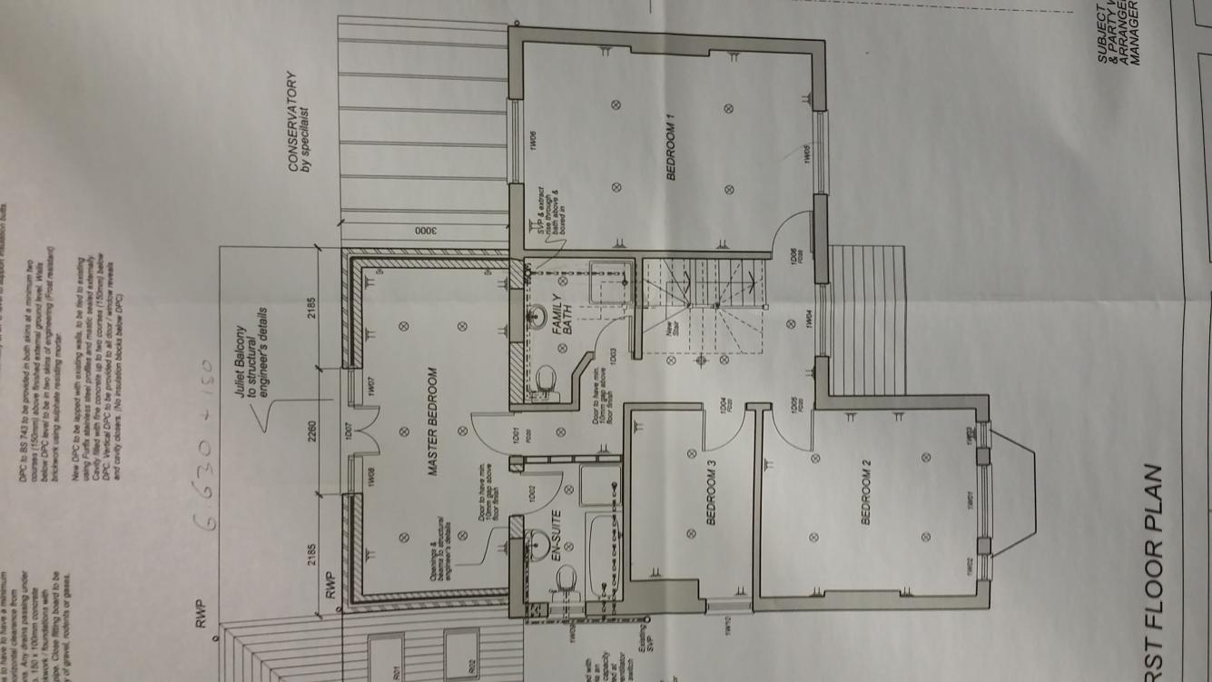

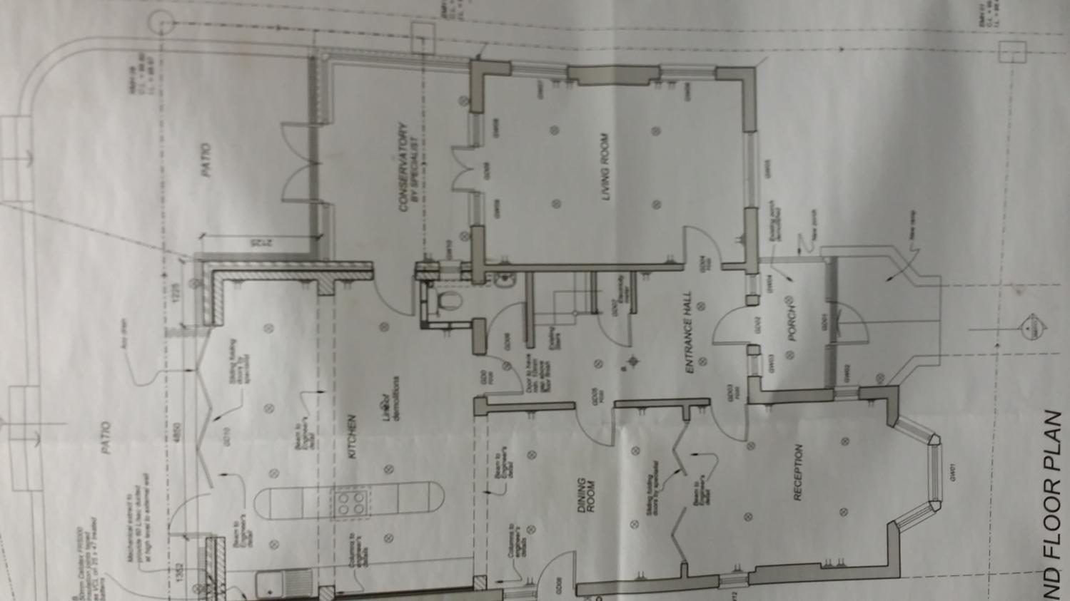

The architect has decided where the runs of waste go. It's nuts20160114_121053.jpg20160114_121047.jpg20160114_121105.jpg
Crazy pipe runs. Especially ground floor and 1st floor toilets. I need to try and put an access at the bottom of the stack to put my bung in to test but not sure the best point as I need to test the ground floor toilet as well?

Dog leg with two 45 bends at ground floor ceiling/ first floor, floor level. Then long radius bend at ground floor level with access hatch above. Avoid flexible waste, they become brittle and split.
if thats new build you will need to put the ground floor wc on a seperate drain how is the ensuite connecting to the soilstack or is it on a saniflow?

For you bung, usually stick it in the manhole, thats what ive seen anyways
It's not a new build. A total refurb. I told the site manager about the toilet going straight to drain and he said he will sort it with building inspector.
