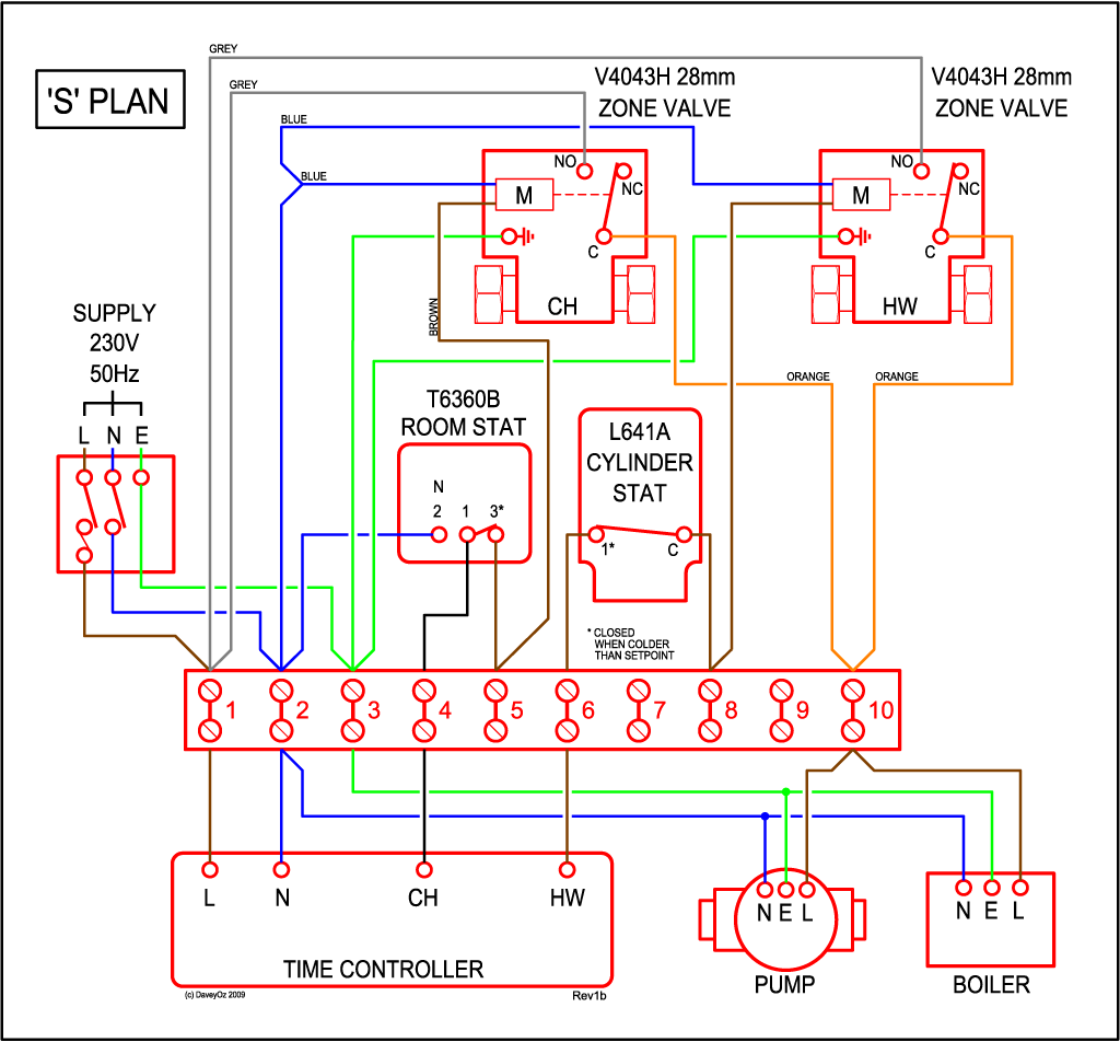

I'm looking for advice on wiring an unvented cylinder and systems boiler.
I'm ripping out a Boilermate 2000 (1st floor) and Potterton Suprima (ground floor) and was wondering if all the electrical connections for new thermostats and ability to wire to the S-Plan and boiler will already be in place. Would I need to run any new cables through the house?
Can't get a hold of an electrician and is urgent.
Cheers

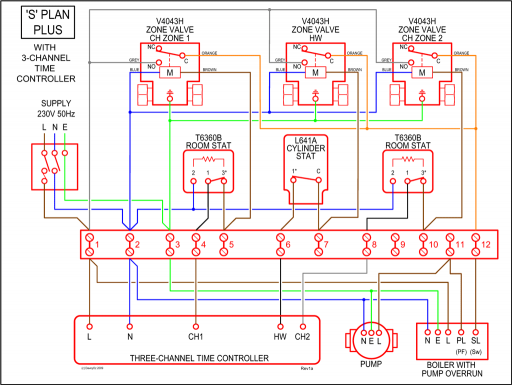

What’s at the boiler ?
If there’s no perm live I would run a new cable in case the boiler gets changed later on So
Perm L
Neutral
Earth
Switch live
Pump live
So min a 5 core cable
Sorry, I've confused myself due to looking at the heat only boiler. With the ATAG heat only boiler with external pump, the pump needs to be wired back to the boiler. And yes, I'm G3 registered. Since fitting the system boiler, it's just the switch wire from programmer
Open forum @ShaunCorbs. @Andrew Robertson who fitted the cylinder? Why is it being wired in? Are you G3 registered?
You can still wire them up if your not g3 as the engy who installed the cylinder will come and commission later on
Happy ? Or still stuck

Should not need to be a sparks to wire that in mate. Any installer should have the know how to do it themselves.
"should" being the operative word
I see recent installs without a PL to the boiler and installs where the neutral has been used to provide the SL or PL and then the neutral "borrowed" from another circuit.
The latter causes havoc when doing fuseboard changes! I always fit RCBO boards so this flushes out borrowed neutrals really quickly!
Before moving into this house, I would have said yes the wires will be there, however this house just two wires between house and the flat where the boiler, pumps and valves are.
I really do wonder how it was originally wired? The programmer had around 8 options with once and twice a day central heating and DHW but it was also clear that all the programmer did was turn it off/on, selecting CH or DHW did the same thing, it supplied the boiler with power.
And yes the plumber looked at it and said he could do plumbing, but getting wiring sorted was some thing else, lucky for me, I don't have a problem designing and fitting the control circuit.
S, C, W or Y plans are a good start, but often these need modifying to suit. So I work with the plumber, he dropped off a motorised valve, I wire it, then he returns to fit it.
