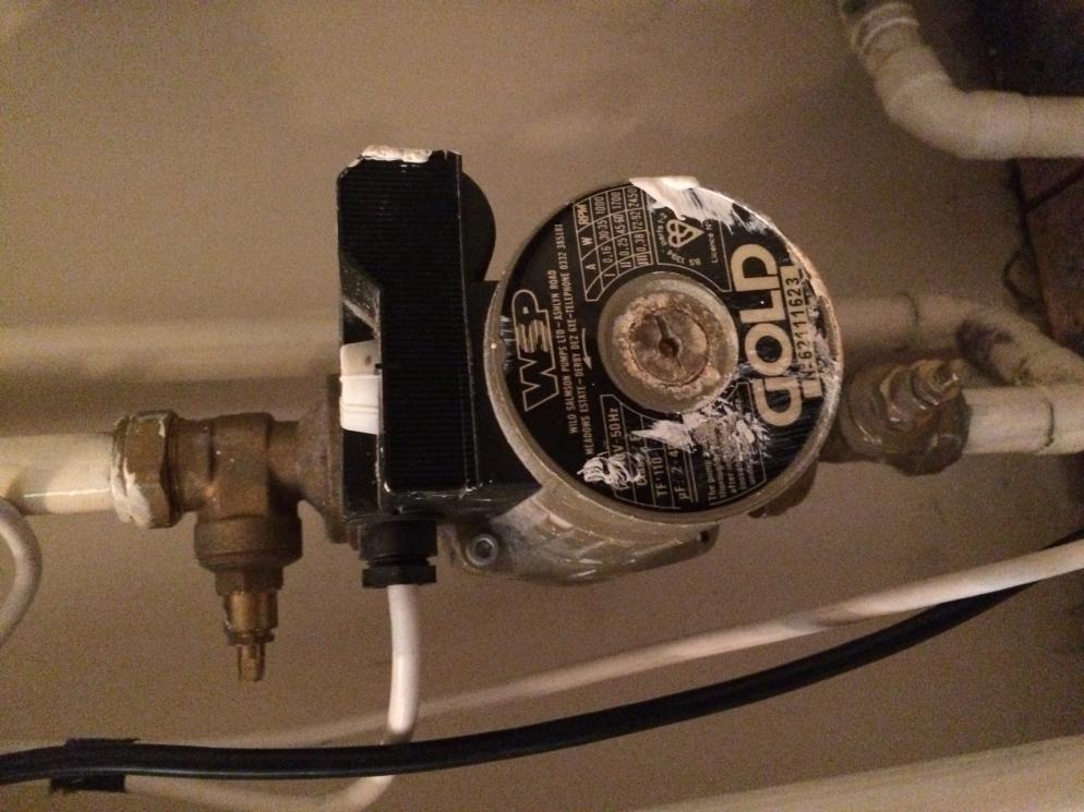

Regarding my vented system
If I go ahead and get the three way valve (diverter valve) changed should I get the wsp gold
pump changed at the same time (if so what type would you recommend)? The system is 24 years old and original.
All the radiators still get hot.

I sorted it in the end replaced 3 way valve and motorised bit. isolated tank in the loft. drained radiators. cleaned with flushing agent.
drained topped up with inhibitor bled radiators.
I left the pump for now. bled the feed into the hw tank and primed the pump to get it started again.all working and switching ok.
