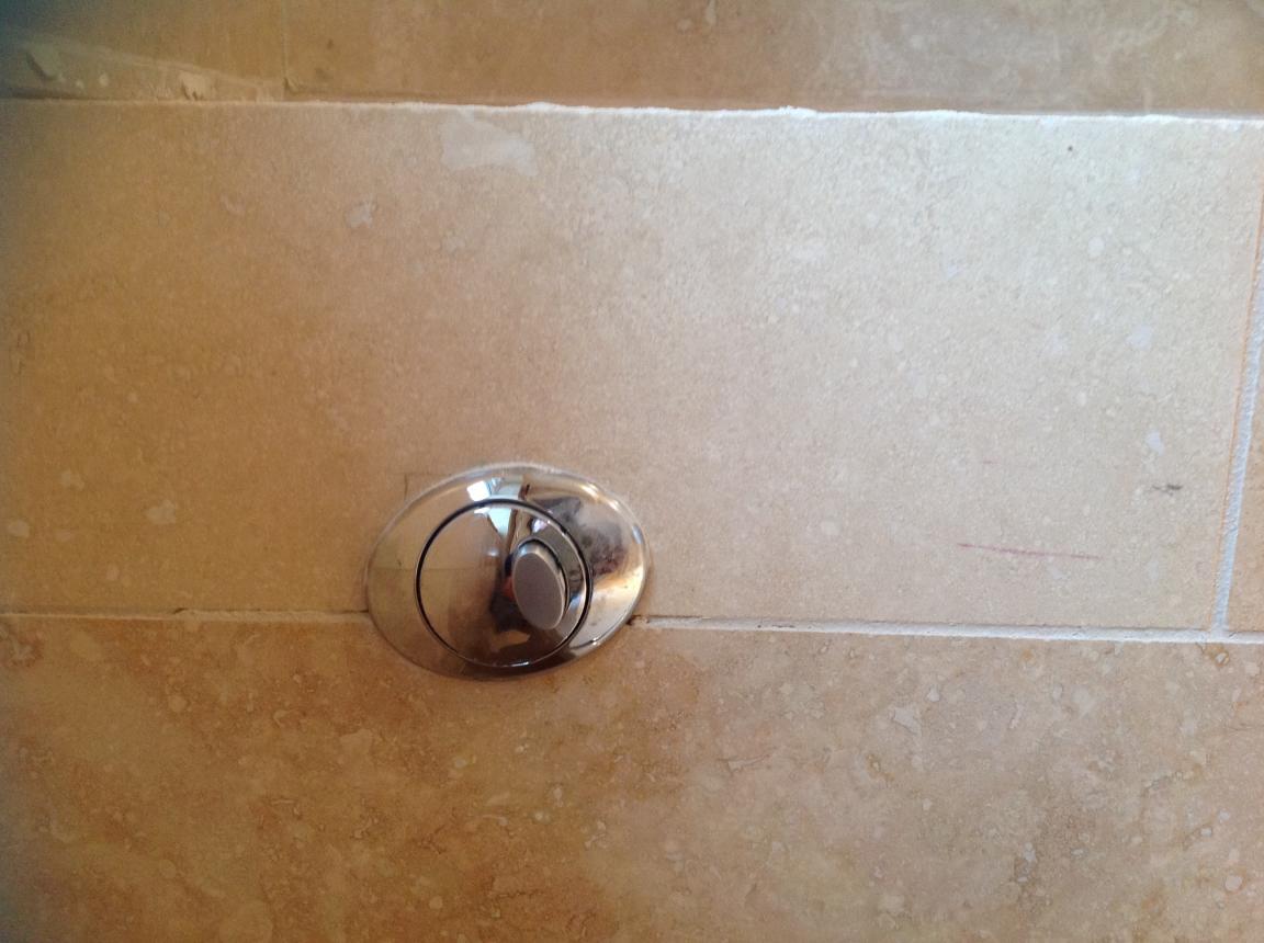

Hi all, look for some advice. My toilet won't stop running. Not all the time , but it's a pain in the you know where. It's a concealed unit made by macdee. The short flush button on the dual flush button is and has been slack with nothing behind it when you press it for a while. Not sure if this is part of the problem. The only details I can read inside the cistern are as follows :- Macdee,WRAS,AFV 40100,AFV 40200 on top of the unit to the left of the picture below. Thanks for any help in advance.

Hi Marka and Riley, thanks for the replies. Yes the water does run into the pan, but not all the time as it is an intermittent problem. Does the flush button problem have anything to do with it, or should both the button and flush mechanism be replaced ? Thanks

Yes that's it melmos! It might stick once in every 20 flushed or so. So which one holds the fill valve in the photo and how do fix/ replace it ? Also the half flush button does not work only the full. Is that just a straight swap for a new one ? Sorry but I have little to no experience with toilets. Thanks again

If the push bottons arent working then this could be the problem.
