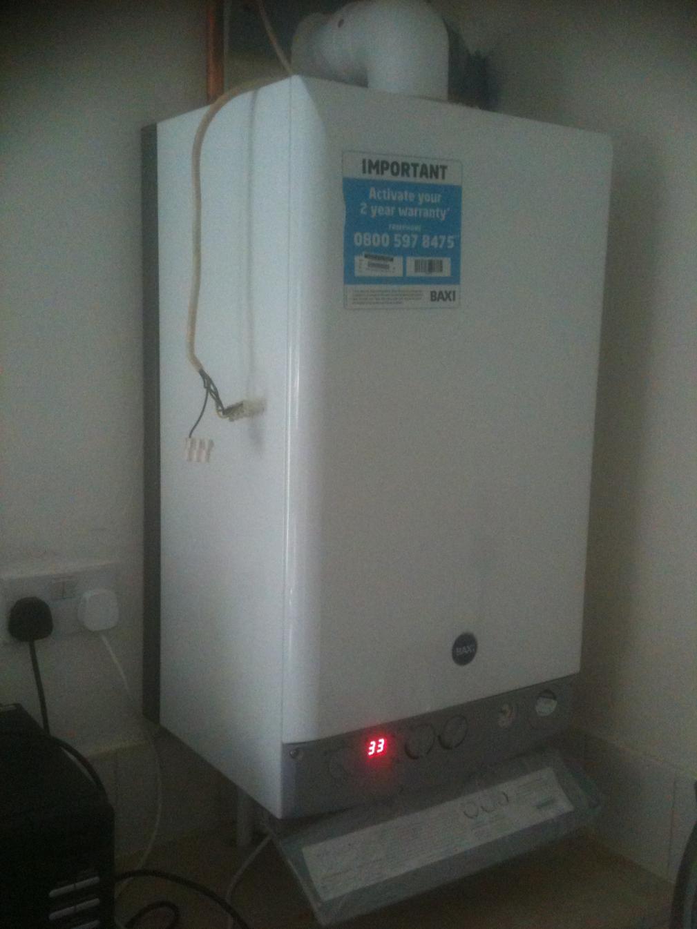

when i got to property, it was a warden aided sheltered apartments. as i was walking through his door i thout they was all on comunial systems but there you go, one duotec on the wall.
it had a plug top on it and was switched off at socket.
thought the wire hanging down a bit dogy (tested it but had no imediate power)! and there was a box on top with honeywell controls in it. so they had not been wired in. i flicked the switch and there you go, hot water no heat control!. there was no bench mark in the paper work and the old chap told me they put it in 1-1/2weeks ago!!.

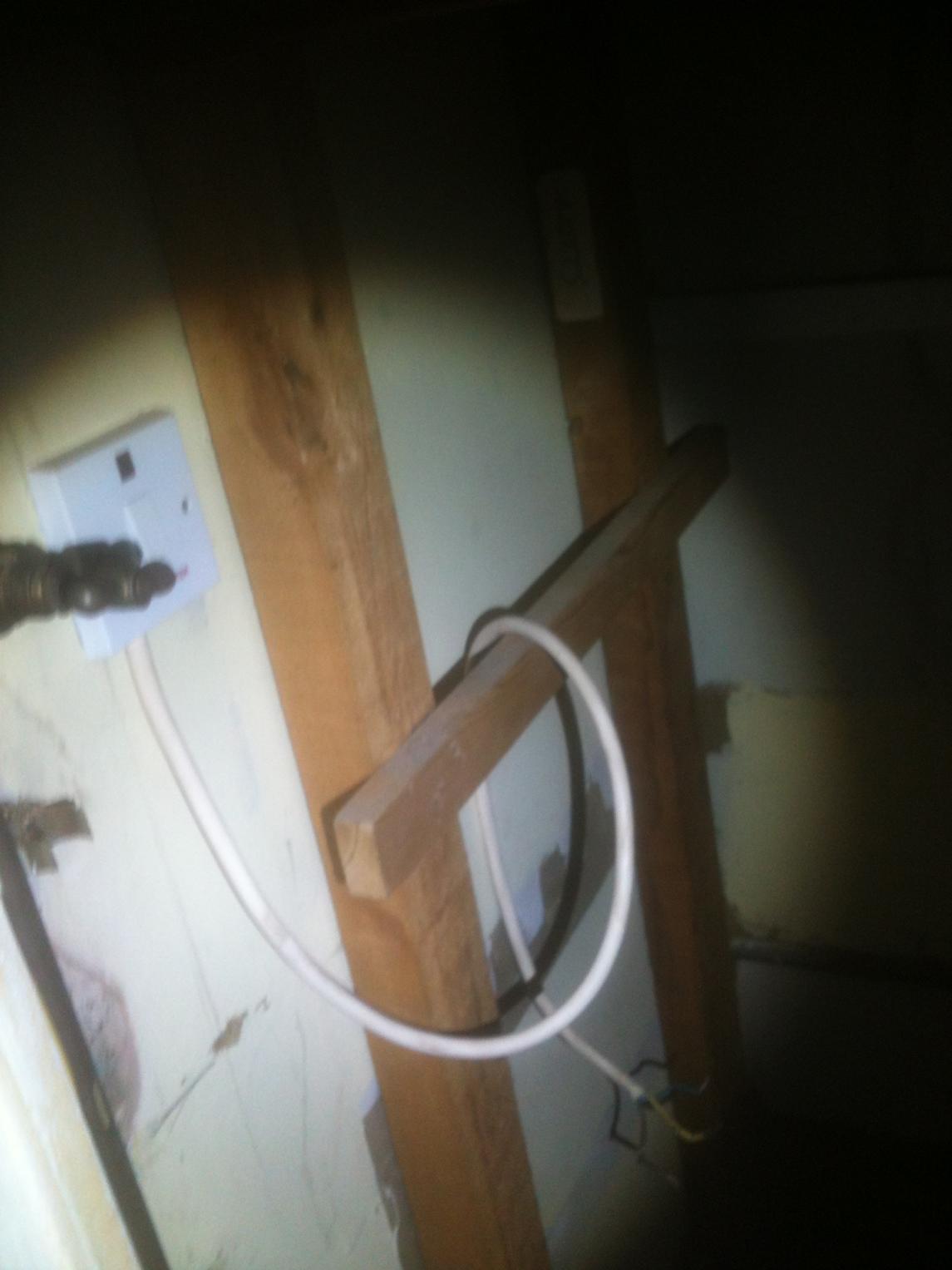

curiously, i chased this wire to a cupboard which was were the old cylinder was and found this 2'' from the guys mop bucket handle!!!! i was gobsmacked as i was close to touching it also:veryangry2:

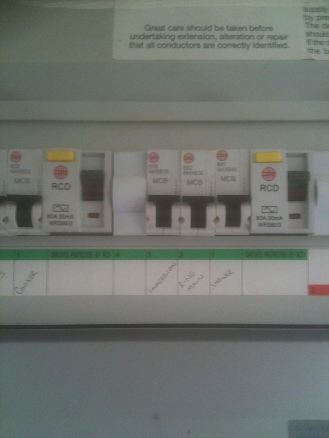

whoever installed the boiler didnt even bother to trip the fuse switch (which is out of reach of tenant), what a moron!.
turned of gas at boiler, took out cable to switched supply and tripped fuse. i got hold of manager and she is livid but sorting it out now with contractors.
