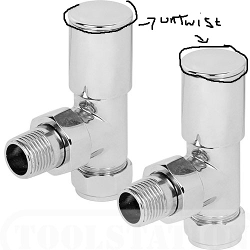

mark don't get your hammer out yet! the very end of the cover unscrews to reveal a screw to take off the cover proper.
Not on the ones the cust got for me. That's exactly what I thought though steve, wouldn't budge even with pump pliers on it.
i unscrewed the cover and all that was there was the threads for the screw i had just removed.I have seen ones with a spindle and the head just pulls off but these ones appear to be different, as though you are not supposed to get to the gland. last time i buy cheap ones off internet!!
I've had the same - they felt cheap when I fitted them.
Sometimes if you open it fully it stops the leak (this is what I did with my leaky ones).
Lol i got them same valves in the bathroom, I was taking a dump and lent my hand on it and turned it and the bugger wouldnt stop leaking.
I solved it though after going into work and grabbing some ptfe and LSX from the boys. you can try tighten the packing gland nut, untwist the silver bit at the end and it should pull off. i then undone the packing gland, make sure the heating it off because i'll admit it did feel like it could of popped out haha, ptfe the thread and put it back in then i smeared some lsx around the lockshield part also. goodluck
was about to change them but thought i'd try one last time to get head off with a big flat srewdriver. valve head almost bent back on itself... i turned valve a bit ands tried again...then a bit more of a turn and hey presto it came off!!! the relief.... tightened gland nut about half turn and job sorted...thanks for all your replies
