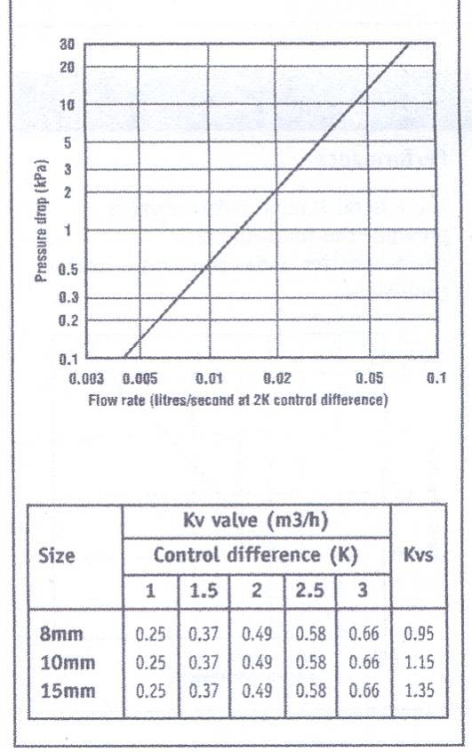

Can anyone help me to read the graph TRV performance data.jpg of pressure drop/ flow rate, and the chart of Kv values? I shoulc think they are really for commercial installations, but I wonder if they are any value for domestic properties?
In my experience these will only come in to play of you exceed 12 rads. But tbh I would just fit a bigger pump
This is primarily for larger installations where you would utilise a llh and have to rate the pump suitable for the system
Can anyone help me to read the graph of pressure drop/ flow rate, and the chart of Kv values? I should think they are really for commercial installations, but I wonder if they are any value for domestic properties?
They are mainly used in large complicated commercial installations - office blocks etc. The designers will have calculated the required flow in every branch and radiator and installed control valves to regulate the pressure drop in each circuit. They will therefore know what setting the TRV has to be on.

I think you are essentially talking about system balancing with the Kv values. Is it not quicker to use these for a quick setting, rather than go round the system checking the flow and return temps with a pair of thermometers? (...not that it is necessary to go this far with a 3 bed semi for instance. A pair of hands is good enough!).
Yes, it is system balancing. If you use the TRV to balance, the lockshield valve is left fully open. A good starting point is to set the TRV to 4 (that refers to the numbers on the black ring round the pin) and adjust up/down if a rad is too cold/hot. Drayton will supply you with the spanner free gratis.

I agree that the difference is due to different pressures either side of the rad. I'm not so sure about the pump pushing as well. If you have a 15mm pipe containing a restriction about 3mm square teed into a 22mm pipe the water will naturally want to follow the easier path, i.e through the 22mm pipe. TRV manufacturers give a maximum recommended pressure drop across the valve, usually about 0.2 bar or 2m H₂O.
This all relates to balancing the system, so you get the correct flow through the radiators. You might like to read [DLMURL="http://www.draytoncontrols.co.uk/WorkArea/DownloadAsset.aspx?id=24266"]Drayton's advice[/DLMURL] on this.
