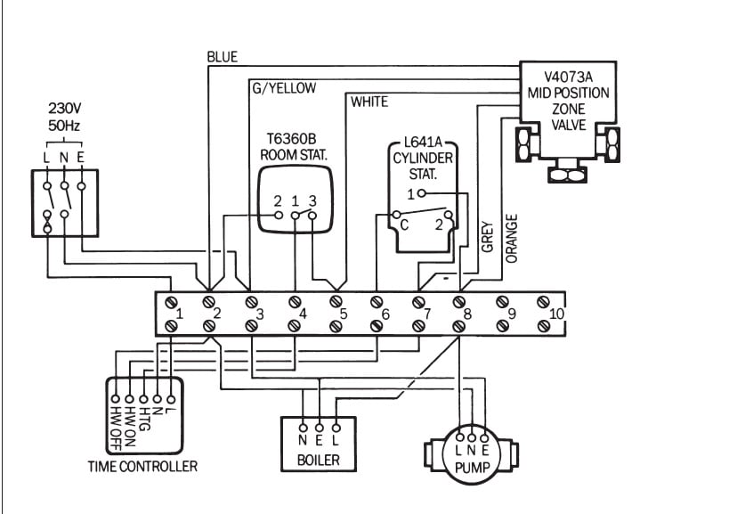

Check your wiring against this:
Well, i'd be checking the wiring first in that case.
The wiring shown assumes that the valve has been installed correctly - Port A to rads, Port B to cylinder. As the problem has always existed the orientation of the valve also needs to be checked. I suggested this earlier, but it seems to have been ignored.
If it has always been like this then perhaps the wiring is configured for the old BG 'guaranteed warmth' system.
This prioritised hot water and the heating wouldn't comes on until the hw was satisfied.
Sorry didnt purposely ignore you - just checked now and it appears valve is installed correctly as port A definitely goes to rads as you described
Which is exactly why I said he should check the wiring against that picture to see if it is installed correctly.
I'm not disagreeing with you, just pointing out that the physical installation of the valve, i.e it's the correct way round, needs to be checked as well.
The Drayton MA1 is a mid-position diverter valve. When calling for both hot water and heating, providing it is wired correctly, the valve would be held in mid-position by what's called a DC brake.
(Applying DC voltage to the actuator motor locks the motor in position). This is done via micro switches in the actuator. If it's always mis-behaved then it sounds like the system is not wired correctly. 240 volts ac to the orange wire and the white wire to the actuator at the same time, should hold the valve in mid-position.
Also check where the grey wire is wired to, 240 v ac to this wire closes the hot water port.
