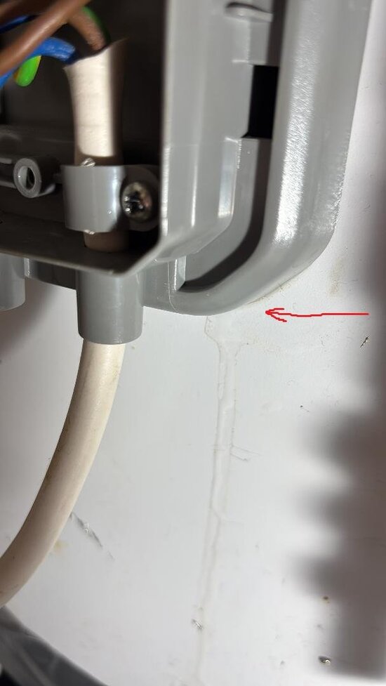

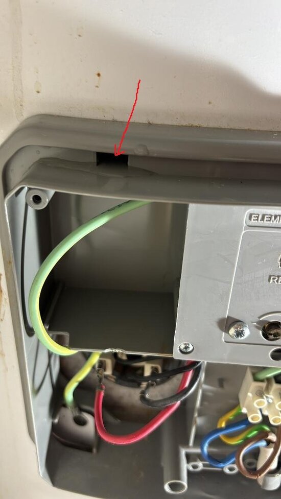

A daughter has a Main Unvented direct cylinder, with a leak. She says the leak is coming from the top of the electrical box, ie where the immersion heaters go. Having looked the manual up online I am unsure how this electrical box seals to the tank. I would have thought purely aby immersion bosses. If so why water on top of electrical box. Any ideas gratefully received.

Also when she mentione G3 he said he had never heard of it. Alarm bells ringing with me straight away. He said to her he had done one last week. So what if not supposedly to do them seems he does not care. Now more to where the leak is coming from, supposedly. This plumber said was the seal around the bottom of the tank hence needing replacement. Well one is ther a seal as I thought tank is one piece and Main give a 25 year warranty on the stainless steel interior so I very much doubt that has sone as was installed in 2014 so doubt it is a fault. Now she says it is leaking from the electrical box in the position evidenced in photo tank2 but also, and this I cannot figure out from the fixing socket of the front cover as in photo tank1. Am I missing something obvious here? And finally I cannot understand why this plumber says is a 2 man job?
