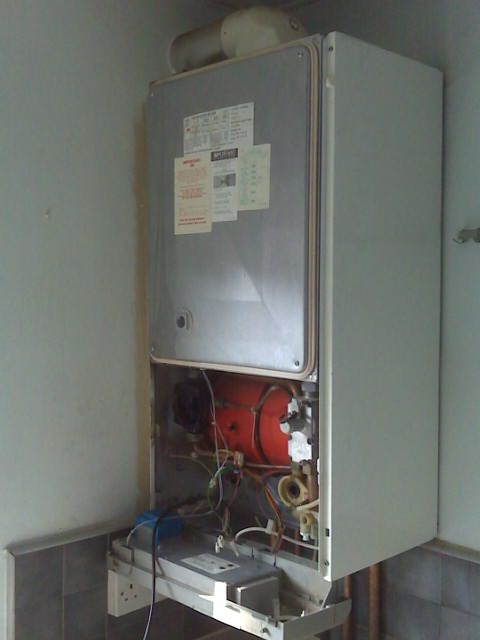

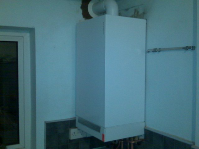

I removed this 280 Worcester bosch, and replaced it with this Viessmann Vitodens 200 series 35kw combi boiler, ugly but a very very special piece of Germanic engineering. pic00016.jpg
