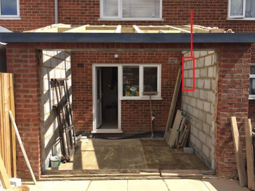

I've selected a few pictures which best capture what I'm trying to explain...
Early on during the build process...
Nearer to roof completion but better that you can see through the roof for options. Since these pictures the roof is now on and 2 Velux windows are now in (vent still on back wall of house)...
boiler should be turned off NOW,
do not use the boiler
as the pics you have shown the flue is obstructed by breeze block

The Gas Safe engineer came today to advise. He directed the flue in to the extension space (remember there are no bifold doors on yet, it is completely open to the rear and I have even left the Velux window open that is above the flue). The back of our house is still sealed as it always has been with back door and windows closed.
I have a fully working Carbon Monoxide alarm too! It's not reporting anything different (0 PPM on screen at all times).
post a pic of what hes done please
He just turned it so it is not pointing directly at the breeze block, it is venting in the direction of the open space which will ultimately be the extension. Haven't got any pics of it currently, I can put one up tomorrow but it is most certainly not a permanent solution!

i know what hes done, but still not right tbh, and do you know the model of the boiler ?
and did he have another option other than bedroom?

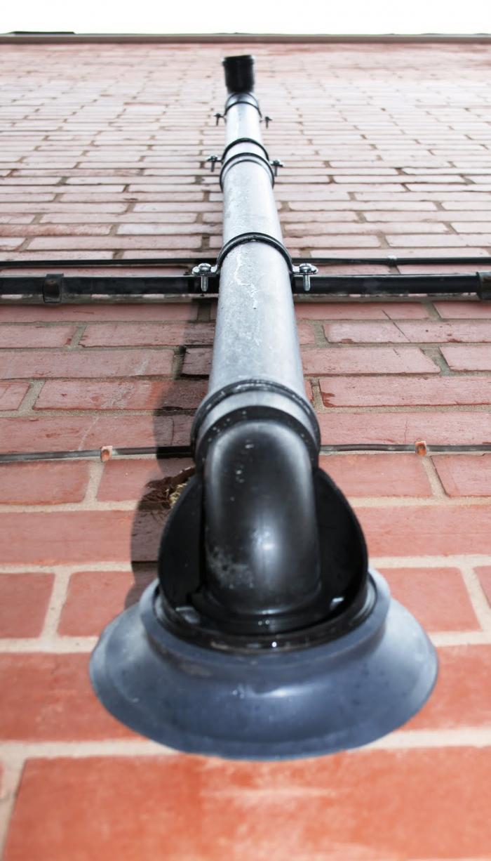

plume kit
and yes you cant do that as its still taking air for burning from inside the room

28i junior and should still be able to get flue parts

also can i ask if you have put the waste pipe back (where the white t is in the third pic?)
depending on kitchen units (tight to old wall) should be able to go there fine but double check with your gas safe eng
as cant tell exact sizes
If you are referring to the condensation waste I don't think that was what that grey pipe was doing, I have a feeling that it is plumbed in to the waste in the kitchen but I might be wrong. The waste that is currently on the back of the house is also temporary as the back wall will be coming out, most likely starting next week!
