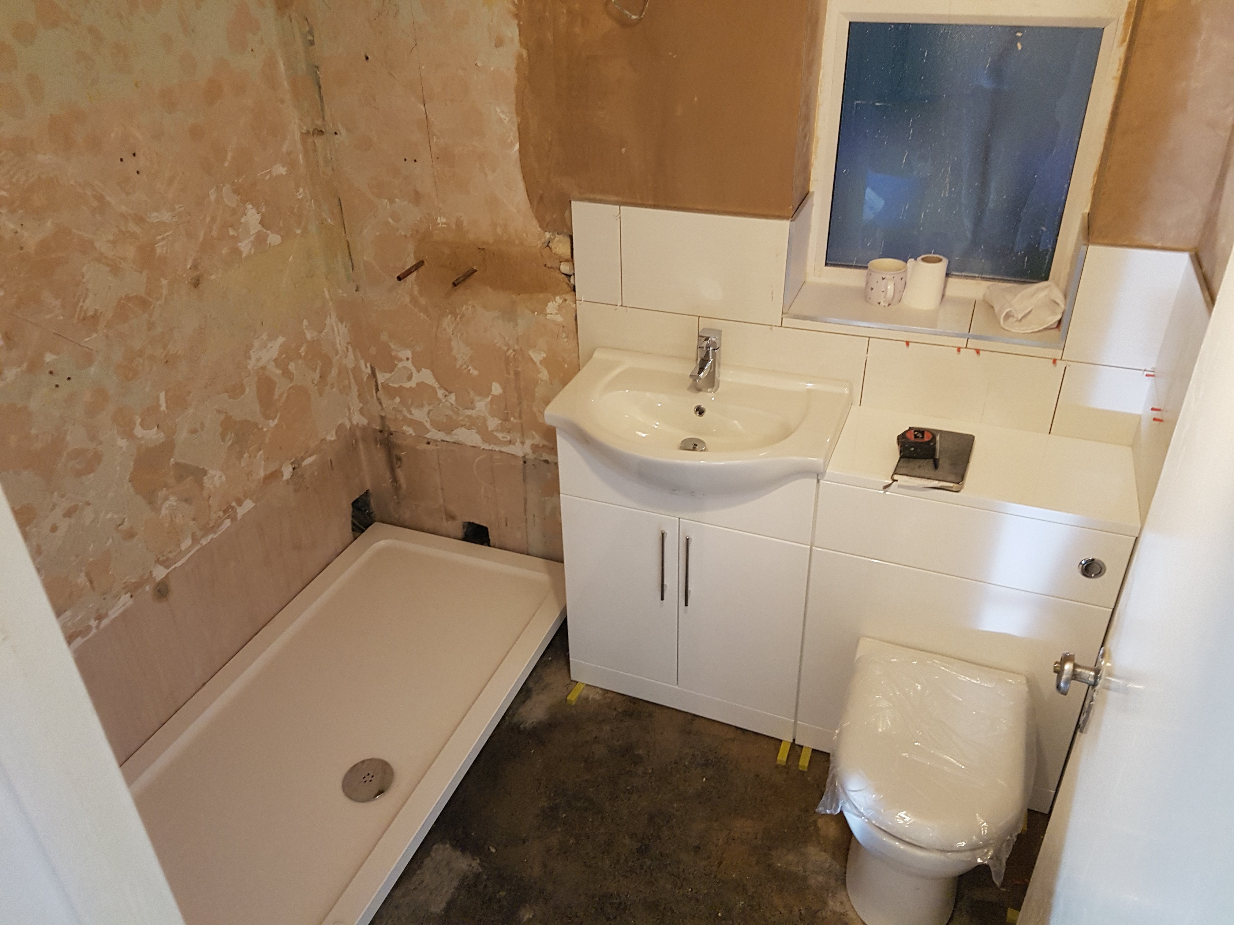

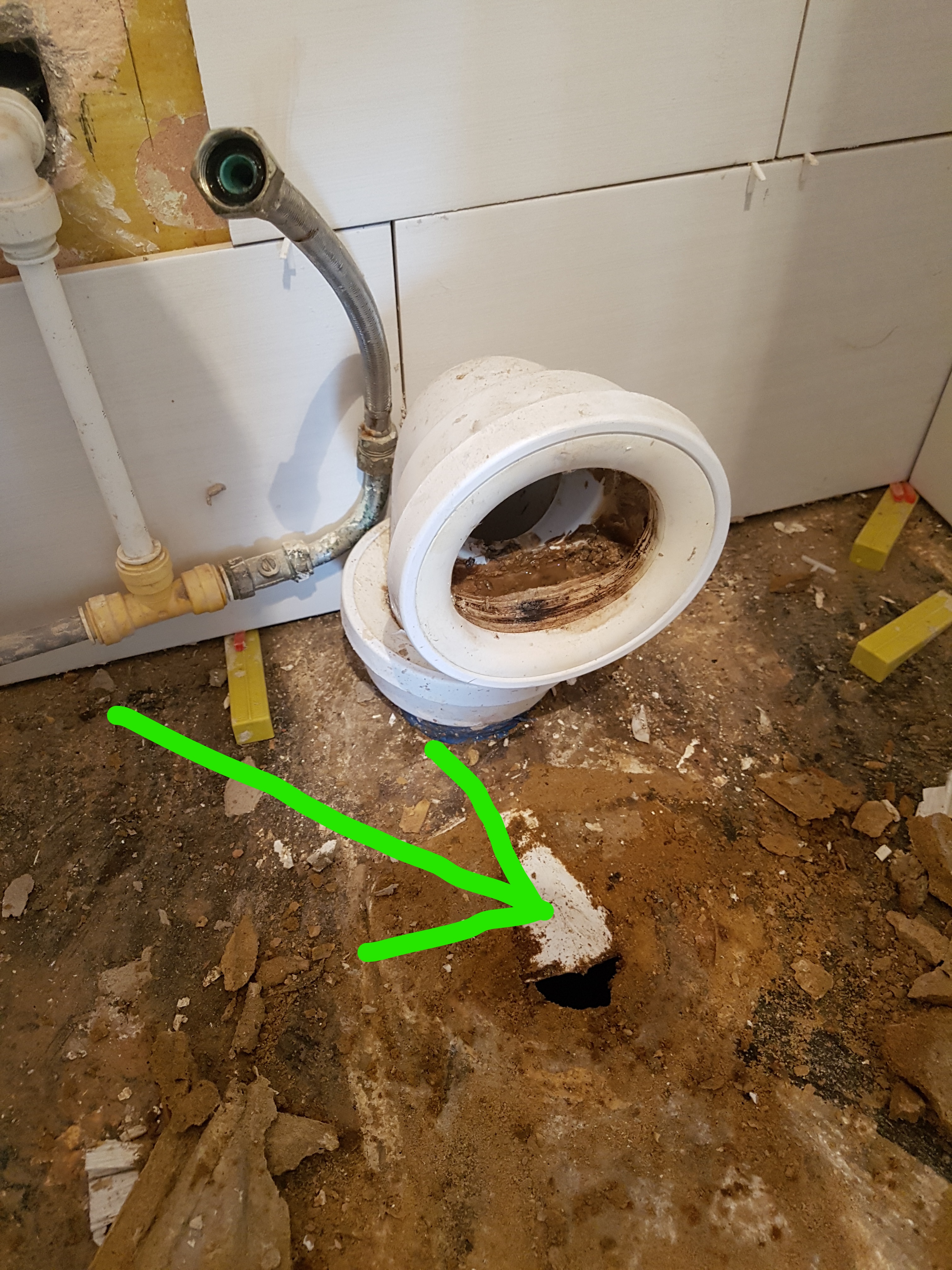

Hello all,
Today I was replacing a CC WC with a concealed cistern and BTW pan (in a cabinet). The CC pan was bedded on mortar, I couldn't understand why as the connector was going into the floor, then low and behold when I chipped the mortar away I came across this...
2 x 90 deg pan conn's joined to convert LL drain position to CC.... well I never?

There is never an easy job is there? What are you going to do now?

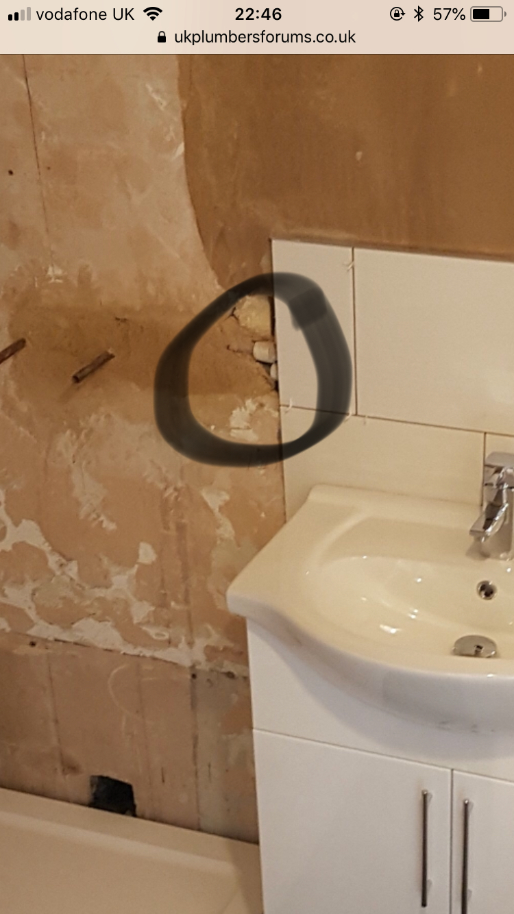

Iā€™m more interested in watching him silicone the outside of the cubicle next to the basin. :D:D

You mean you just left the waste like that Hmmmm, is the tray fitted surley not them wall's need repairing . Kop
No didn't leave the soil like that, new long 90 deg Multiqwik.

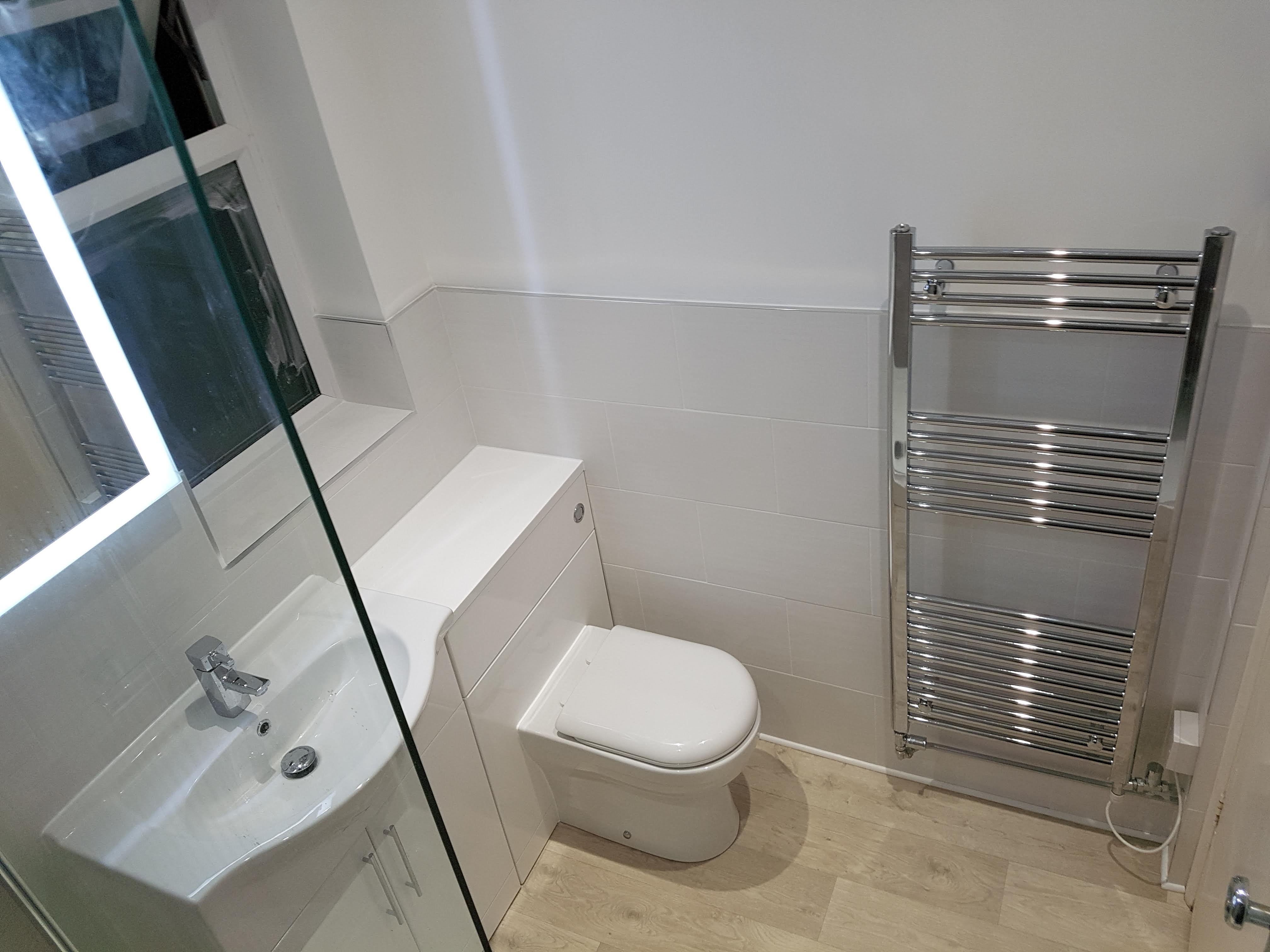

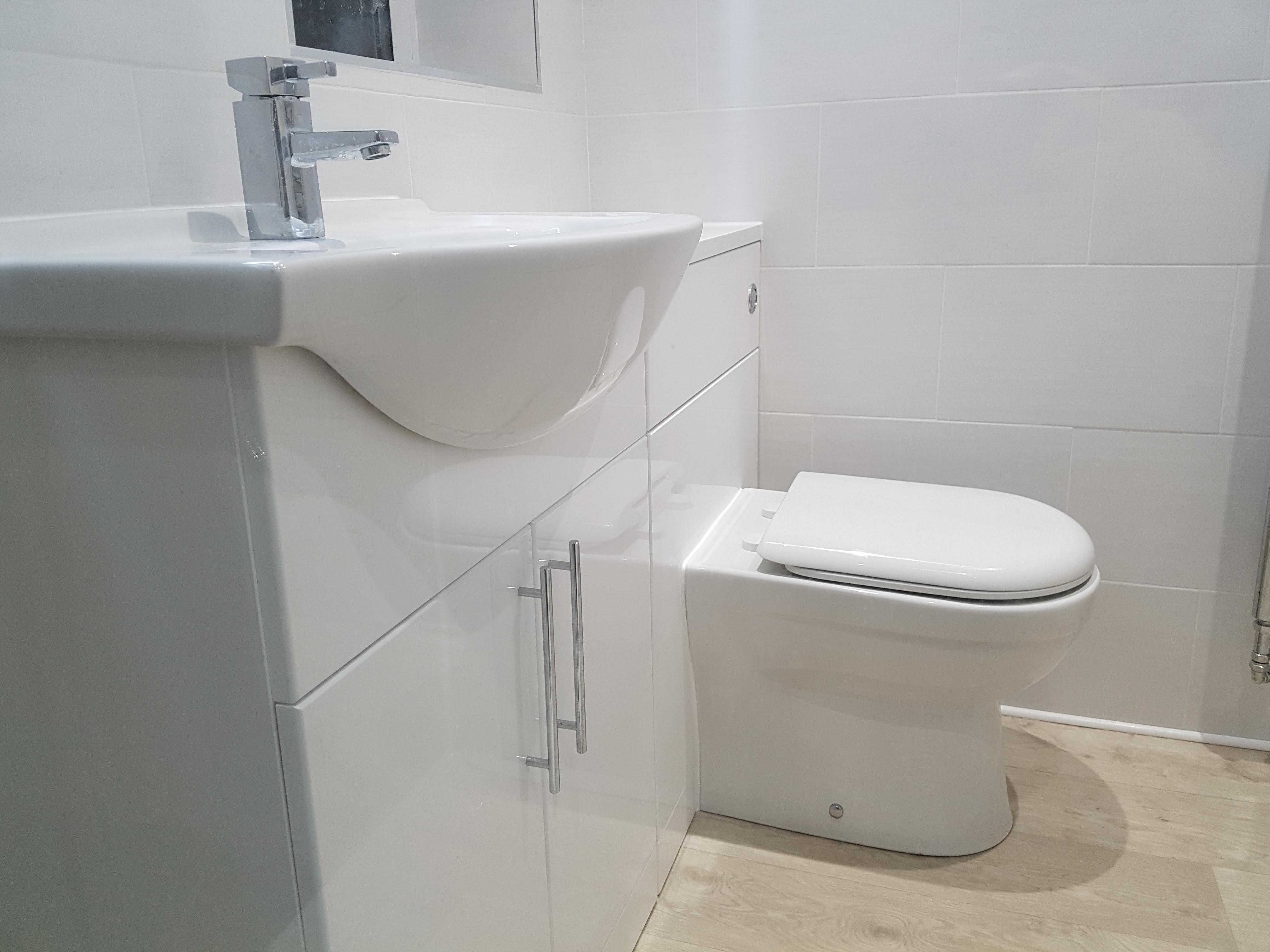

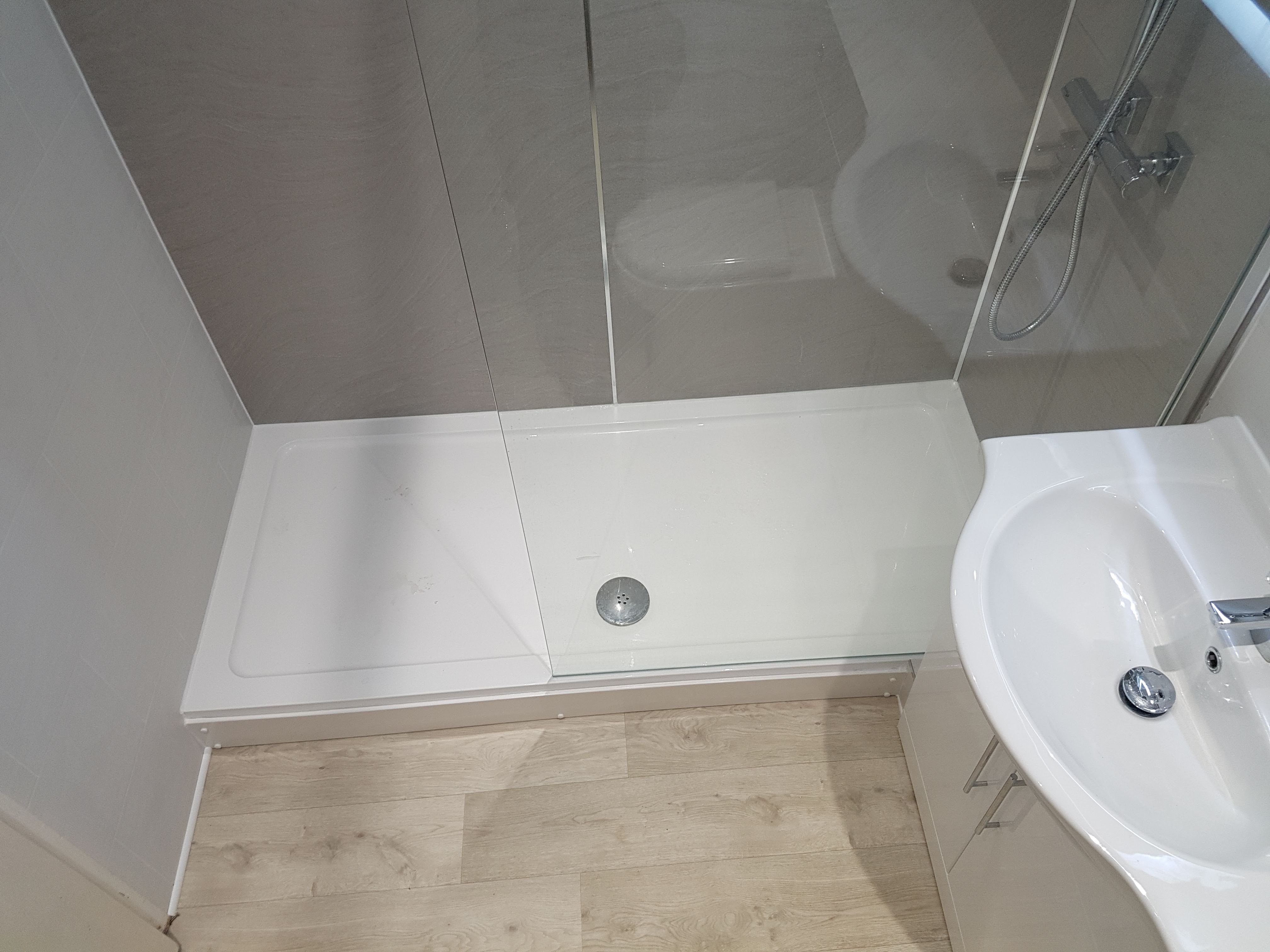

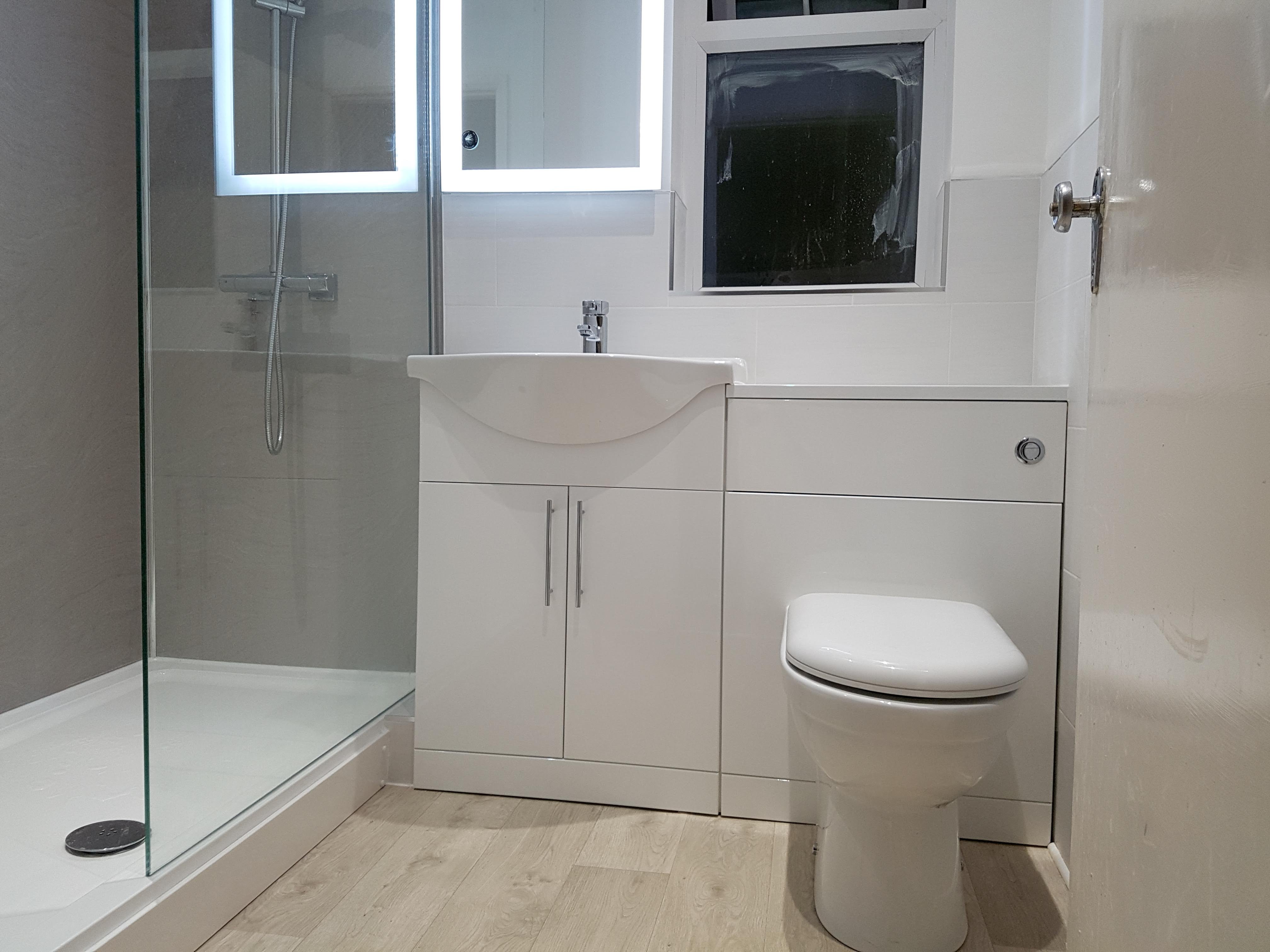

Here's some pics of the "dodgy" pan connector removed and the finished job.

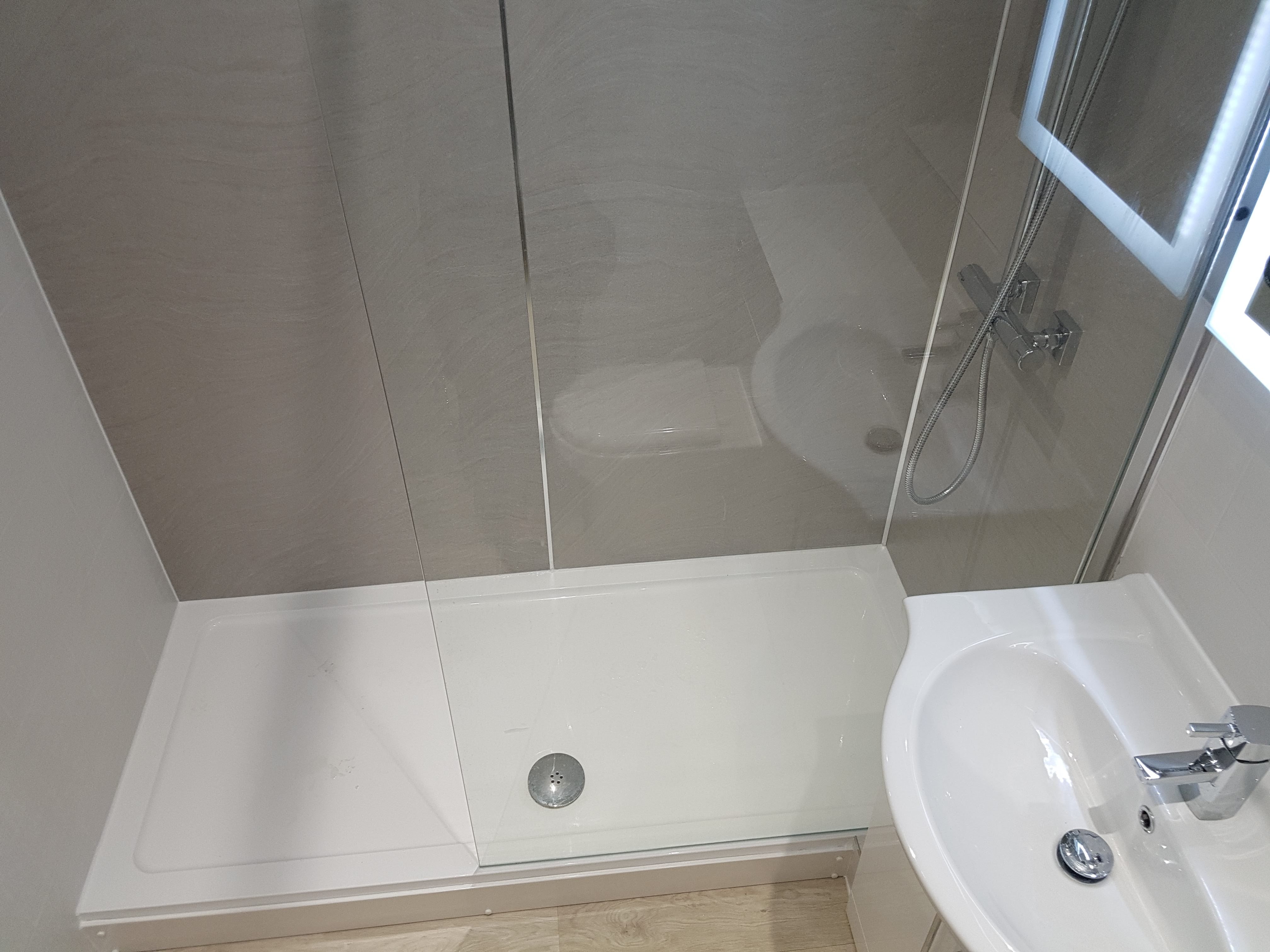

View attachment 34791 View attachment 34792 View attachment 34793 View attachment 34794 View attachment 34795 View attachment 34796
Spot on job well done , it a pleasure to look at
