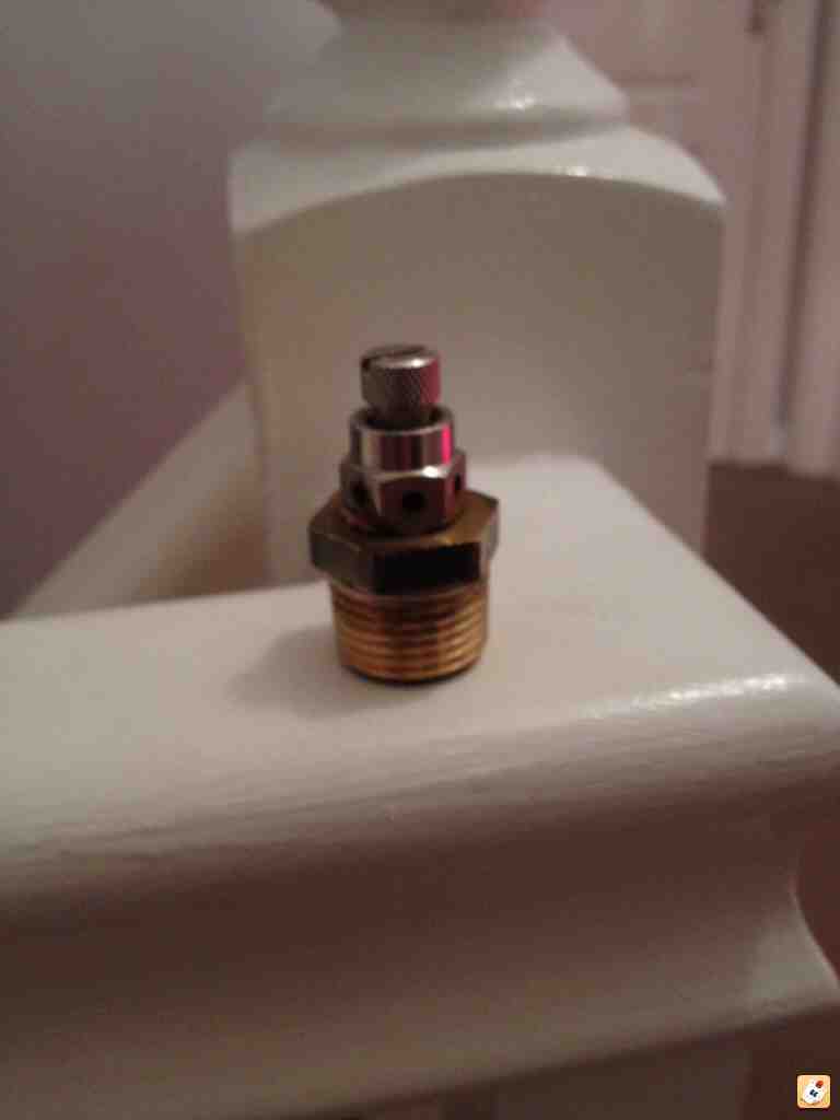

For years I've had the following auto air vent in the airing cupboard.
It tends to weep when set to the open position and so today I've fitted this Honeywell EA122 jobby.
It vented automatically as it should when refilling the system but with a manual vent I was able to shift more stubborn air after a few hours. I did see in the instructions that it should be positioned on the positive side of the system. Is this referring to a combi boiler setup? It's positioned on the return from the coil. Any thoughts? I think it's just a case of letting it do it's thing over the next few days
