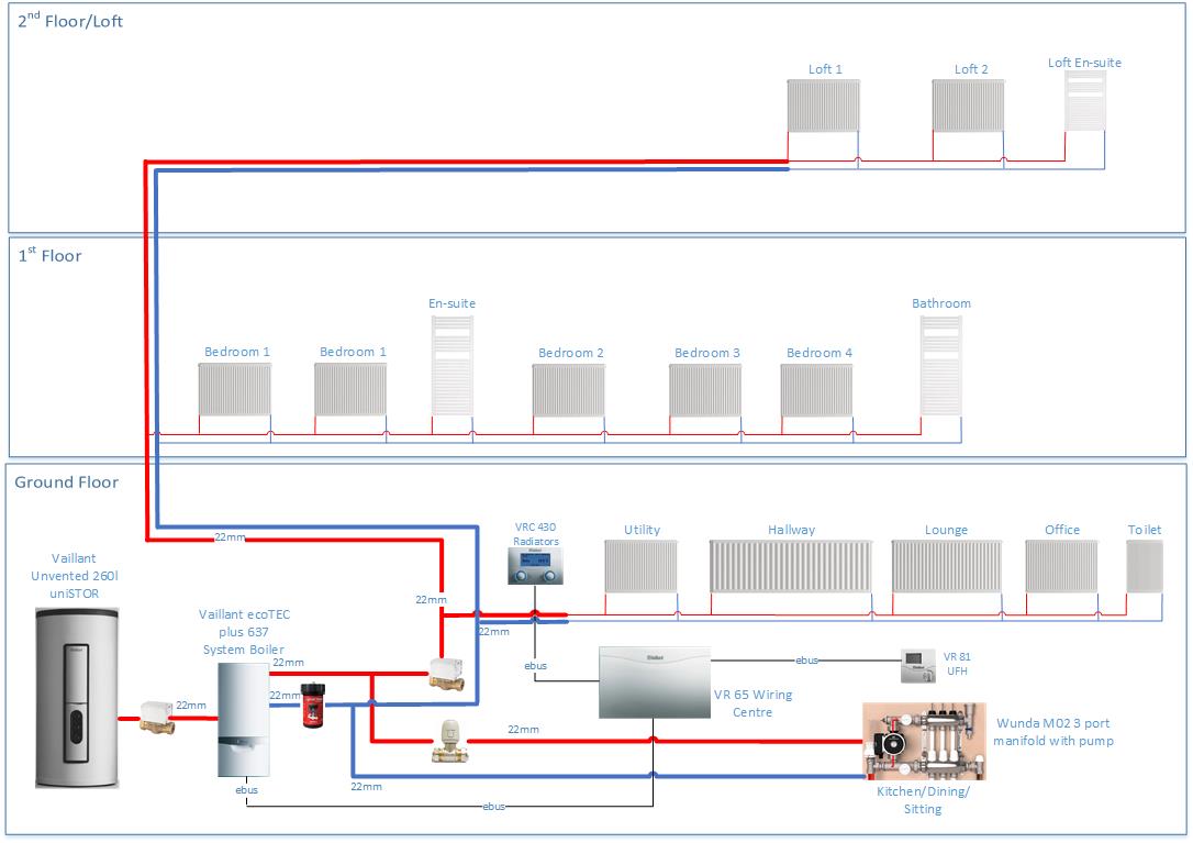

Here's the original posted diagram of my CH system (the original posted diagram seems to have disappeared). Notice the loft piping:

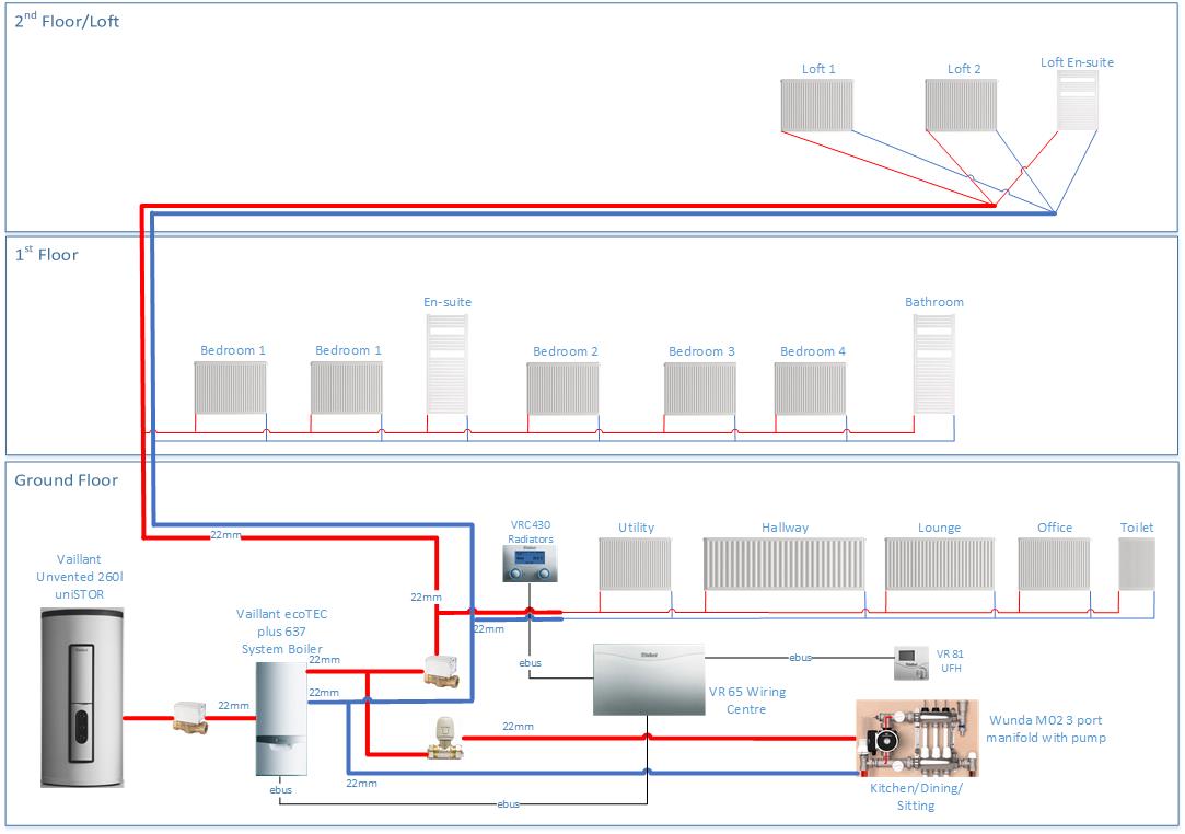

So, originally, I disconnected all the pipes in the loft from the supply and return (copper pipes from 1st floor to loft). I then flushed through one of the radiators and pipes and successfully cleared them. This radiator is now connected back up, so the current loft setup is shown as follows:
As you can see now, only ONE of the loft radiators is connected to the CH system and this radiator is working perfectly - it gets red hot. I'm now working on the towel rail, shown in the diagram as Loft En-suite, which is currently disconnected from the CH system, allowing me to work on the towel rail and connected pipes in isolation. Here's how I initially connected up the pipes for the towel rail to create a small isolated "circuit":

HI, sorry I'm obviously not explaining myself very well.

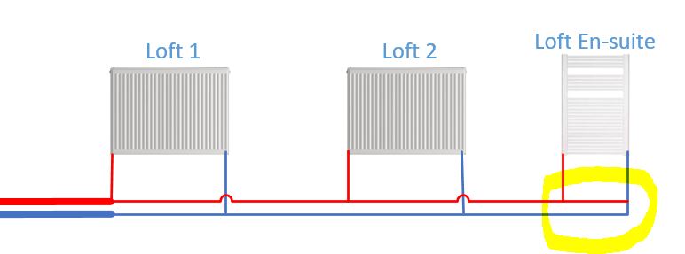

Regarding the original wiring of the loft radiators and towel rail, I'm wondering if the orientation of a T connector can make any difference to the flow of water. In particular on the return side, which seems to be the worst blocked pipes. Here's what I mean:
On the left is a diagram showing the orientation of the T connectors as they were. The return from the Loft en-suite towel rail and loft 1 radiator is potentially pushing against each other and causing a resistance. Same when that (reduced?) flow hits the flow from the loft 2 radiator prior to going down the copper pipe.
I wondered if changing the orientation of these two T connectors might help the return flow as shown in the diagram on the right. In the alternate diagram the flow from the loft en-suite towel rail has an "easy path" and I wonder if the flow from loft 1 would not give as much resistance. Same with the connector from Loft 2.

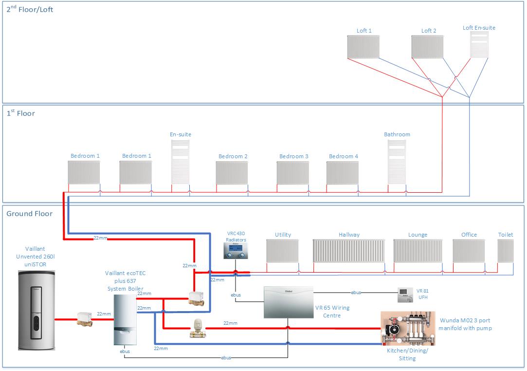

Last year I refurbished the house bathroom and installed wet underfloor heating. I needed to run a brand new flow and return to the bathroom, which is at the other end of the house to the boiler, so designed this to also provide a new flow and return for the loft. I ended up installing two new runs of 22mm pipe which provided the loop (supply and return) for the new bathroom underfloor heating manifold, but also for the loft radiators, by fitting a Honeywell 2 port valve, just after the UFH manifold supply. I also took the opportunity to modify the routing of the pipes in the loft so that it was no longer a "star", and they are now connected up in parallel i.e. one after the other. In addition to this, and at the advice of a heating engineer I use, I also had a Low Loss Header installed and an additional pump, both of which I'm sure would help with flow rates in my system.
So far, I haven't had any further issues with the loft radiators, but I also ensure their valves are always fully opened to keep water moving through them. In the Summer, when the CH isn't really being used, I tried to remember to turn it on every week or so. When I say turn it on, I mean increase the temperature of the thermostat so that there's a demand for heat and leave it like that for an hour.
My system is getting quite complicated and now looks like this:
Or am I talking rubbish?
