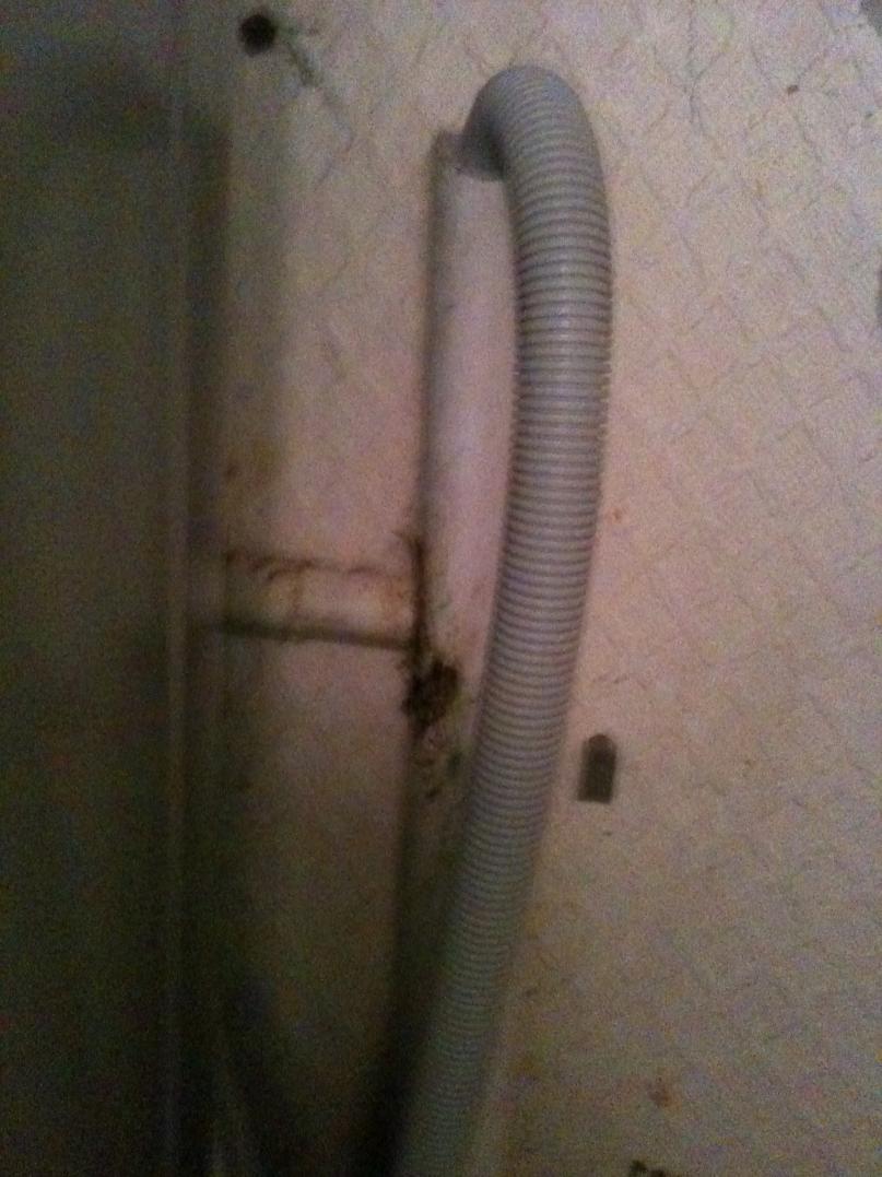

got a job coming up where one of the issues is the kitchen fitter connected a condensate pipe to a washing machine standpipe by drilling a 22mm hole and siliconing the condensate pipe from the combi into that...
Surprise surprise - it is now leaking.

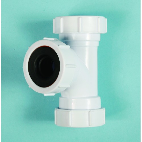

I would like to know if regs are happy with the idea of this, not the way it has been done here, just the general idea of running a condensate pipe into a standpipe via a tee. If so I would be trying to get hold of the below item.
I've looked at my usual plumbing suppliers and can't find one anywhere, will start ringing the independants if regs permit this.
Thanks in advance for any replies :)
Hi JC i put them into stand pipes, nothing wrong with that. You can buy a rubber seal that will fit your inch and half tee to take a overflow pipe.
I prefer the mc alpine clamp 1 gr ( grey) the white one 1wh isn't the same for me.... My initials are GR.
Yeah I saw the McAlpine clamp while browsing, that's got a solvent weld boss on if I remember correctly. Cheaper than the polypipe one I pictured too :)

Not acceptable unless the MI's specifically allow it.
The condensate pipe is classed as part of the flue.
i always see that as a debatable statement if its part of the flue who decided that overflow pipe was a suitable flue or that a soil stack thats tested to 3inches water is sound enough to use as a flue and is a durgo sound enough to be part of a flue system?
