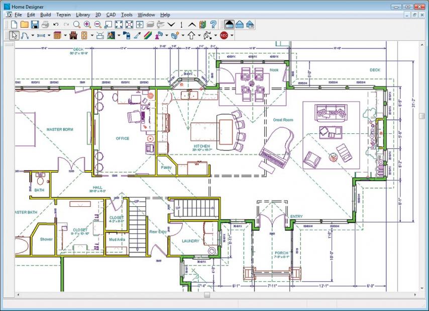

REVIEW:
Program Layout: with a basic but pleasant format it does not take a lot of time to be able to start drawing with this software and most tools can be found with ease.
Tools: you get all the tools needed to create basic floor plans, walls are easy to construct and you can even produce cavity walls. Doors and windows are just a simple click and click to insert. You also get a full set of basic cad drawing tools (including lines, rectangle, circle, arch, dimensions, and text input ) which are perfect for adding details and you can even change line weights which can be invaluable.
Features: the library of drawing symbols has most of the symbols you will need to get started, but the biggest advantage this software has over others is that you can create your own symbols and save them into the library for future use. This is an excellent feature, for example you can create your own BS symbols both plumbing and electrical save them and then all you do is drag and drop into position when needed. You can not save plans in standard cad file formats like dwg and dxf but that is no surprise and you can upgrade this feature I believe from the website. You can also import into your drawing picture files.
As with all home designer software this has a number of 3d tools to create 3d views of building, not that they effect floor plans much but they seem to be of a good standard but I have yet to fully learn how to use them.
Ease of Use: Once you have grasped the basics it becomes quite easy to use this software, especially if you have built up a good library of your own symbols. Floor plans can be produced at a decent rate and if you create some drawing layouts it very quick indeed.
Support : Included in the software is a built in manual, help tool, and online you can find video tutorials .
value for money: YES, for £6 how can you go wrong? The plans you can produce for this amount of money put some more expensive software to shame. There are a number of free software’s you can download but most don’t come close to the features this has.
Summary: It does almost everything you need and more and for a very small cost. Even a simpleton could produce a decent floor plan, I know.... I did. LOL . The biggest plus to this software over most others is the ability to create and save symbols, that alone makes it my BEST BUY.

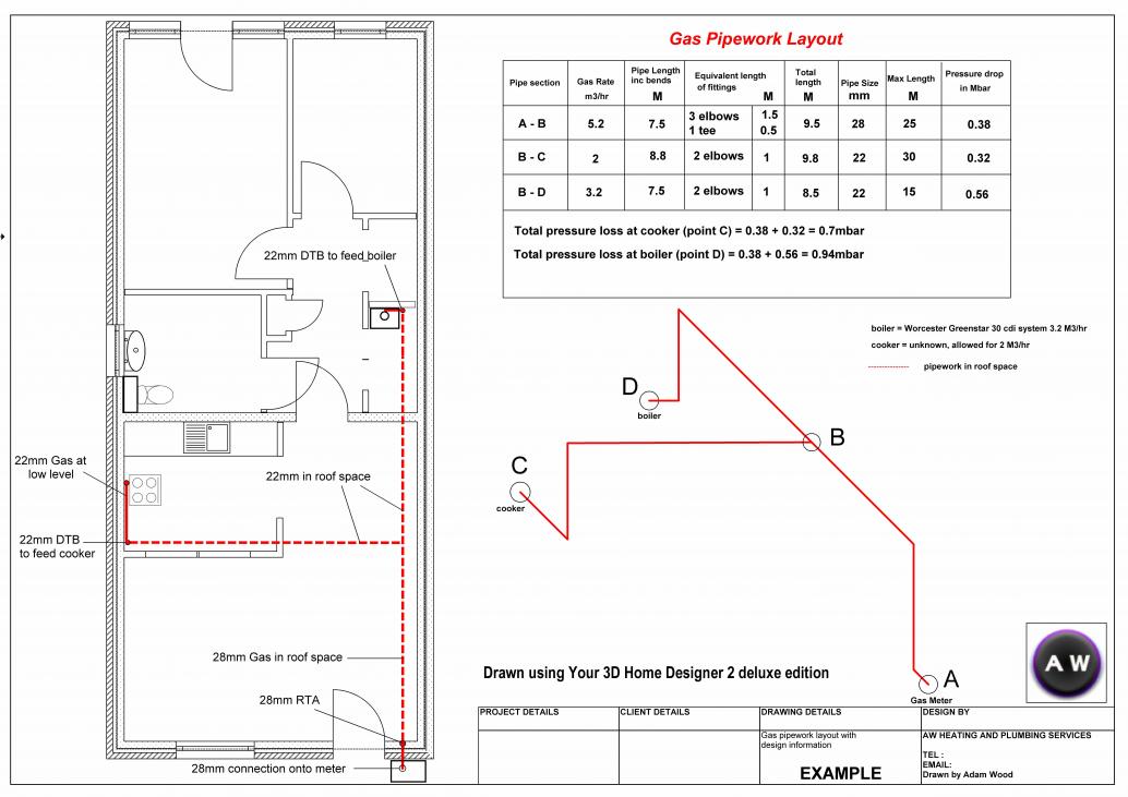

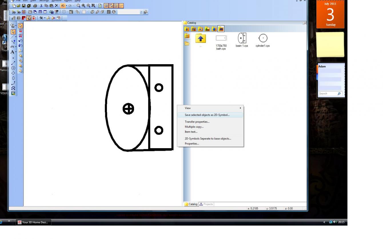

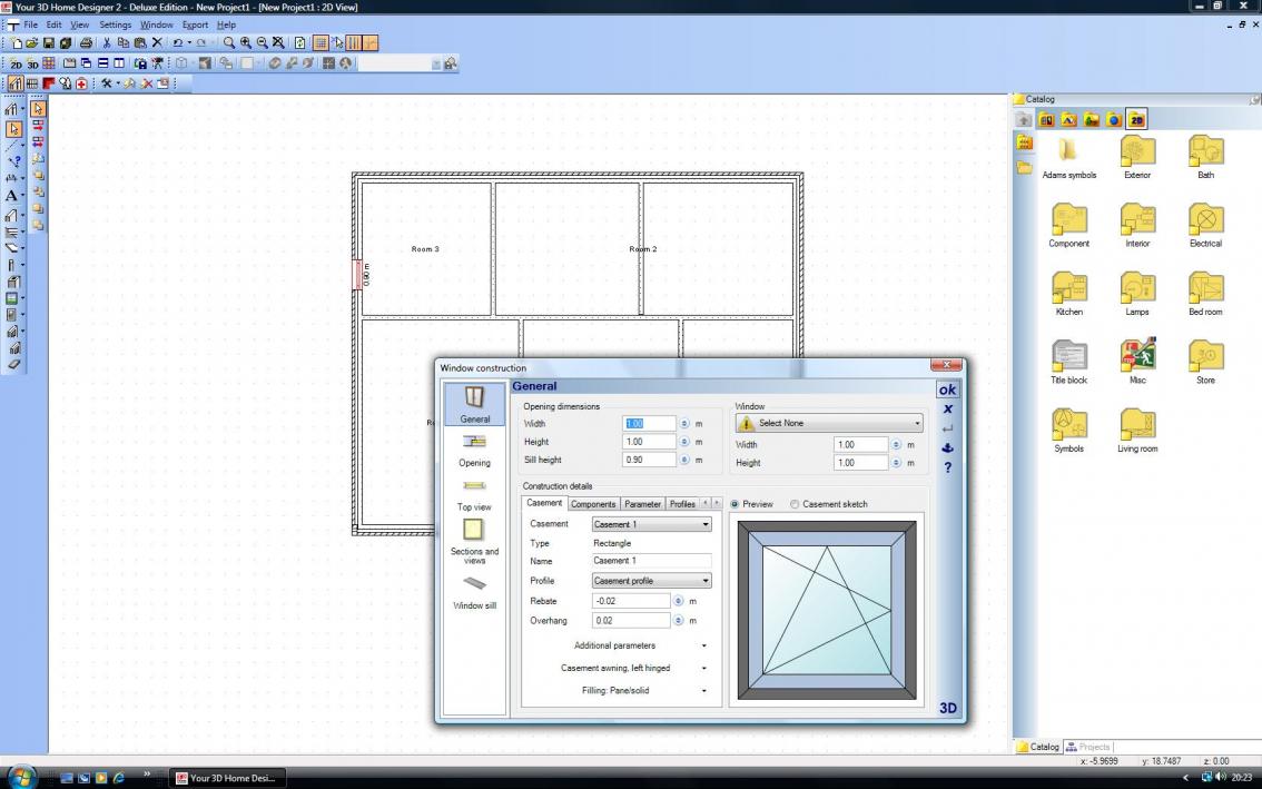

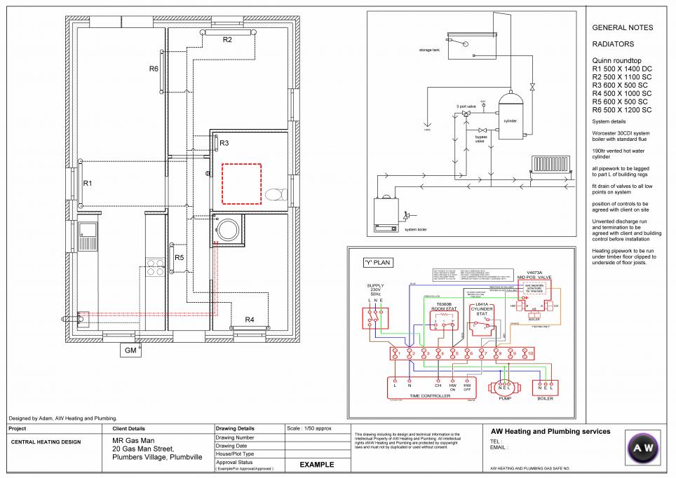

here are some example plans I have drawn up as well as screen shots.
Yours linford 1.jpgYOURS bath.jpgyour yplan.jpgYOURS3Dmaking symbols1.jpgYOUR3Dwalldesign.jpgYOUR3Dsymboldesign.jpgYOUR3Dwindowdesign.jpg

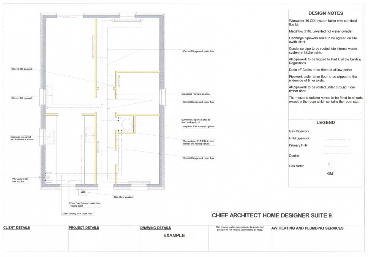

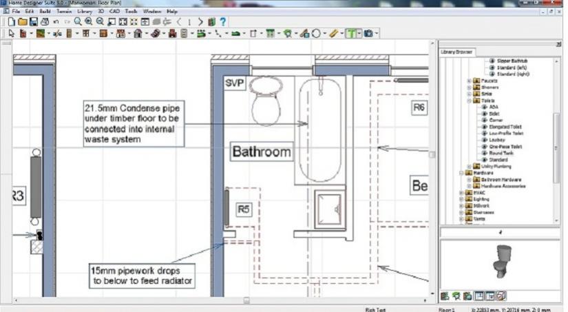

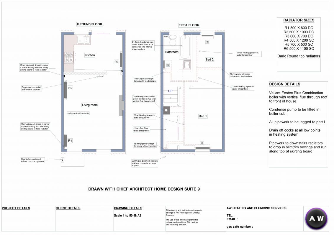

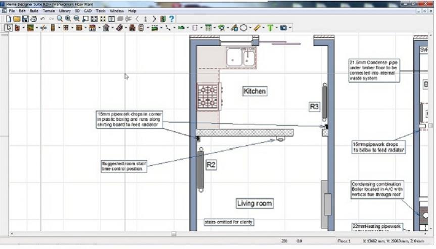

here are a few screen shots and example plans.
CA floorplan.jpgCA floorplan2.jpgCAbathroomlayout.jpgCAkitchen.jpgCAplan1.jpg

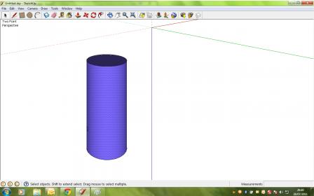

Google sketchup its free!
last time i used it which was a few years ago i found it very hard to use and currently i cant get it to work on my computer, keep getting an error on load up.
Have you used it? post your experiences please.

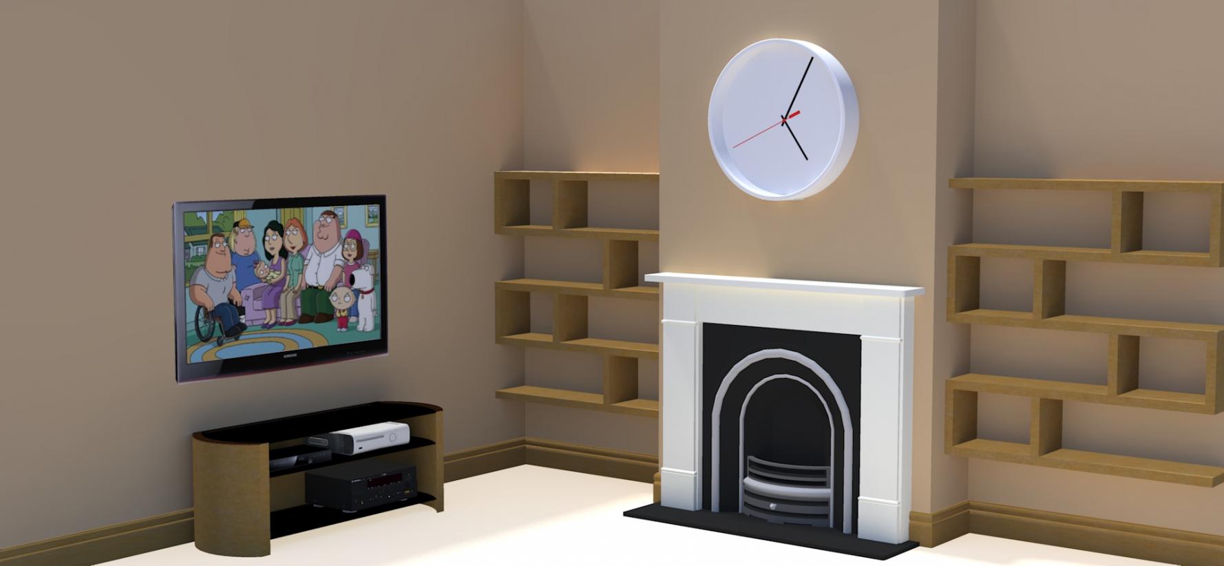

sketchup.jpg This is a 3d project I have been doing on google sketchup, only downloaded it the other day and just trying to get my head round it
Sketch up is a amazing bit of free kit, I've done all my house with it. Making my rooms and playing around with ideas etc.
Wow Tweakboy , that looks cool. i must say sketch up can produce some good stuff in the right hands.
