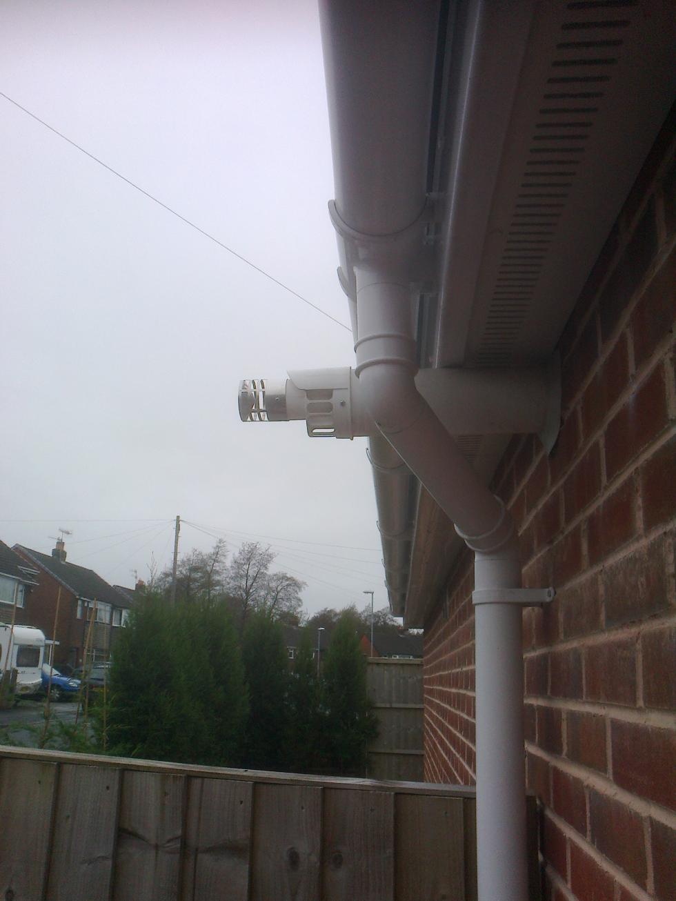

Was at a service today and noticed when checking the flue out side it terminated under the eaves ( in the corner of an L shape on the building so eaves on the building either side of it were above the flue). When working the poc's were going up and hitting off the vented eaves but not going in the vents, they appeared to waft from under and up onto the roof. Wasn't really sure about this as I thought it could be classed as poc's re-entering the building. Anyway got a second opinion and the gaffer was OK with it and said as long as the flue termination was within regulation distances it was fine.
Thoughts on this? His name last to it anyway but was he right?
