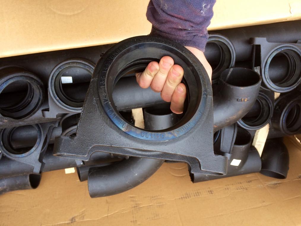

Just wanting some advice about a job I've got coming up.. I have two cast iron soil pipes to do on an old Tannery conversion. Basically I've temporally used 4" soil pipe to be able to pass an inspection now it's time for the real thing.. Obviously being an old building nothing is easy, if you look at the picture of the temporary soil you can see that the clips are packed of with copper; this won't be the case when using the cast iron, my question to you is how would you pack the clips of the wall for the best finish.. I'll put pictures of the cast clip fittings as well. Any advice or if you would do it another would be great. Thanks

wood painted black?
seen it done on a few old cast stacks
find a bit of wood the correct thickness use a holesaw. take the bit of wood out of the holesaw. dip it in paint. job done with a nice hole for the screw to go in.
Use ten or twelve mm studding hilti anchors or similar cut and slide copper tube over exposed studding paint black jobs a good un....regards Turnpin
I would stick with copper spacers my self and just paint them black have seen the holesaw thing befor and it looks the dogs bits once done but takes a bit longer I would use some scrap 22 or 28 the finished job looks as good to be honest!
having paid for cast iron rain water goods, most custards wont be very chuffed with painted bits of copper as stated buy some cast bobbins, bout £4 each but look the part
