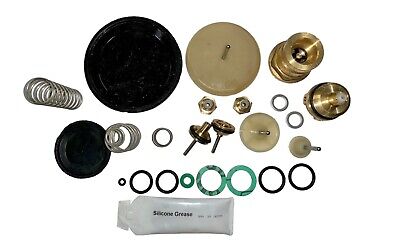

So replaced pump and both dhw and pump proving heating diagphrams.
The back pump proving pin still won't come out to make contact with the switch.
However if I make manual contact to switch burner fires up both on ch and hw.
Could it be a faulty diverter valve.
Also check the little 4-6mm pigs tail tube
