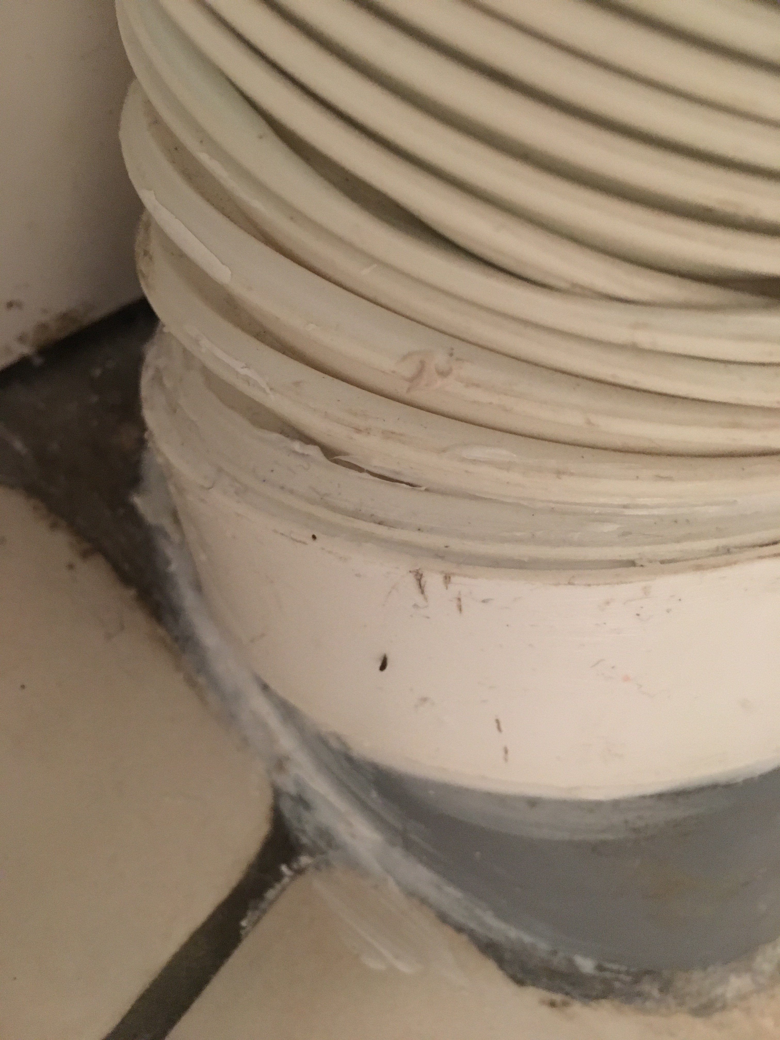

If you're suggesting that it's a faulty seal between the pipework and the WC pan, would that require a full change in piping? At the moment, I've stuck a bit of silicone around, but I'm not sure that it will really solve the problem. Pictures attached of behind the toilet.

Well that's as rough as bulls lugs. Prob a split in the flexi pan connector. The flex part doesn't look right
Be difficult to sort that pan connector out neatly and properly given angle of 110mm poking out from tiles and relative distances. So sticking a rag in the top of the overflow in the cistern and seeing if the smell stops would be a good first move.

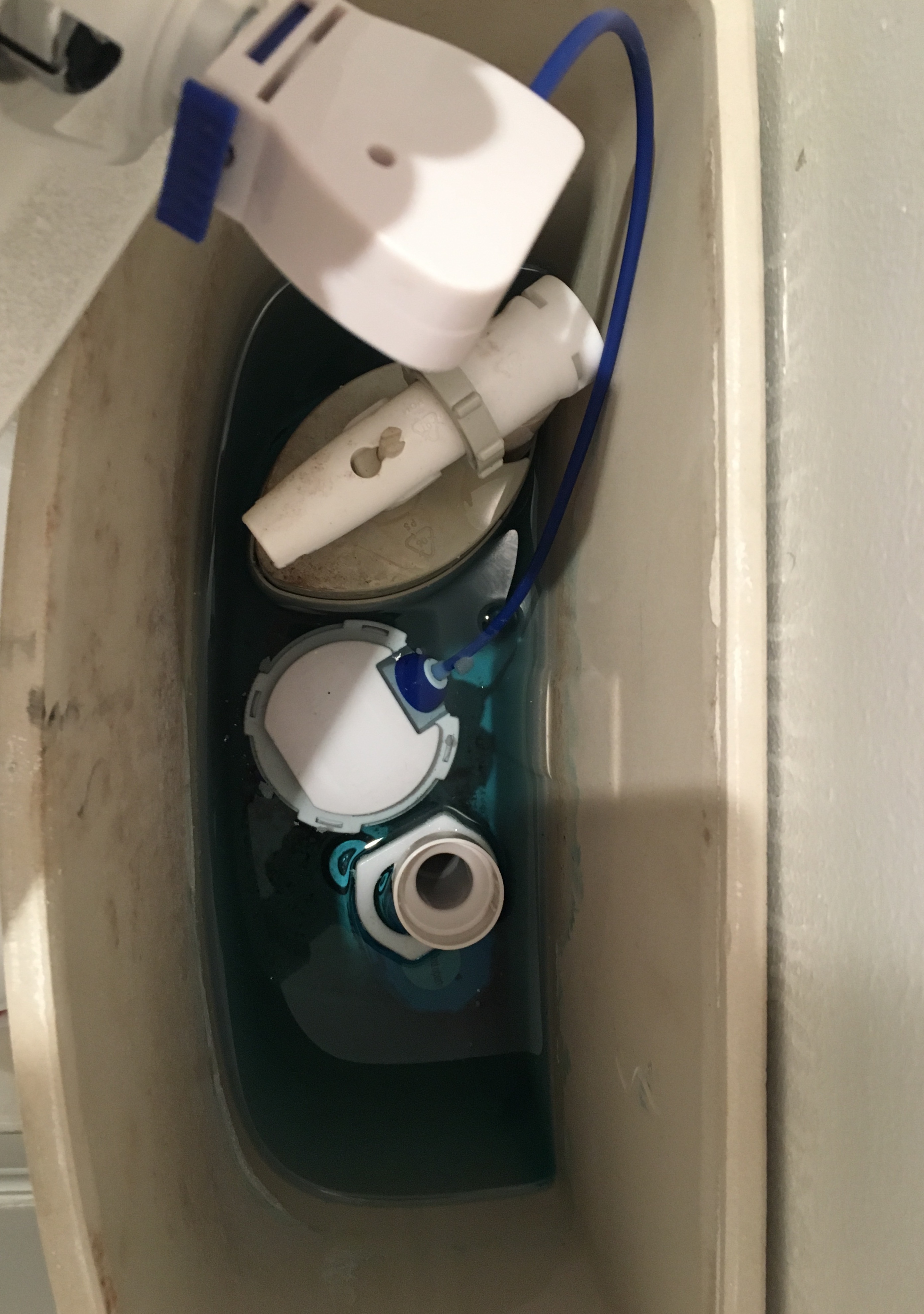

Okay right - I've blocked the overflow with a sandwich bag, wrapped it around and made it tight with an elastic band. Ill attach a picture of the cistern (before I covered the overflow). I can give any other pictures if they'd help! I'm not 100% certain that it's bossed into the stack, but it sure sounds like it is after I poured water down there.
Did you put the bag over the open pipe, lowermost component in your picture? If so, that's not going to be where the smell is coming from because that type of overflow sends water straight into the pan if the cistern fills too high. The guys were talking about an overflow pipe, usually in white plastic that would come out the side of the cistern, near the top edge and taken either to a stack, or more likely to outside in a position that will cause a nuisance (by design) if the cistern overflows.
You have an internal overflow there, unless there is another overflow pipe on the side of the cistern just out of shot.
You know what, it's all starting to add up now ;) when I initially poured water down there, I had to toilet lid shut, so I didn't see the water come down, although you are totally correct. I've taken the bag off now. There's no other overflow pipe. That begs the question whether it is indeed a faulty pan connection?
Yes, it's now pointing toward that. The concertina type pan flexi does look a bit crumpled and "off" to how it should look, it has a tight crease or fold in a couple of places and this could be concealing a split.
The only thing that puts a bit of doubt in my mind is I would expect you to have at least a small water escape on flushing but not necessarily so. Water can do strange things sometimes! I'd have a very gentle poke around the folds in the pan connector flexi. The only problem with that is if it is splitting, poking at it might make it worse but at least you'd know.
Another option that might show a leak is to spray some soapy water all over that flexi, pull the flush and look for any evidence of foam or bubbles which would show a split. There is very little pressure involved in the flush pipe on discharge but hopefully just enough to make a few bubbles upon flushing.
