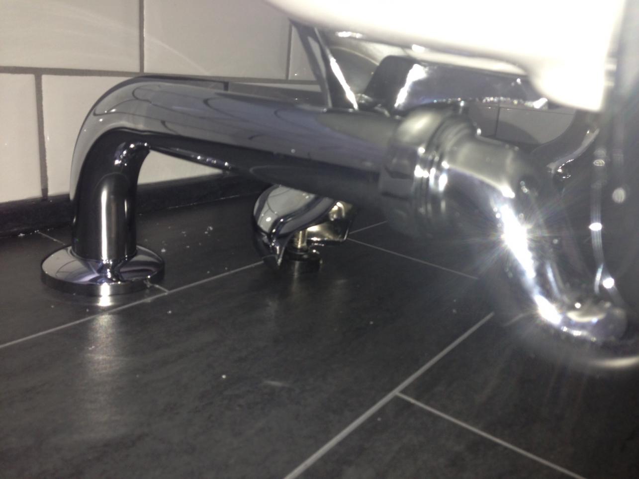

Thanks for that. The flooring seems to be plastic (not vinyl), would tile adhesive still work ?
Hi Mr. Wrench
What type of floor is it sitting on?
Tiles or vynil or vinyl (whats the correct spelling?)
The flooring is a kind of plastic material and definitely not vinyl (see pic).

so to summarise
customer laid floor (looks like a nice finish btw)
toilet was initially "wobbly" but shimmed, screwed and siliconed. So its a wooden floor

Thank you for all the posts. Although not flat, the floor under the pan is definitely not wobbly, so I guess the best solution is to bed the pan into sand/cement. Would a cement based tile adhesive do the same job ?
Additionally, should the cement base cover the whole area under the pan or just around the edge where the pan sits on the floor ?

some pans are terrible the fixing holes are too far back - I have shimmed before and used the white sticks like sh... silicon
I'm not sure about mixture ratios for cement, obviously the stronger it is the more difficult it is to remove if the need arises.
Cement dosent work very well if there is only a small amount inserted, old pans were set on a mound of it (pug, gobbo, muck) and the only way they were removed was with sledge hammer, but they were normally set on a concrete floor and the gobbo bonded to the floor hence it became difficult to remove without breaking pan.
However you have a "plastic" floor. I dont think cement will bond too well to vinyl so you will still need to plug and screw pan to floor to secure it after, the gobbo is just there to act as "packing", so it will need to be strong enough to not crumble (3 in 1 I think was said earlier) and have enough of it to remain located and act as a packer, how much that is is up to you.
Hmmmm, using rapid set "flexible" tile adhesive.... such as weber SPF rapid. Might be a better solution as long as you only use as little as you can, the width of the pan base edge (i.e. 25mm wide?) and a strip running the length of the area that does not meet the floor.
Mark out the pan edge, mix adhesive quite stiff, lay a strip (not too high) then bed the pan on the strip, screw down to set position, wipe away excessive adhesive to ensure that a bead of silicone will be able to be applied after, then let it set (3 hours) and silicone finish. Might be wise to use white adhesive if you are using white silicone.
I'm still curious why the customer laid the floor (so?) badly, when the final finish looks so good.
Hope this is of help without teaching you to suck eggs etc.
Russ
Thank you for the detailed response Russ.
I did all the first fix pipe work and then the customer laid the floor afterwards with absolutely no regard to making it level. There's also a shower in the room but this has a raised tray (due to waste pipe) so leveling was not an issue. Personally, I'd be happier using white SPF rapid than cement so I'll probably give that a go. I guess I'll have to use packers/shims as well in order to set the pan correctly and to stop it sinking into the adhesive.
