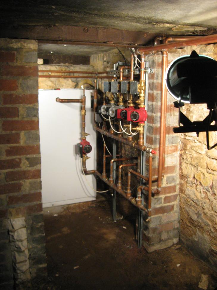

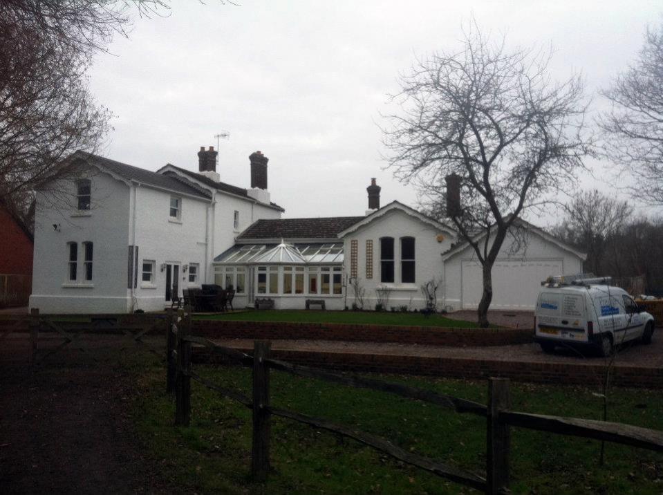

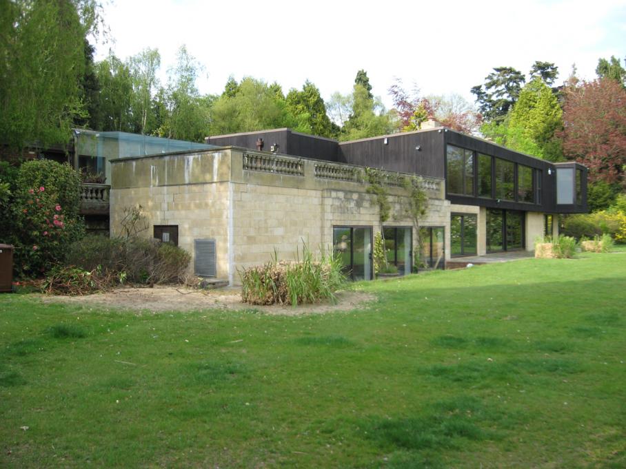

haha nice pic, where do people get theese figures from, with a larger house with system boilers i'd watch the expansion vessel, we normally fit heat only boilers for larger properties, that being one of the reasons.
See my pics for examples aswell.
