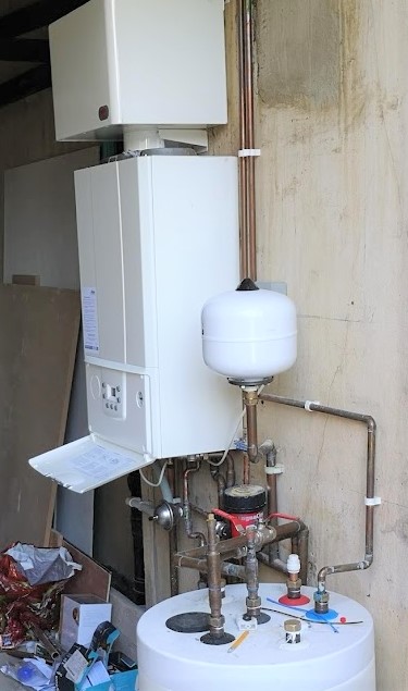

Ok so I've taken a picture of the PRV (attached), the pipe from the stopcock is definitely 22mm, not 15mm, my bad.
I couldn't get to the boiler today as the house is a building site at the moment and the garage (where the boiler is located) is all boarded up. That being said I could see the the pipes are all housed now, so I suspect the blending valve is fitted but I will check next week.
The boiler is rated to 5 bar, but I was thinking of testing the pressure at each of the taps using a gauge, before testing to see if there if is an increase in flow rate when going up in .5 increments (pressure) each time.

Conclusion..
We tested the garden tap and it was putting out >20 l/m, the plumber explained that it is the 12mm flexi pipes that came with the tap sets are restricting the flow a great deal. We tested some of the shower taps with and without the nozzles attached and we measured a difference of about 3-4 l/m (going up to 16 l/m).
That being said the plumbing of the boiler wasn't completely finished, with the blending valve being installed a couple of weeks back. The results are a bit odd. Most of the taps still output at 10-12 l/m, however, the bath taps output at near 20l/m with both taps fully open, the shower output is at 16/m which is certainly good enough for what we need.
I'm not sure why there is such variance but it's worked out for the best, I can only assume it's the type of connections used for each tap combined with the fact that the boiler is now a great deal more efficient now that the blending valve is in. We're still at 4 bar of standing pressure.
