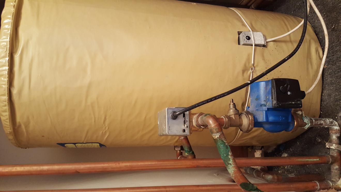

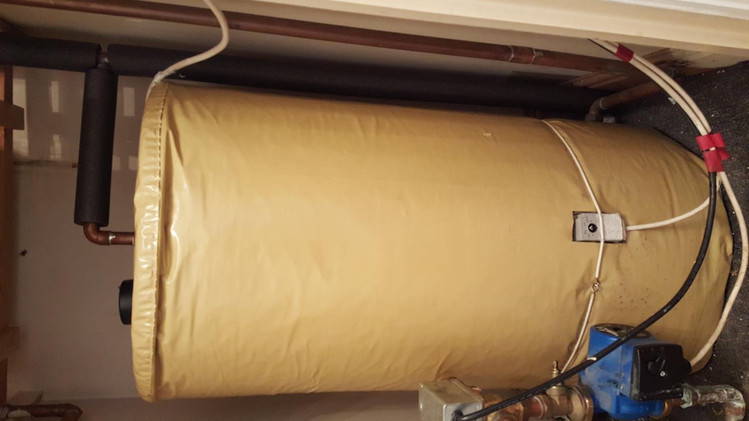

OK, update... I'm not 100% what the pipe is that's leaking at the bottom of the cylinder, and consequently not sure if it's the hot water system or the central heating.

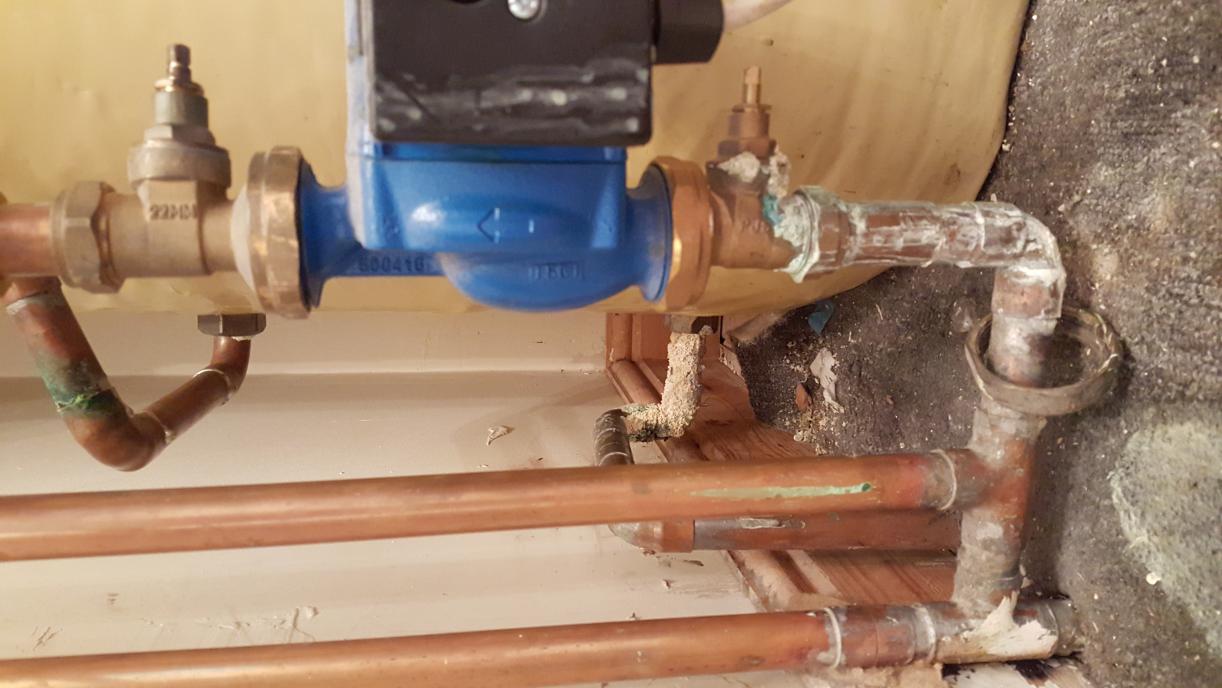

As you guys can see, the gate pump valve that Soul pointed out is shot - only leaking when heating up or cool. My only concern is the state of the pipe when i remove it as there's not much i can do if some needs cutting down if the compression collar has seized on, any tips?.... also I may struggle getting the valve out if the pump is too rigid.
And in the distance you can see the leaking pipe at the bottom of the cylinder - I think upon further inspection that this is a return for the coil in the cylinder and so on the central heating loop - would you still drain the hot water too before touching this?

unless your soldering or the pipe is full of paint you will be fine using nothing/cleaning on the pipe if its just comp joints
cheers Shaun, I'll give that a go first... the white is very crusty and the greeny/blue corrosion is very oily/sticky so assumed I'd have to use white spirit and wire wool etc...
I can't work out why there's splashes of this green stuff on top of the pipes though - baffled
its flux from where they dont wipe the joints you might need warm water yo take that off

I've had a right evening - drained down the system by removing a downstairs rad, then had to mock up a tap to one of the valves as it was leaking, using push fit, a stopcock and a spare piece of pipe.
Then attempted the gate valve on the pump, what a job! Couldn't get it off to start with then found myself removing the pump to get it out. The pump was so heavily gunked it was ridiculous! I then spent over an hour trying to free up the pumps channels whilst trying to make sure I left no sludge to later block my 10mm pipes. Anyway, the lower gate valve compression joint was too close to a collar so I couldn't get to the old olive and had to refit it with the old compression olive/nut (squeeky bum time), not least as it looked like someone else had attempted to remove it and bent the 22mm pipe out of shape - total gamble when refitting. Luckily I'd bought some jointing compound.... The lower seal was perished so obviously replaced that along with the valve, refilled the system and all is good in the world again! One question though, after bleeding the radiators, can I switch back on the hot water or do I need to bleed anywhere else in the system? I started the pump up briefly and it made a gurgle for a minute then started working, I stopped it however to post up here before going any further.
The other joint on the bottom of the cylinder I attacked with the wire brush, still not clean and full of white crusty stuff. I think I've found the leak though, on the 2nd 90, dry joint possibly due perhaps to the hard to reach location. That'll be a plumber job I think....unless I can cut the 22mm pipe 2 inch from the cylinder and mock up some 22mm push fit bends? Is this dooable?
Assuming after testing that the hot water works fine, tomorrow I'll drain it down again and fit the drain tap valve to one of the lower rads.

What do you think about the dry joint, is it worth attempting speed fit given the horrible access? My concern is the proximity to the boiler after reading not to use steed fit within 1m of a boiler. Also is there any detriment to undoing the bolt to the cylinder that holds that pipe in... I could do with removing that pipe to clean before sliding any speed fit on
This is the joint. I assume it's a standard 22mm compression which will probably need a new piece of copper 22mm. I may buy one of those and a couple of 90 speed fits to hit the pipe disappearing into the floor. Can anyone see an issue with this
A plumber with a pipe freezer and a tool like a Fein should have that replaced within an hour or two at most. Slice the pipe once frozen on both sides of the coil, drain water out between ice plugs and solder a nice bit of new copper onto a mew cylinder connector to boot. No pipe freezer and add another hour onto that for faffing about draining and filling the system to do the job.
