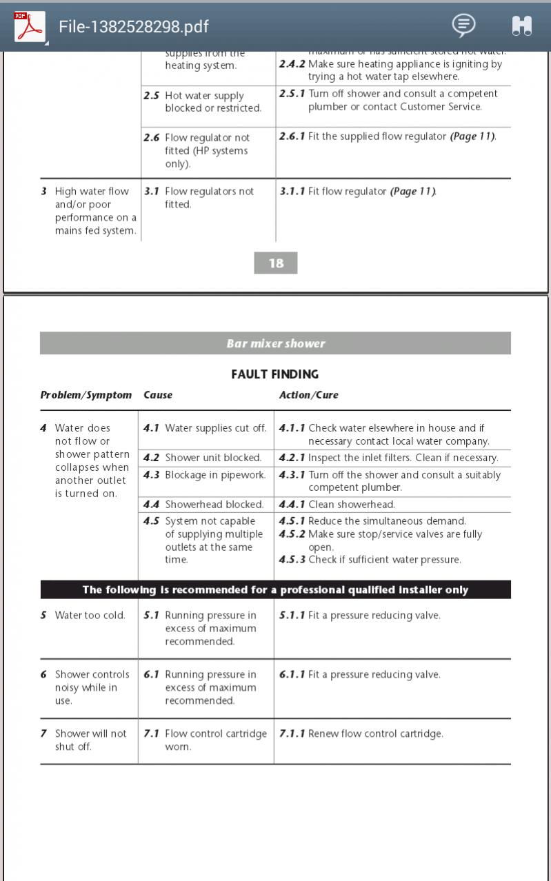

The repair is the place to start I would say the non return valve in the cartridge is stuck which is allowing water to pass when the shower valve is switched off and the hot tap is turned on
These may help
