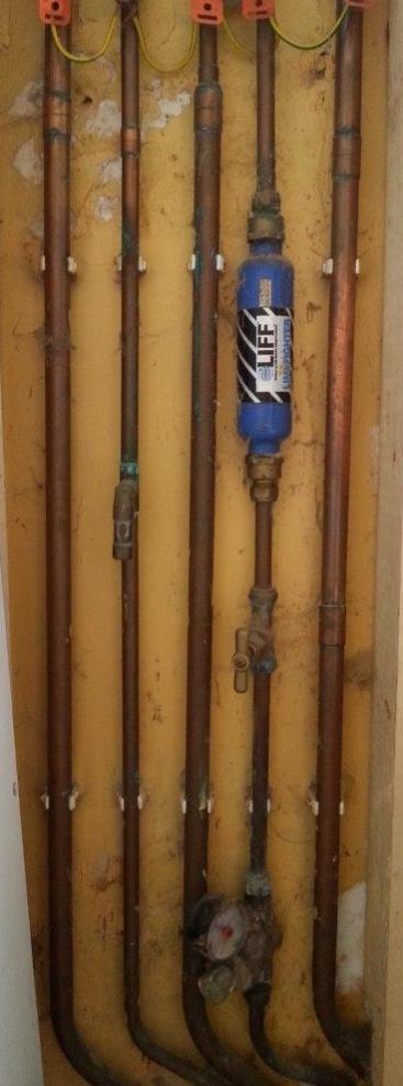

One final thing. I'm wondering if the cold supply into the boiler is still restricted in some way, resulting in a lower than expected hot water flow. Below is a photo of the pipes, there are two devices and a tap attached to cold supply, each of which looks old and worn. Is it worth me trying to replace them or can I just swap this whole length out for a straight piece of copper?
Should the tap be fully open or half way?

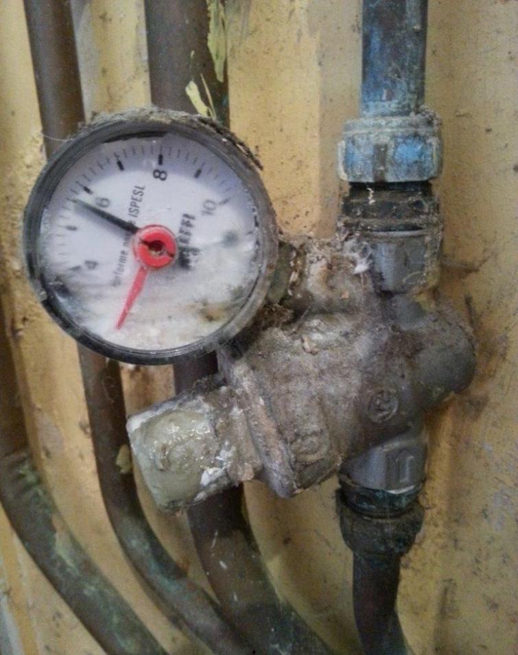

What does the 'dial' at the bottom do and should I be checking it?
Thanks again!
Just looking at the poor condition of fittings , bottom one with is a pressure reducing valve, to boiler, next is a stopcock that could be faulty , next is a blue anti scale cartridge that could be blocked, and as your in a hard water area Proberly find that the plate heat exchanger is also scaled any one of these will restrict flow through boiler
Whilst it's been covered flexicoms turn off the water to the taps when you're filling the heating side. I'd suggest your valve is stuck minutely open and the grey plastic tap head is slipping
