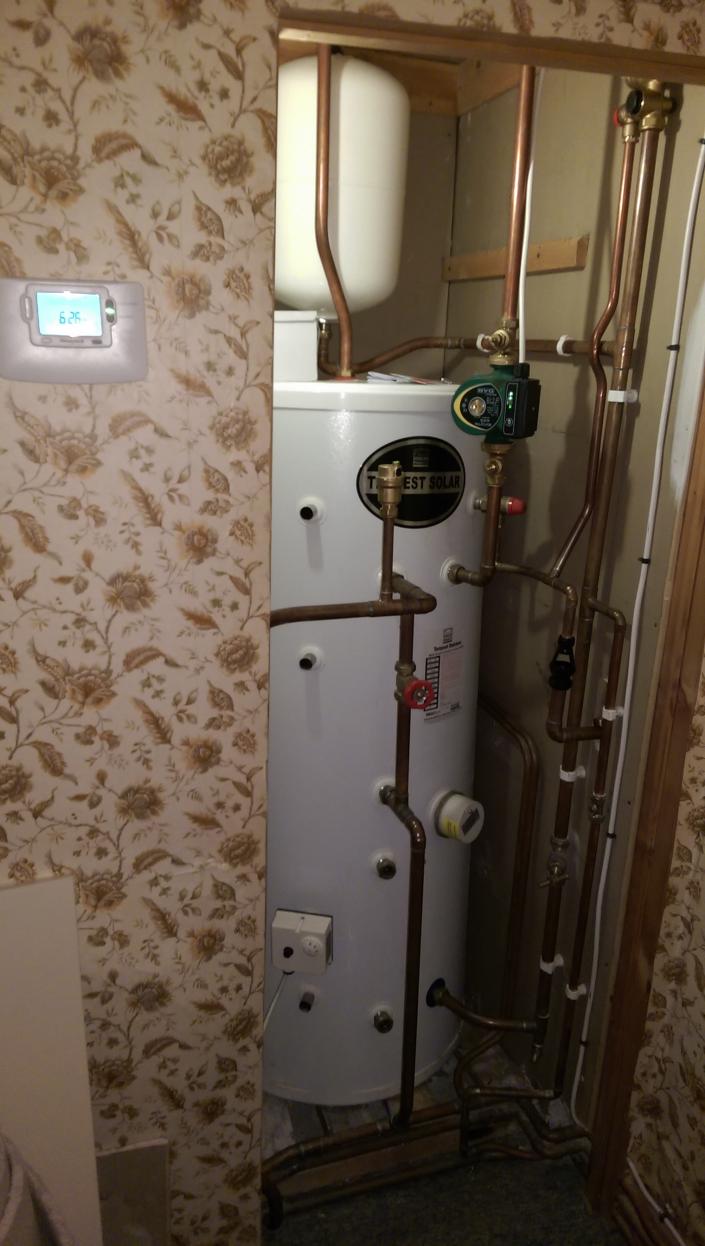

Whilst the work all seems to have been completed tidily, they have a few niggles with the installation, they have had the plumbers back this week, but no resolution since initial installation 3 weeks ago. I want to ensure that it's a case of genuine error/problem with the system, rather than poor workmanship, I have attached a picture of the pipework around the tank and was hoping with the commentary below someone may be able to offer their thoughts - I notice they haven't completed their details on the tank and haven't heard anything regarding a notification to Building Control, which is what raised my concerns initially, but they are Worcester approved installers with relevant qualifications.

  • I believe there is supposed to be a 300mm drop before a turn below the Tundish, which isn't the case, is this likely to be a problem, what are the implications?

1. Tundish pipework not to regs. Are the installers g3 registered?
2. Wheres the insulation?
3. Have the installers oftec or some other competent person scheme registration? And has the installation been notified to local building control.
4. How bigs the house? Secondary returns are expensive to run, especially notbinsulated, and probably not required.
ps welcome to the forum.

1) Is it just the distance to the first bend and what is the impact of this? I'm not sure regarding G3 registration.
2) There was none!
3) I know they're OFTEC registered, not sure if it has been notified, would they receive paperwork to confirm this.
4) 4 bedroom, but just my parents living there now.

If they have made a mistake with something as simple as the tundish, on view, I would hate to think what you cant see. Also it wont allow the water to run away correctly. How long does the discharge pipe from the tundish run and how many bends, approx. This is basic stuff on an unvented install and does my nuts in when people dont even read the instructions.
4 bed house, I would really not expect a secondary return.
no, the copper pipes in the cylinder cupboard dont look 3 weeks old, not to me anyway.
You should receive two certificates from your local council. One for cylinder install and one for boiler install. These go with your house documents, because if its ever sold then the purchasing solicitor will want to see them.

Giving the benefit of the doubt I thought they may have used an existing pipe which went out through the wall rather than make a mess drilling a new one and that the 300mm had no real impact - it's an old house and the walls are 4ft thick!

Thats a little harsh, i wouldn't quite say its rough. The pipework has been clipped and adequately supported, its fairly neat, the joints have been wiped clean. The only misdemeanor i can see is that D2 MAYBE longer than 600mm.

I have just spotted something.
Has the cold feed got a stopcock on it?
Surely that's going to shut the expansion vessel off from the unit?
Or am I wrong?
Had another look and that is definitely wrong. Only thing you can put on the cold feed between the combination valve and unit is a draincock. No valve is permissible on the pipe and you are not supposed to do any other supplies also from that pipe.
Clearly the installers don't really know what they are doing and might not be G3. Combination valve is fitted above the unit, which is correct, but that one is far too high which is pointless and will make servicing it awkward. Work looks neat though, just a pity they haven't read the MIs before doing any work. It is stated very clearly in the instructions the basic regs.
