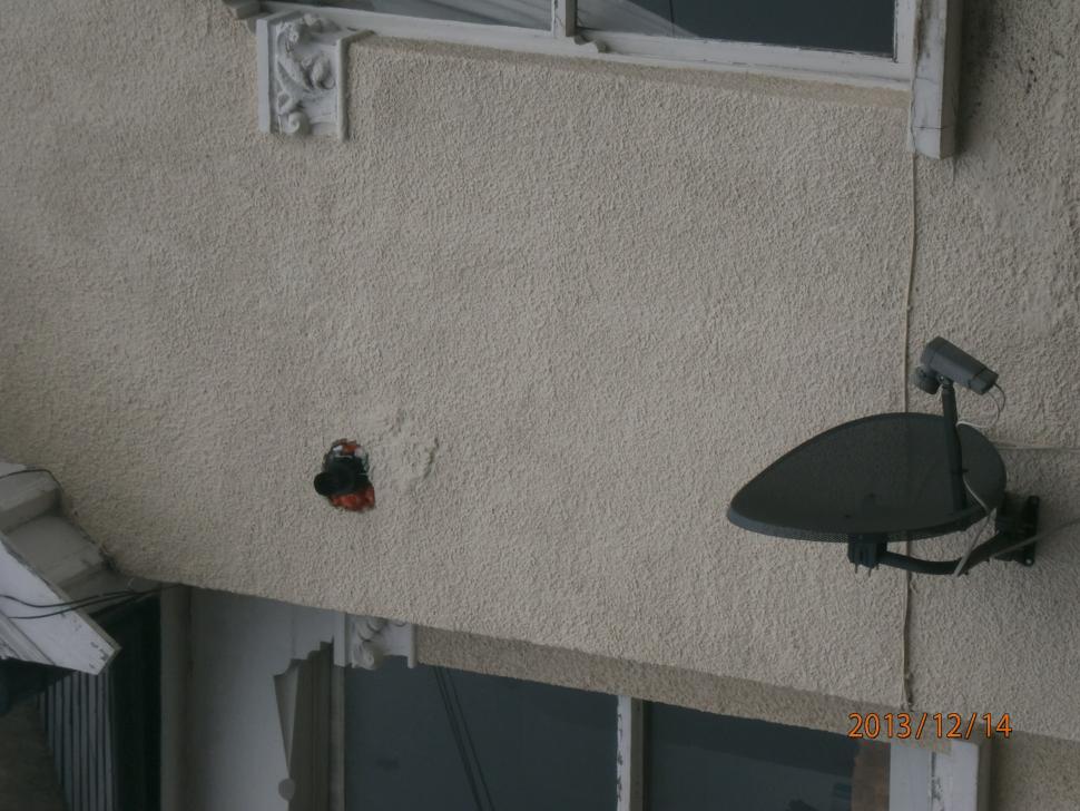

FROm the outside of house there are PLASTIC bags stuffed around the nose cone of the Flue ,the part with air vents is not visible., as to short.

THERE are Plastic bags stuffed around the FLUE, on outside of house,the end of flue where vents are is not visible as too short.
BENCHMARK was Completed and LANDLORDS SAFETY CERT given. to me.
Even though the flue is SHORT cannot reach outside brickwork
If the Magnacleans fitted you won't be getting much debris or sludge into the heat exchanger. Get them back Monday and talk to them face to face. They could have lost the inhibitor bottle and just emptied one as you were so insistent.
DO NOT USE YOUR BOILER until the flue is sorted.

Please explain; I have plastic bags STUFFED AROUND THE FLUE on exterior wall of flue end!.
The airvents of FLUE are NOT visible.
I have posted pic of Flue from outside house + = stuffed with plastic bags- Landlords Safety cert WAS issued on Friday!
I am based in Croydon and will be happy to attend. If the information you're giving is correct, then as croppie mentioned, your boiler warranty counts for nothing. Besides, your boiler will not operate satisfactorily if air intake from flue terminal is restricted. As for the inhibitor, if you're so concerned system is not treated, just dose system with inhibitor. To be honest with you, I strongly believe this whole story doesn't add up. Just my view.
hi pic of flue outside house, the boiler is inline with window to left ,
so theflue comes out much further and needs extension because of recess.
There is other pic at end of post ty

Hi, i appreciate that thank you, All info is totally correct,Pic is below. I do realise my warranty is nul n void, same as Landlord Certificate issued,.
